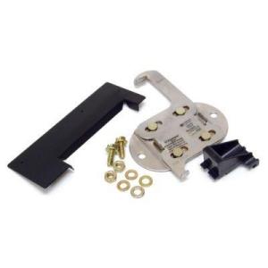

Okay...so this area is outside of my "comfort zone" but not really out of my skill level.
I have a question regarding the "transfer switches" and lockouts etc. If I want to install/have installed a whole-home generator and I happen to already have a brand new unused 2nd entire 200A breaker box, could I use the breaker box as the "transfer switch" somehow?
I understand I will need to lockout the utility line when I power up the house, but I'm trying to come up with a fiscally responsible solution using stuff I already have.

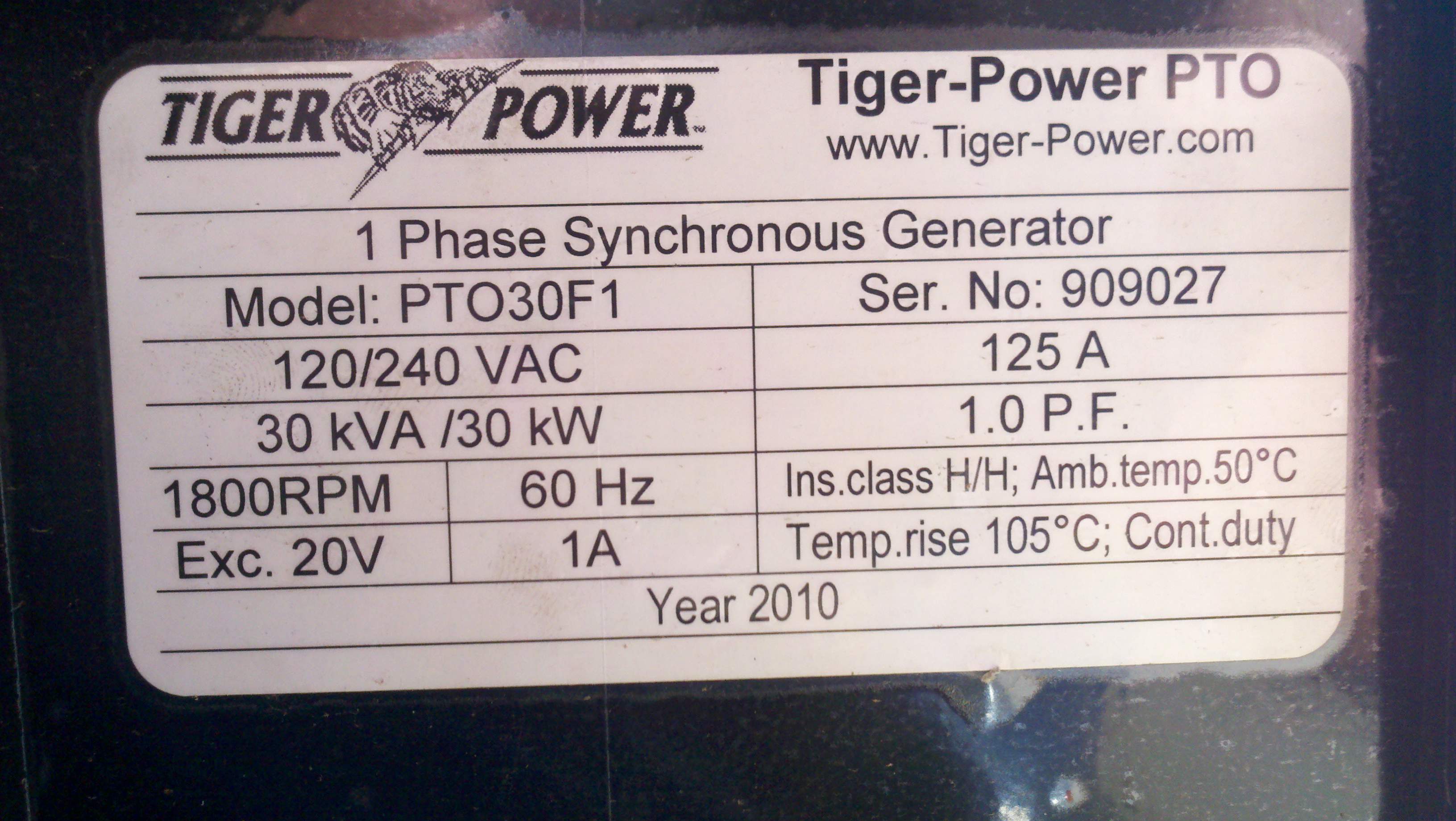

I see that 'tiger power' meter is labeled 'kw'. Does anyone know if it is truly kw. It is most likely showing kva.

If you look over the choices.... a 2nd panel really does not help anywhere. New construction? or existing construction?
It really depends on the size of the generator. A lot of the large generators will come with a automatic transfer switch. If you are doing the generator yourself, then a interlock might work for you. Manually shutting off your main breaker, moving slide lock, turning on your generator circuit breaker, firing up your generator.
Howdy,
The Tiger Power generator is listed as power factor 1.0. So it would be 30,000watts=30kw=30kva with a ample 90kva surge rating

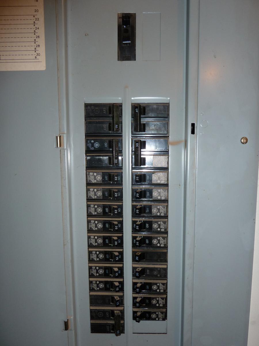

   / Generator Transfer switch connection choices #78
Even though my service has the 200amp Generac transfer switch. When the main breaker failed in the FPE house panel. I installed a new Square D with more breaker spaces and a built in transfer switch.
Now if the little generator is in use the wife and kids can't trip it because they can't seem to open the electric water heater, electric stove, shop electric heat, house electric heat etc.
18 breaker spaces on the generator side of the panel. Used some 1/2 sized breakers on low demand individual loads such as the doorbell, smoke detectors and some lighting circuits.
