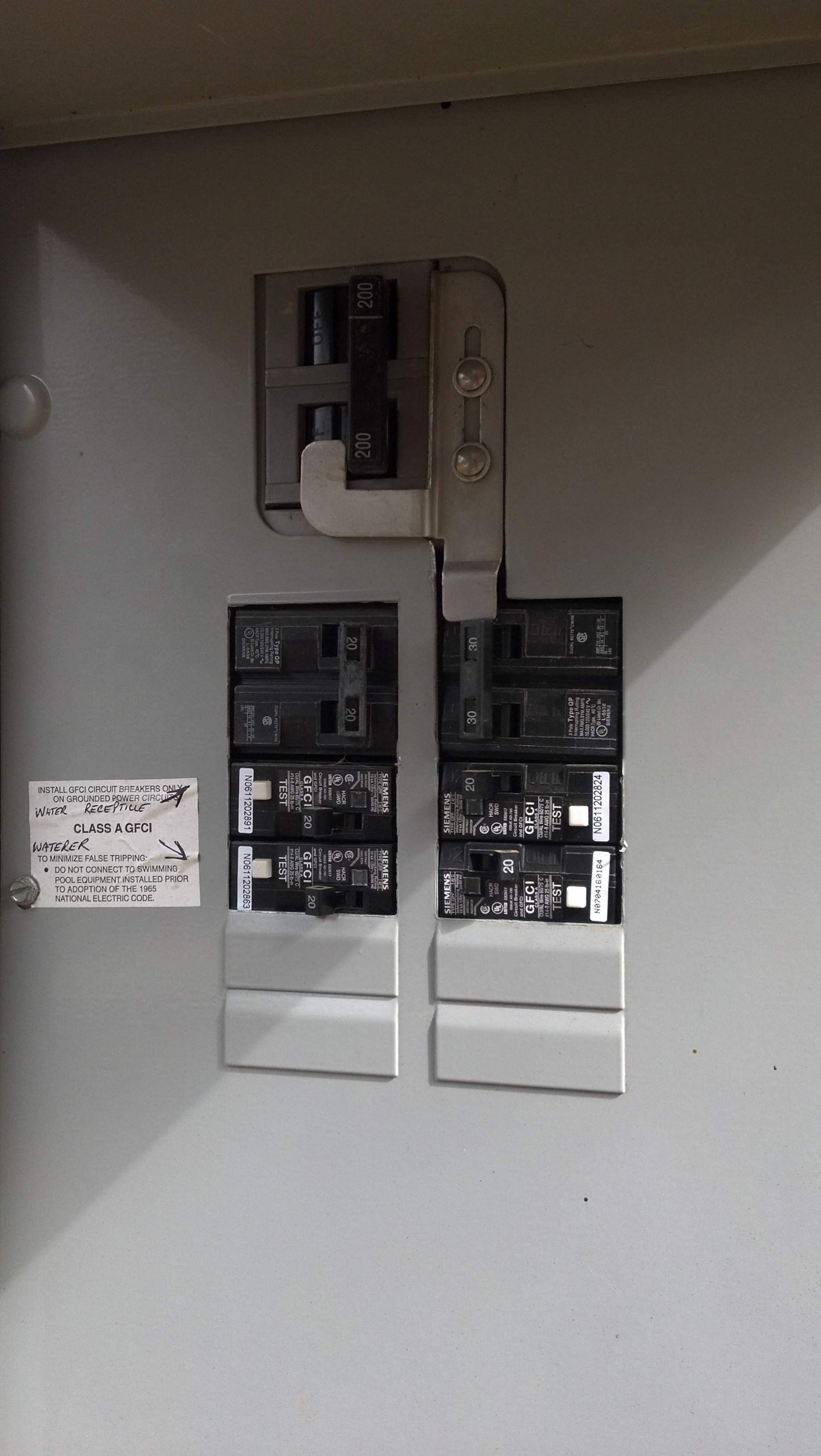

I'm in the process of implementing an interlock setup. It wasn't until I stumbled across this solution that I could figure out how to provide emergency power to all my buildings. I have a main service panel that's outside -it's a manufactured home- that feeds the house (manufactured home), pump house and shed. Best I could tell there was no way a transfer box was going to be able to handle all of this: the house is 100amp; no way to break that out into individual circuits on the front side. I've now since had a garage built and it's pulling power from this same service panel, which means that it too can be supplied with emergency power; initially I was going to go with a new service feed, but due to technical issues and cost I opted to serve it via a sub-panel; this now allows me to locate my freezers to this building.
Not automatic, but I'll have my bases covered. Don't consume a lot of electricity. I figured that a 7.5kW generator would suffice: picked up an old Onan with a Kubota diesel; only 650 hrs.
Anyway, I thought it would be good to provide a case in which a transfer box couldn't cover what was needed. And for me, I was once cursing this stupid, manufactured home, electrical arrangement, but am now actually feeling that it turned out to be a blessing (with the "advent" of the interlock solution).
NOTE: My local utility company recognizes, and approves of interlocks. Same with my electrician: I'm having him do the wiring (I take care of all non-critical outbuilding wiring).

1. With the switch there is no physical way I can electrocute a lineman with feedback from the unit down the input power line.
There is, but one would have to do some really stupid stuff to do so.
I've read anti-interlock folks stressing that one can open up the box, the face plate, and flip breakers. Clearly this is true, but this would be intentional, and actions of such are pretty hard to defeat. The point is that under normal operations (not the case of malice) feedback cannot occur. Also note that in most cases, not saying ALL, someone's little generator ain't going to be filling power lines up (and linemen's protocol is to always test for live voltages- yes, someone could come along and flip something, but in most cases the window in which this would have an effect is small; line segments tend to be isolated during repair- today's protocols are a lot more safe).

And those deadfront mounted interlocks mert both nec and ul ratings, so all is good

Interlock = The interlock is made to stay in place whether the front panel is on or off. It is just more than a slide piece of metal. The manufacturer has the entire panel and interlock device submitted for UL certification. That is why I have said it makes it easier if you have a main line (larger main stream company) service panel. I do know Square D, GE, Cutler-Hammer, Milbank, Challenger, Murray, Siemens have approved interlocks.
If you have a older service panel, or smaller service, and are upgrading. It might be easier to buy a new service panel, and interlock kit, and go from there.
