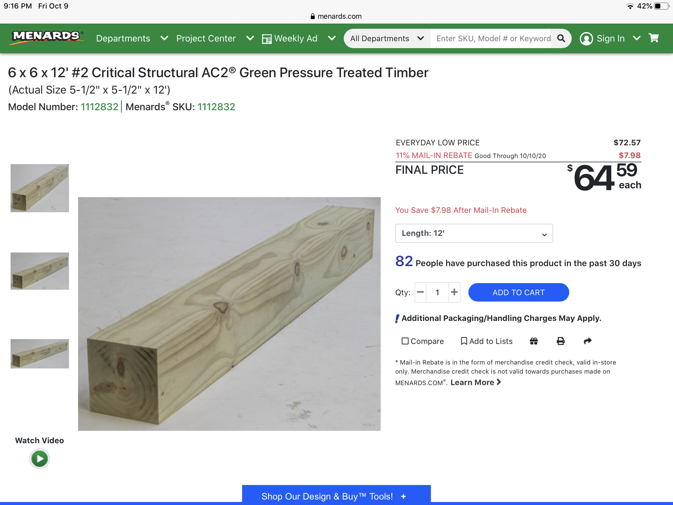

I was going to build a carport type shed for storing stuff out of the rain and snow until I saw the prices on posts and lumber.
By buddy and I are looking at buying a portable bandsaw mill.
