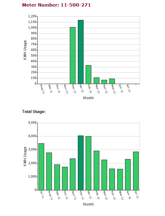

I just checked ours. This is from sunny N. Calif, about an hour east of Sacramento in the foothills. Today was sunny and clear; we generated 29.82kWh. 7/27-8/25 we generated 916kWh from our 5kW system.
After one month of operating my solar system, which I sincerely thank all of you for subsidizing :laughing:, it has generated 439.1 AC kWh's. The model predicts 383 AC kwh's for August. I had one week of operation in July, but July is modeled for 341 AC kWh's, less than August.
