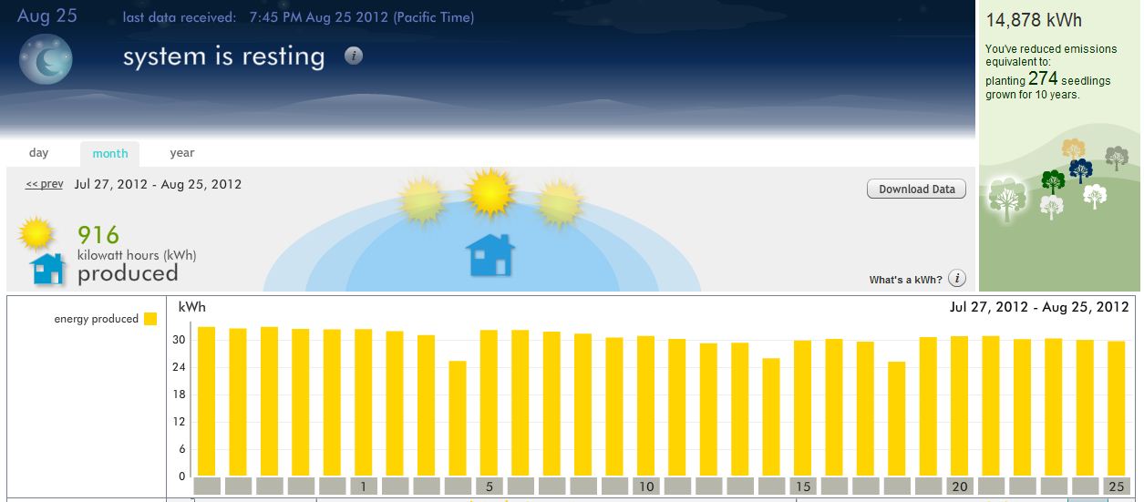

I just checked ours. This is from sunny N. Calif, about an hour east of Sacramento in the foothills. Today was sunny and clear; we generated 29.82kWh. 7/27-8/25 we generated 916kWh from our 5kW system.
That's pretty good. I have had several 20 kw days recently. As the sun angle declines, I am getting higher point-in-time readings. I have seen it hit 3400 watts around mid-day. We had 3-4 days of very overcast rainy weather before this clear spell, had a couple 2-3 kw days in that stretch.
My usage over the past 12 months with the propane fired water heater was 3,992 kWh, 333 kWh/month average. I have no idea yet how much the electric water heater will add over a year's time, I thought it could as much as double our usage based on estimates. I need to accumulate several complete months with the net meters and system output to find my net monthly usage. I think it roughly would be: (In from utility + system output - Out to utility)
Our 4.32 kWh system is rated by the PVwatts calculator at 4,447 kWh annually.
62KWh here yesterday, but there was a slight haze in the air.... 1750 for the month.
