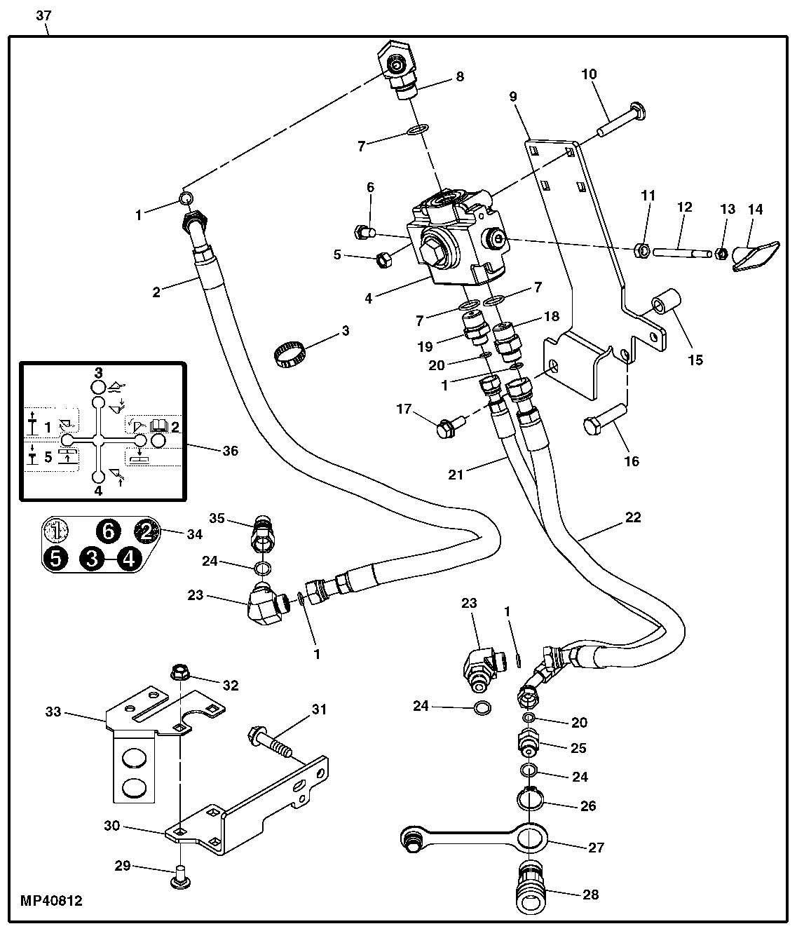

He is not talking about adding another valve, he is talking about splitting the stock SCV outputs to 2 sets of couplers and using a director valve to decide which set of couplers gets the pressure when the stock valve is actuated.
OP, it will work just fine. Deere actually makes a loader/mower diverter valve (LVB25822) so you can have the MMM and loader on @ the same time without disconnecting one or the other. 2 of those and you have what you want.
Glad you understand I'm talking about diverting flow only. :)
The LVB25822 is not quite what I want. It is mechanical. It uses and alters the front side of the mid quick connect couplers. I dont think there is room for two. It does not add rear remotes.

Hi all hydraulic experts. I've searched and not found a direct match to my idea to split the SCV hard lines. My thought is to remove/somehow use/replumb the factory JD 2320 SCV hard lines through electronic diverter vales so that you end up with both mid and rear remotes that utilize a toggle switch to simply switch between mid/rear remote activation, all factory joystick controlled of course?
Is this possible to achieve?
Yes, very possible-except for the very limited real-estate available on your 2305, and the steel hardlines going from the SCV to the QD's.
Your best bet is to add a new valve-probably on the ROPS just above the fender and feed it with the PB lines that would feed a backhoe. Simulat to these:

Thanks Kenny. Those are great links and great detailed valve installations from members. I of course was hoping you might get involved in this thread and say yes it can be done easy just the way you want... Oh well. If a new valve will make me much happier, guess I will take your sage advice. I have some questions on the PB. I think I'll start a separate direct thread on this.
