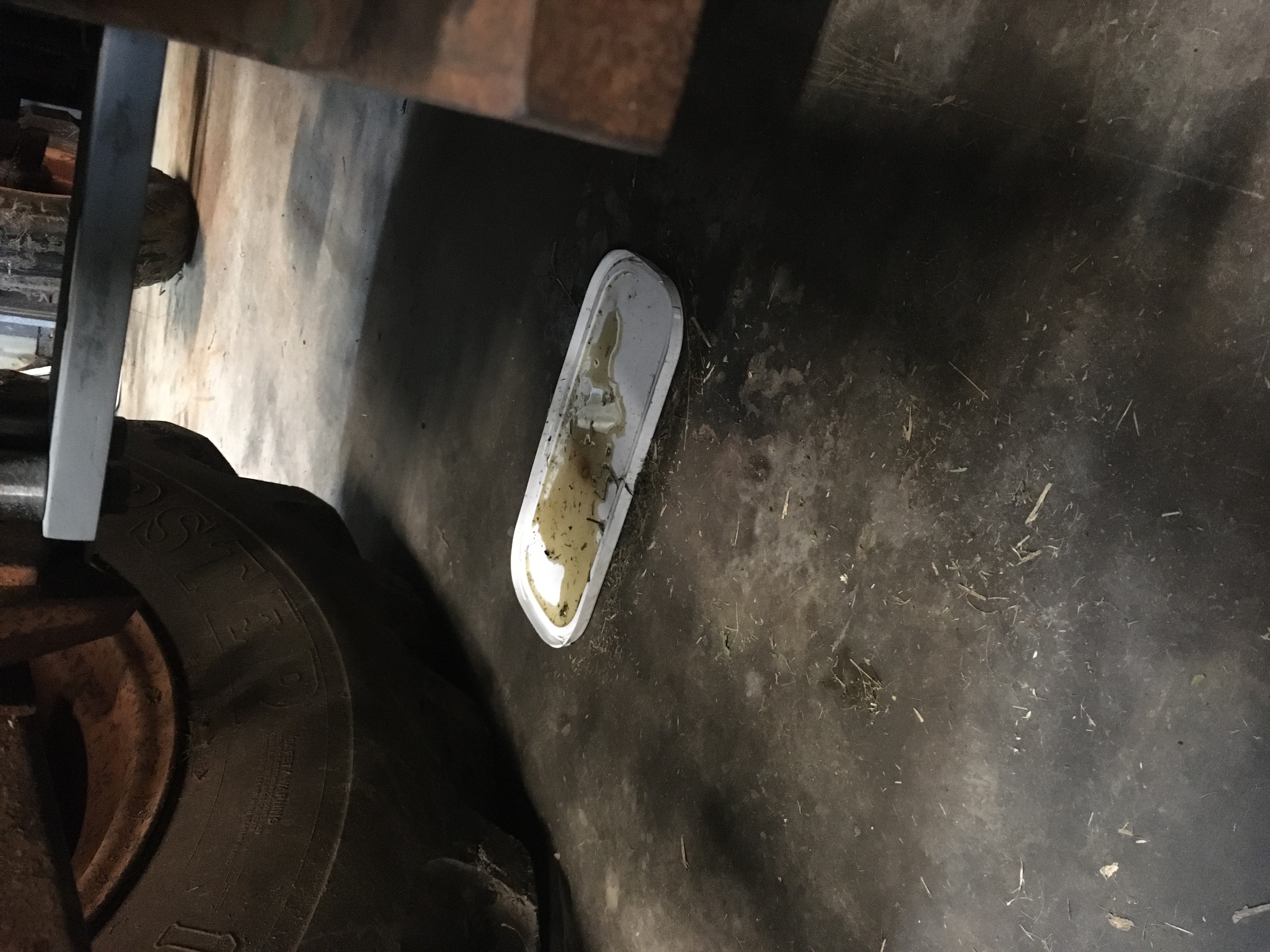

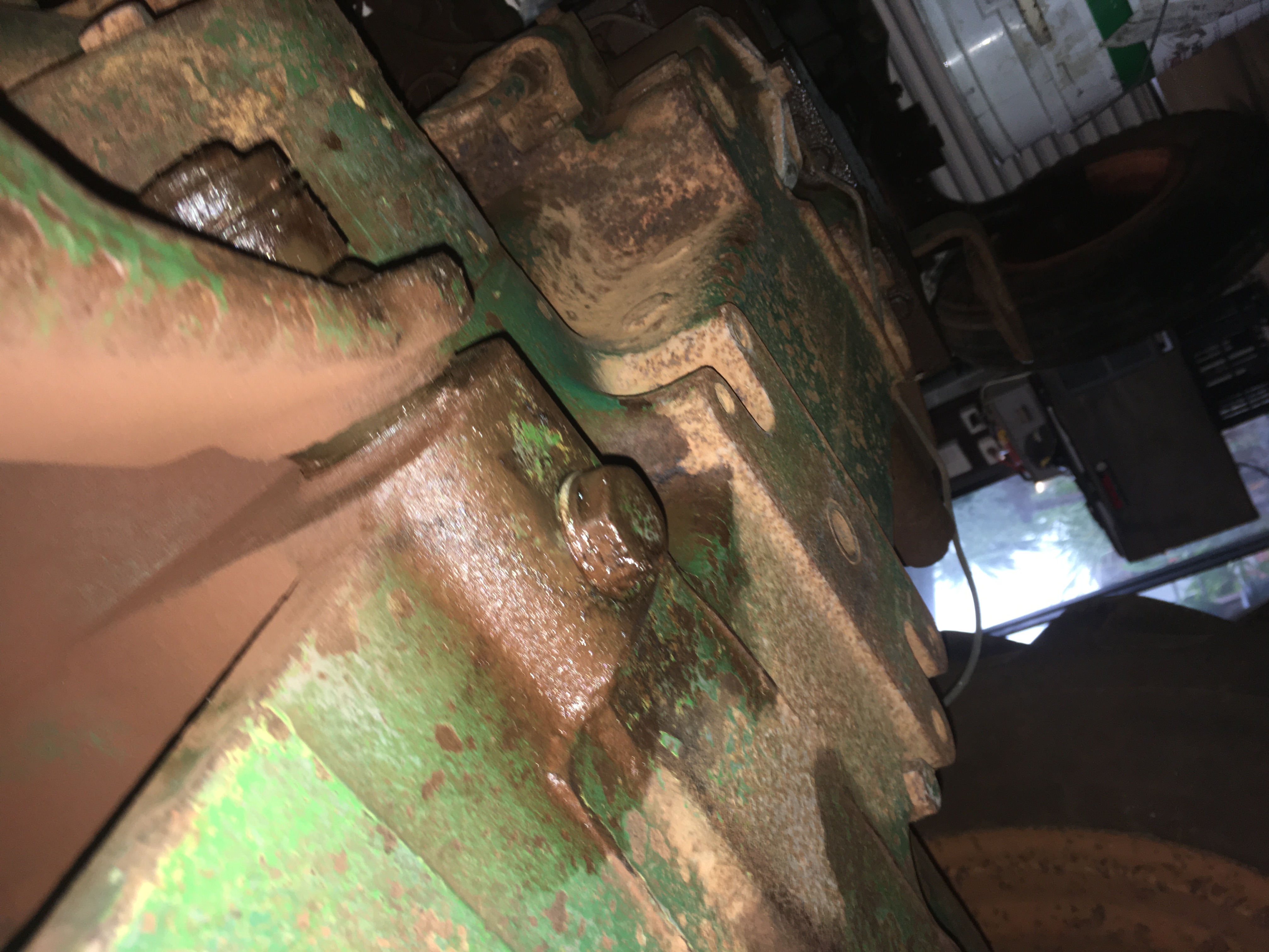

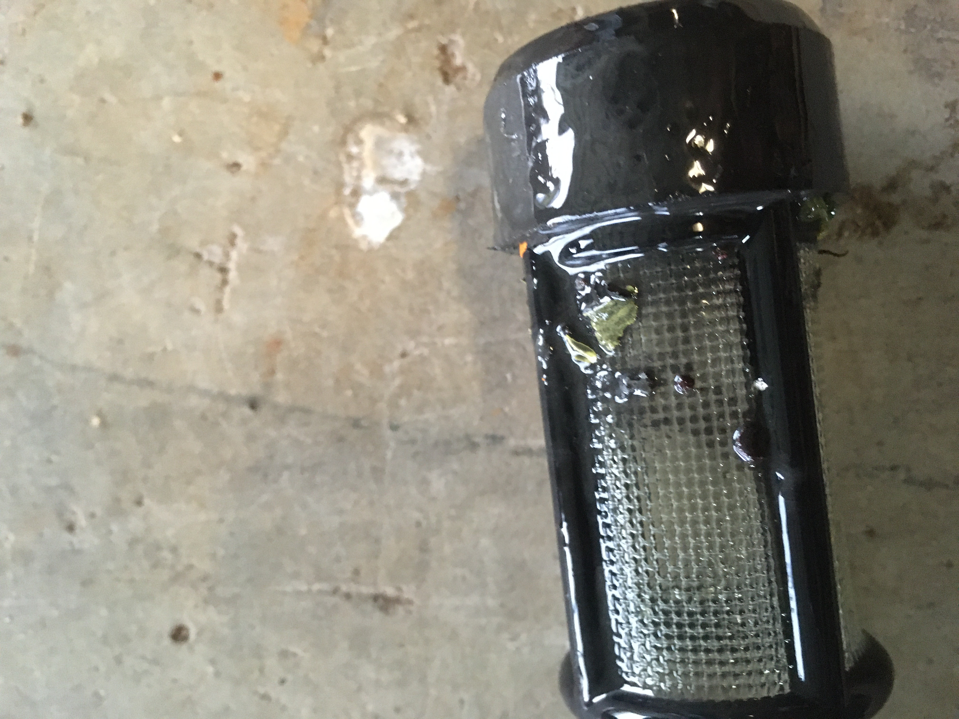

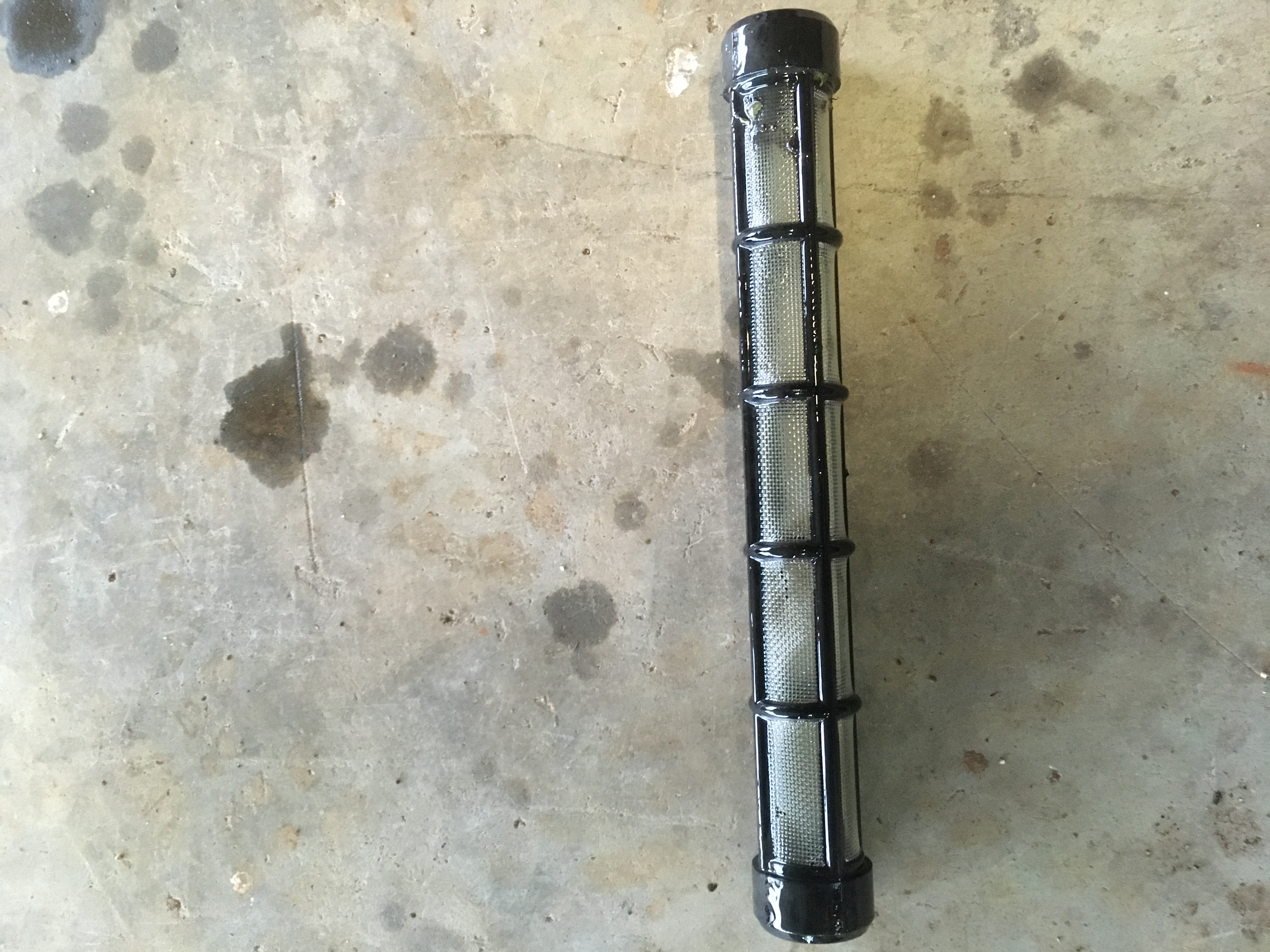

She is a goer!!! Runs, drives, steers, lifts. For reference this is the plug on the bottom of the trumpet housing I was talking about. After draining the main plug I got about another five litres out of this plug. Took about 30 litres to fill on the dipstick. Also shown is the hydraulic screen how I pulled it out. I was expecting it to be solid. About four bits of rubbish on the end of it. I had to travel a four hour round trip to get the right filter which was a bummer. The one I got originally was an ar75603. I needed an al25554. Built in bypass valve. Was a long haul waiting for parts and learning a lot along the way but I am sure I will be back for more experience down the track. Not much I can do with it as we are getting uncommon torrential winter rain. Cows are fat and will lessen the stress of having to bale too soon. Thanks again for the expertise. Will keep reading lots of other jd posts to get on top of any problems before they get to bad.

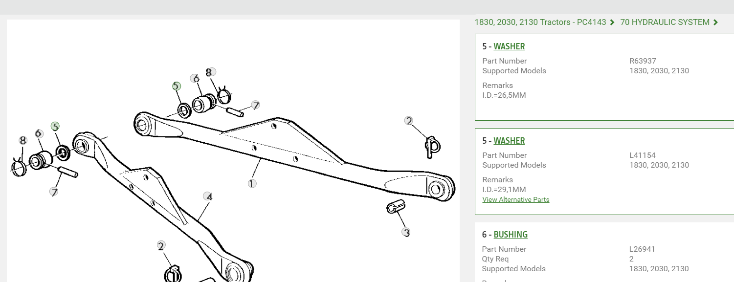

Dealer charged for me for 15 gallons of Hy-Gard for total of $164 for hyd oil Shim washers for your tractors L/D shaft are shown in photo below

To Ausmac, note their are two different IDs for the shim washers, key 5.
