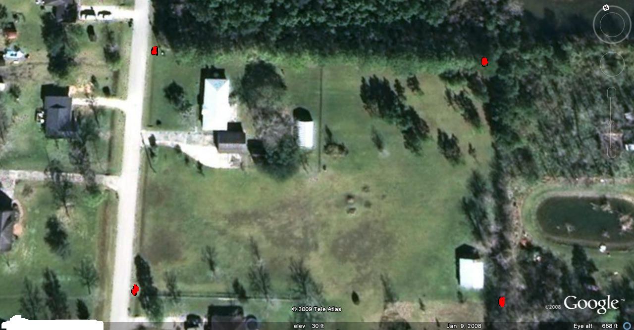

1st of all...I'm really frustrated with trying to decide what's the best model tractor for my situation. I have been looking for 4 months now and I still can't decide. I've read what seems like a million threads on tractor buying but since everyone's situation is a little more unique I figured I'd lay out my planned uses and just have everyone chime in. I've seen several threads where this was done and by the end of it we were all blessed with pictures of a new addition to the family. Also, I hope I don't offend anyone here but, I plan on posting this same topic on other sites as well to be able to get as many different opinions as possible.
By the way, I'm detail oriented so I'll apologize now for being long winded.
My homestead is two 1.4 acre lots (2.8 acres total) located in Texas between Houston and Galveston, and yes, Hurricane Ike recently remodeled my landscaping. One lot has the house on it and the other is clear with an old pole barn on it. I mow the whole thing regularly. I currently have a 54" deck on a regular garden tractor. The 54" deck barely fits between some of the trees I have so I'm trying to stay with that size. The vacant lot that I have was used for animals years ago. The previous owner didn't use it for anything. He just let it go and would only cut it with a bush hog once a year or so. It has A LOT of what I call "coastal hay" that grows at 3-4 times the rate of our San Augustine grass. I hate it. The lot is heavily compacted and has many low spots. I'm going to try and attach a Google picture of my property so everyone can get a visual. The low areas are pretty apparent.
I also have 21 acres of property (mostly wooded) in East Texas. An old Ford 3000 tractor came with the property. It has the diesel engine and runs good. No power steering, no 4WD, no FEL, no BH, and the 3-Point bleeds down regularly. It works O.K. for using the bush hog up there but that's about it. When I got the place up there 2-3 acres of it looked like Sanford and Son's place. Refrigerators, washing machines, dryers, water heaters, you name it, for as far as the eye could see. I ended up hiring a couple of guys to clear the debris because it was a pretty big liability for me. They brought in a bull dozer and a TLB and hauled all the big stuff off for scrap. All the trash was either pushed into piles or buried... and there it still sits... lots of it.
The tractor I'm looking to buy will predominately be use at my homestead. I need it to be light enough to use as a finish mower but I'd like the capability to use it as a TLB as needed. I do not want to have a tractor AND a lawn mower. I want one to do both jobs. I'm limited on storage space around here and I'm getting tired of maintaining so many engines (garden tractor, push mower, generator, weedeater, chainsaw, and chipper/shredder). I don't plan on hauling this thing to East Texas all the time but it will be needed at times for sure.
I'm a total rookie at tractor operation. I've never owned or operated one (other than trial and error on the Ford in East Texas). Everything I know I learned from the internet. Pretty scary huh?
As of 2 days ago I had convinced myself that the BX25 was the way to go. Then, just as I was about to head to the dealer to seal the deal, doubt crept in. You know, the Pre-Buyers Remorse-Remorse. Am I going to regret the Sub-Compact, I asked myself? I read it about all the time on these threads. Actually, the only thing that I don't like about the Sub-Compact is the fact that the 3-Point sits so low to the ground that you are limited on what 3-Point implements you can hook up to it. Now, do I need to be able to hook up a lot of 3-point implements? Hmmm, maybe not now, but what about the future? For my vacant lot I need to do a lot of grading. I know the BX can do it... but am I going to miss the extra ground clearance when I drag this thing up to East Texas?
I started to look at the next size up from the BX. The 2320, although taller, didn't offer much more than the BX for the money. The B2620 or B2920 would be the only way to go if I "stepped up". I got a price quote today for the B2920 and it sure seemed high compared to the BX25. It looks like Kubota has raised their prices since I started looking back in September.
I got a price quote on the BX25 as follows:
$15,950 w/ R4 tires and 12" Bucket.
$225 for the 3-Point Hitch
$1450 for the 54" Mid Mount Mower.
For an "estimated" $400 more I could get another set of wheels with turf tires. (I think I would use Turfs around here mainly but for serious dirt work and my trips to East Texas I can see the R4's being an asset).
From the same dealer I got a quote on a B2920:
$23,800 w/ Turf Tires, FEL, BH, & 54" Mid Mount Mower.
That seemed high to me. It also left me scratching my head... Main reason is because I don't want to spend that much. $21K - $22K out the door max...and the $22K is pushing it. Maybe a B2620? I can't imagine the price being that much cheaper and the extra PTO HP on the B2920 would be nice to have if needed.
The BX25's price is tempting. I'm just slightly concerned about regretting not getting the "bigger" tractor. This wouldn't be a problem if the B Series Tractors didn't offer up such a small footprint and low weight. I wouldn't even be considering them otherwise. They're basically just ever so slightly larger than the BX25 but they've got that height thing going for them...
Help...
