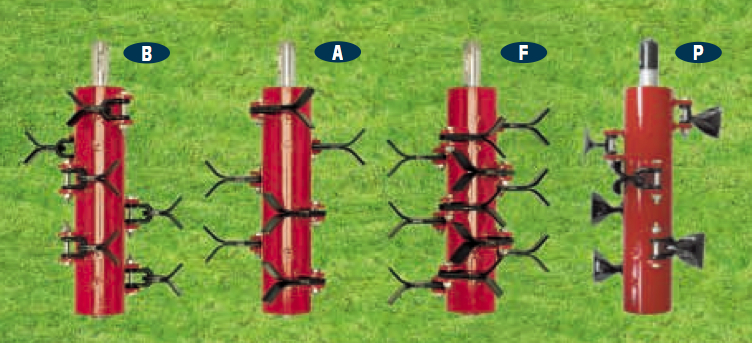

I do not have the mower yet, but here is a photo of the different rotors/flails used in the various Caroni models.
The flail in the B and F is the same shape ("Y") , but more of them and I think the flail attachment point is different.

The F Rotor on of the Caroni flail mower has the attachment weldment points at the 12, 3, 6 and 9 o'oclock positition as shown on the parts manual.
As your mower has 112 side slicer knives you have fourteen mounting stations per row mounting 14 side slicer pairs=28 knives per row.

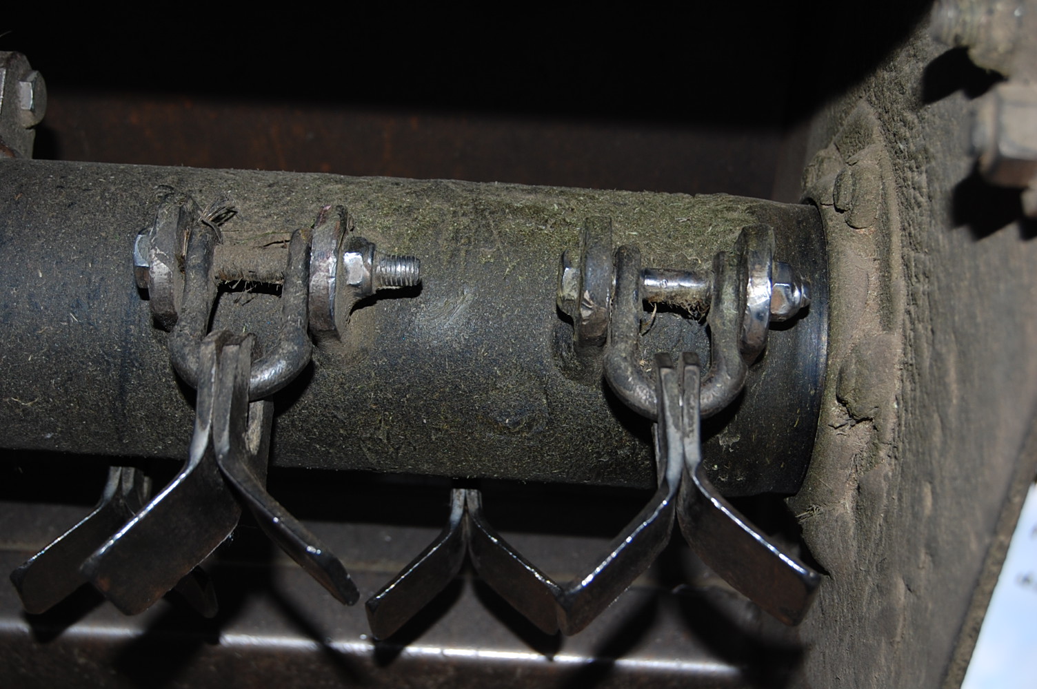

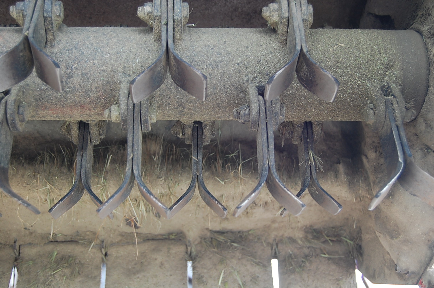

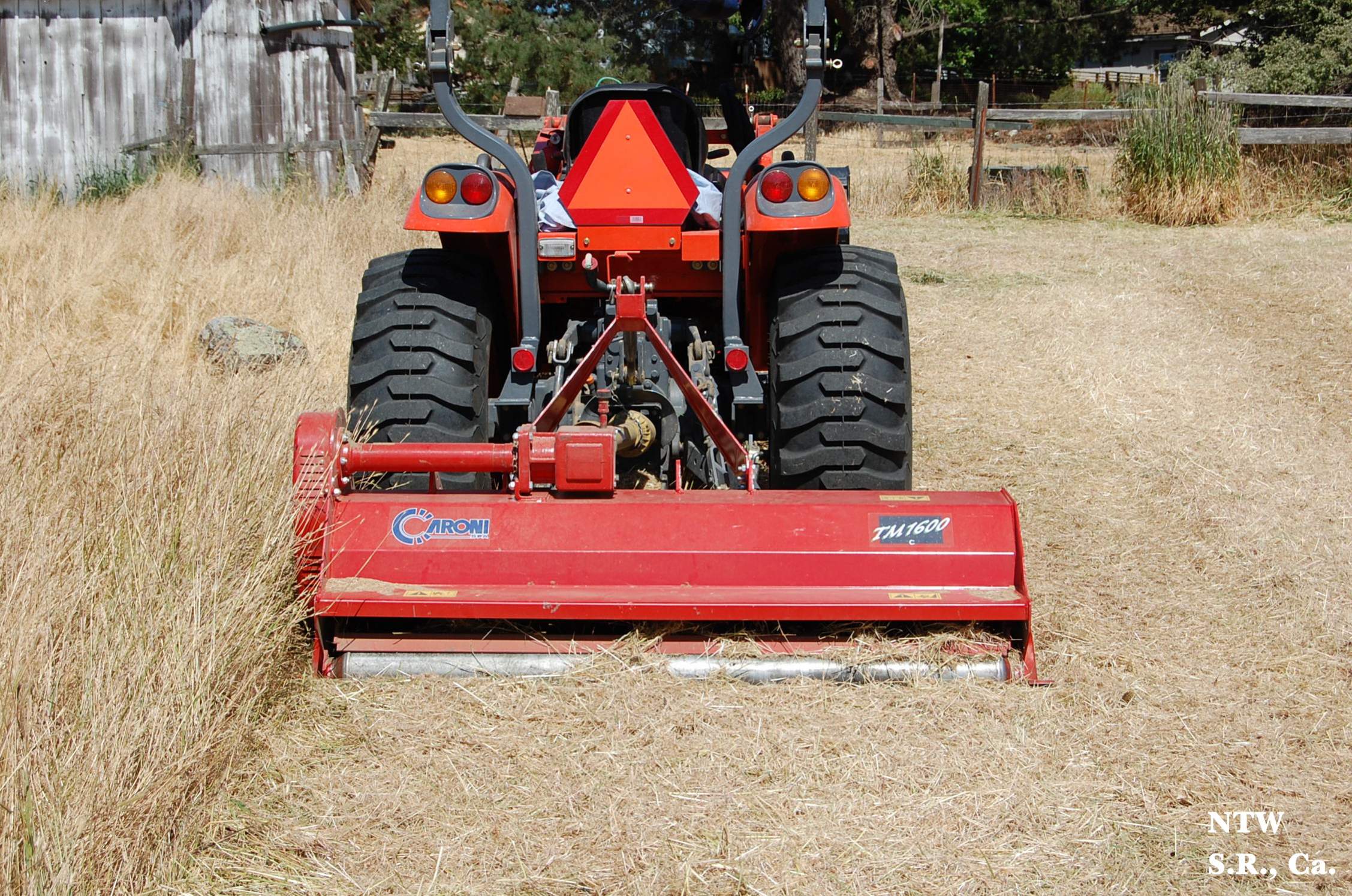

The "B" and "F" rotors have "Y" blades. The "B" rotor blades are shorter and attache to rotor via a shackle and bolt/nut allowing them more deflection when encountering rocks etc. and are half the number of blades as an "F" rotor i.e. my TM1600F has 96 blades and my TM1600B has 48.
The blades on a "F" rotor are longer and attach via a nut/bolt and, from experience, they will tend to bend when hitting hard immovable objects as they hit, fold back and splay outward.
The "F" rotor will work well if you have a fairly clean area to mow but if not, then I'd recommend the "B" type rotor/blades as they'll take quit a bit of abuse.
"Scoop" type blades don't like much more than lawns and/or fine grasses as the cutting edge will chip and/or bend if a hard object is encountered -----just my experience.

Is there any reason that the fine cut blade on the left will not provide a good finish cut.
Does anyone have any pictures for comparison, using the best blades on each cutter.
My Ford 917 has those type blades shown on the left in your pic and it cuts as good as a lawn mower.

So nobody knows of anyone with Caroni's P knives (scoops I guess they're called?) shown in the pic posted by RFB (below again)?
That's what I think I'd like. Seems like the perfect combination of manicured lawn cut but still with the ability for the blade's to bounce back off a solid objects like a bush hog/rotary cutter.

Just added a pic of the 1600F to my post, sorry 'bout all the mud but that's what happens when you mow a field of wet grass with tons of gopher mounds! As far power required between the two types.........not really. With my tractor I do almost all mowing in 3rd/low @ 540 pto rpm, if conditions allow, I'll run 4th/low. As for the 1600F if I use it in a field that has what we call out here "Harding" grass, I'll sometimes have to drop down to 2nd/low in order to allow it time to chew up the thick stalky stuff and spit it out. If not and ground speed is too fast it tends to "jamb" up the mower with large balls of grass. I believe this happens because of the number blades and the fact that it re-cuts the grass/weeds more than the 1600B before it spits out.(just my analogie) Other than that, I use the 1600F on fields and yards that are to some, thier "back yards" where thay like that carpet look after it's cut.

I'm not so sure the scoops are a big difference from the F knives in terms of performance. They are both intended for manicured lawns. Only the B knives are really intended for brush. I am not sure where the notion that the scoops overlap between B and F comes from.

I'm aware of that - It's the horizontal cut I want from the "P" knives/ scoops.

The turf type and duty cycle are the major consideration as the scoop knives are lower in number and total cutting edge length is less in total length which are the major issue.
The Caroni B and F rotors have a stationary knive assembly where the knives
maintain their orbit and do not slide out (the side slicers do not have an oval hanger hole)to create a more aerodynamic shape with these models.
If you want a fine mowed grass look with any rotor type-
The slower you can travel the better the cut as the flail mower rotor has more time to cut and recut each inch of advance.
