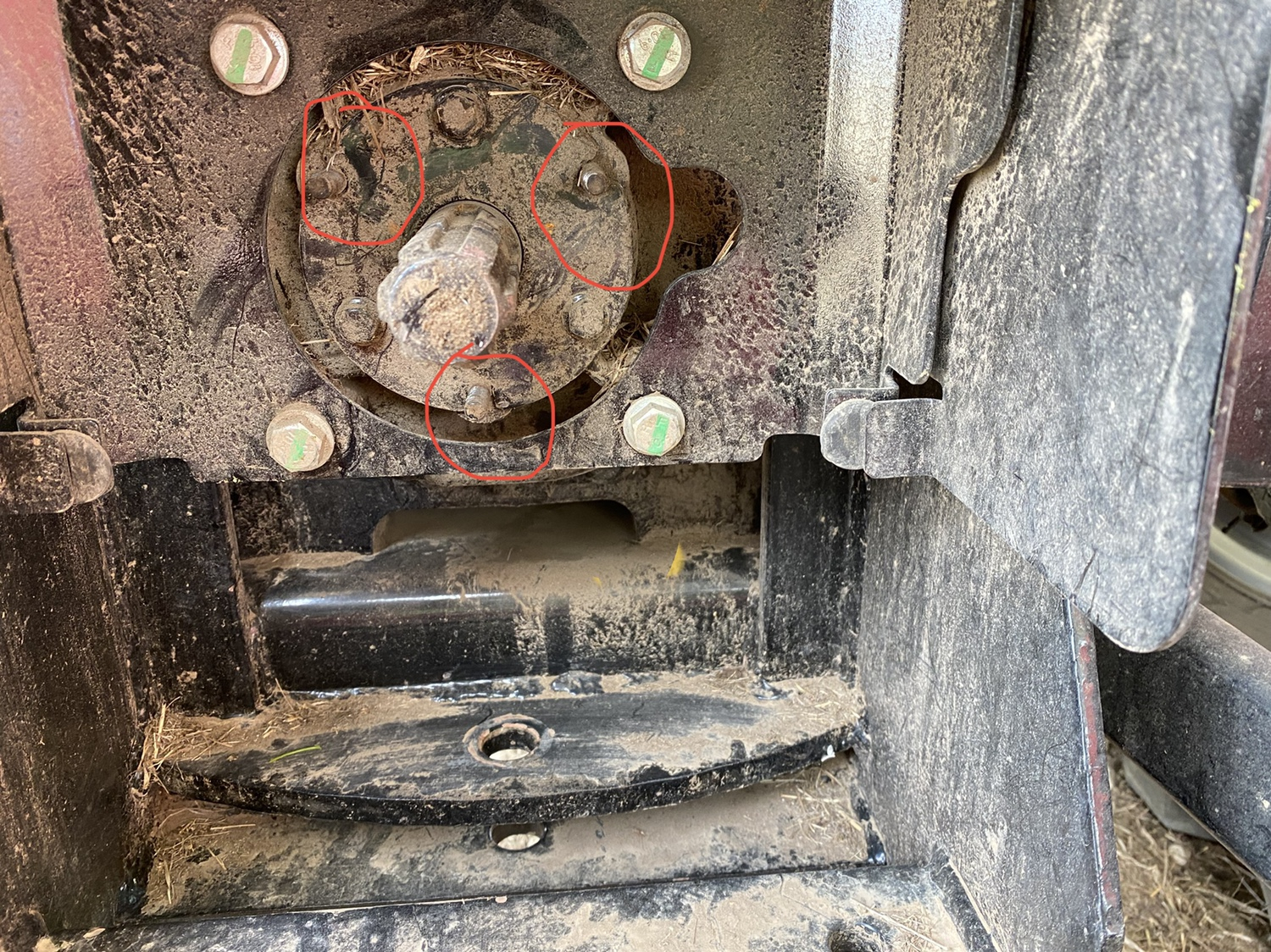

Will someone take a photo of their PTO shaft housing? I removed my cutter and I noticed three bolts sticking out unprotected. I’m wondering if something fell off or not. I circled the bolts in red in the attached photo. Yes, I know everything is a little dirty at the moment.

Those are the bolts that hold on the plastic PTO shaft cover that should have been on the tractor when you got it from the dealership. There are Nylock type nuts on there and you loosen them a little and give the cover a quarter turn and it comes off. Then those nuts stay there if you ever wanted to put the cover back on for any reason.
Thank you. I’m thinking it could have fallen off. Do I need to be concerned? Should I go ahead and order a replacement?

Nothing to worry about at all. If you plan to keep the tractor outside I would just smear some grease on your PTO shaft to keep it from rusting. I don’t think anyone actually uses those covers once they take them off for the first time. How do you like the new tractor so far? Any observations for the rest of us new owners?
