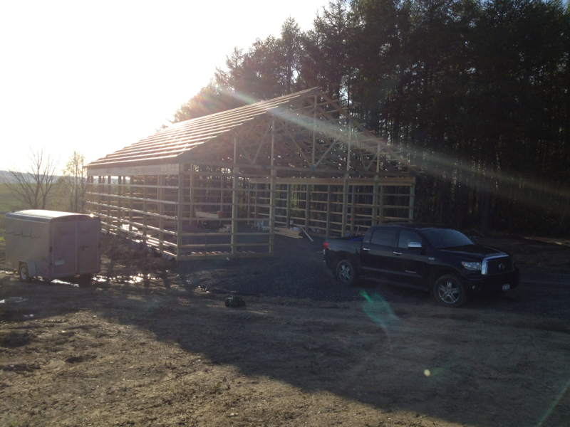

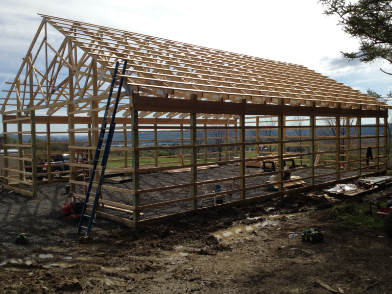

Darrenone, Looks great! FWIW I would add quite a few diagonal braces to the underside of the trusses to keep them from folding over in high winds. It looks like you have a few in place but the more the better. The diagonal braces will really tighten the trusses up and make it a lot safer, and only costs a few bucks for the 2 X 4's. Just my 2 cents of course!!
   / New Pole Barn project getting started.
#64
Thanks srs. Before we left for the day we added quite a few diagonal braces to the trusses for just the reasons you mentioned. Last summer a huge pole barn 10 miles from me had all the trusses blown over and it was a disaster. I want to get all the permanent purlins on and all the bracing on as quick as possible. Just not as young as I once was and climbing the trusses is a much slower process now. I do appreciate the input as I appreciate all the help I can get.

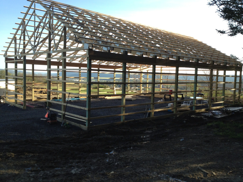

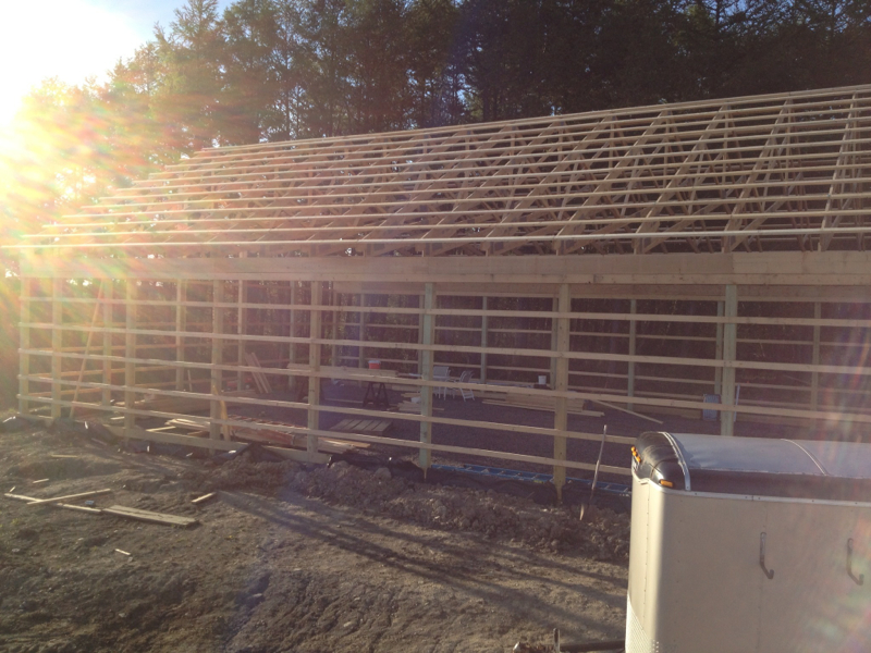

Ok, I worked both Saturday and Sunday and only managed to get the purlins up. Frustrating but at the same time it is progress.

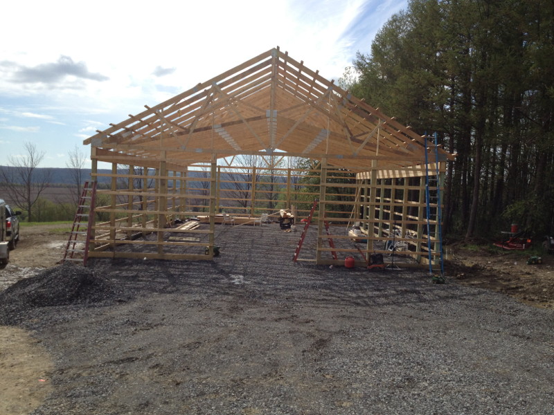

Progress is frustratingly so but we are gaining.

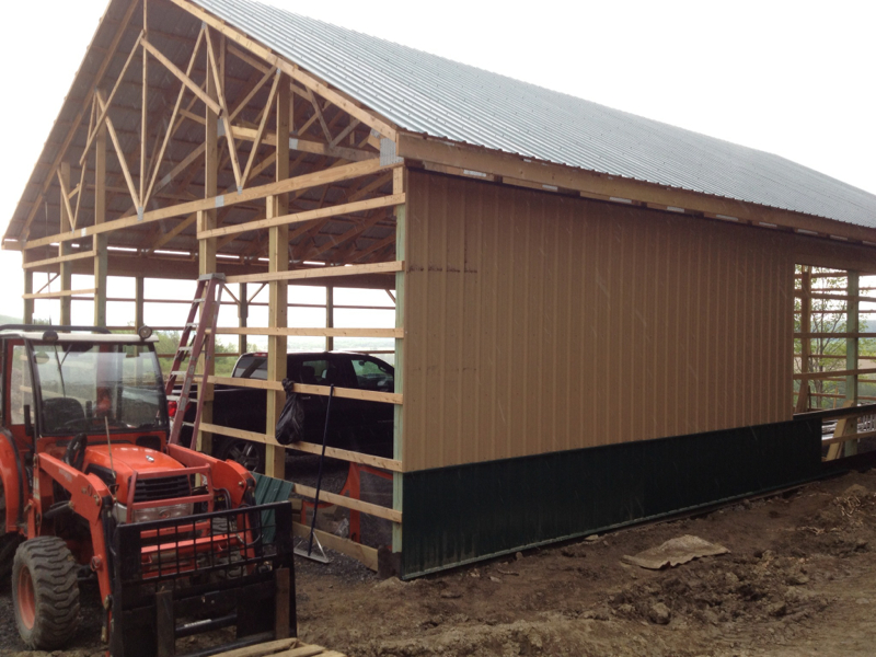

Very cool project, thanks for sharing so much about it.

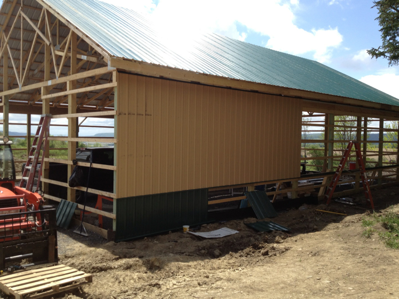

For the two tone tin on the walls.
Is the lower piece still metal, or is that a no rust plastic thing?
#70
Hey Daronspicher, thanks. The lower section is the same metal as the upper. The ideal is just to break up the wall and hopefully look a little nicer. No other reason
