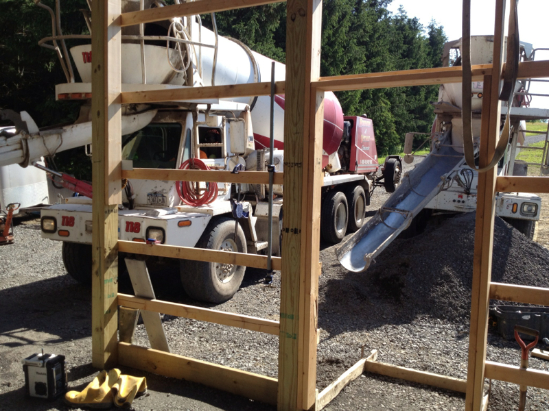

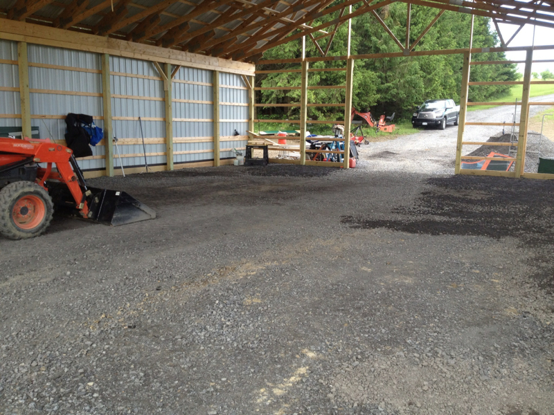

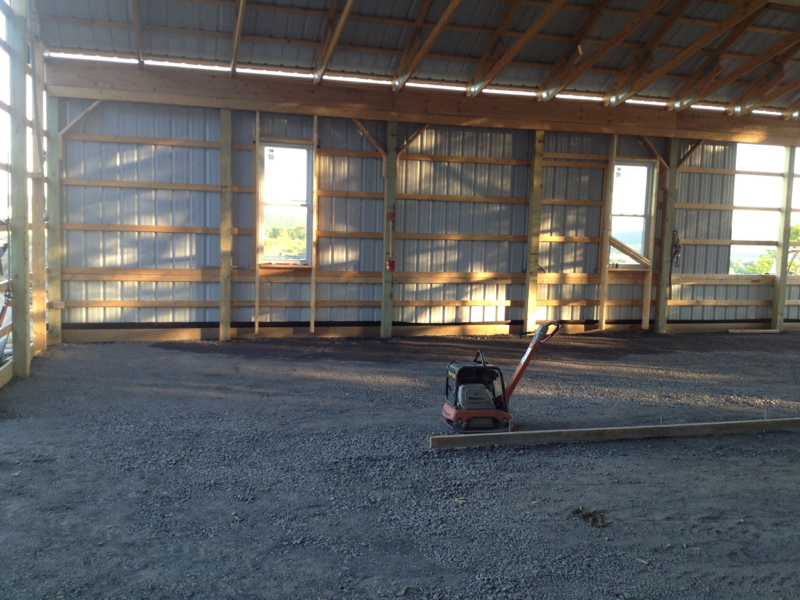

Decided it was best to do the concrete floor before all the walls were up because the concrete trucks will not fit under my door opening. I was going to hold off because of money but it will be so much harder later. So, I've been preparing the floor trying to level it up with stone.

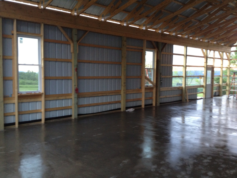

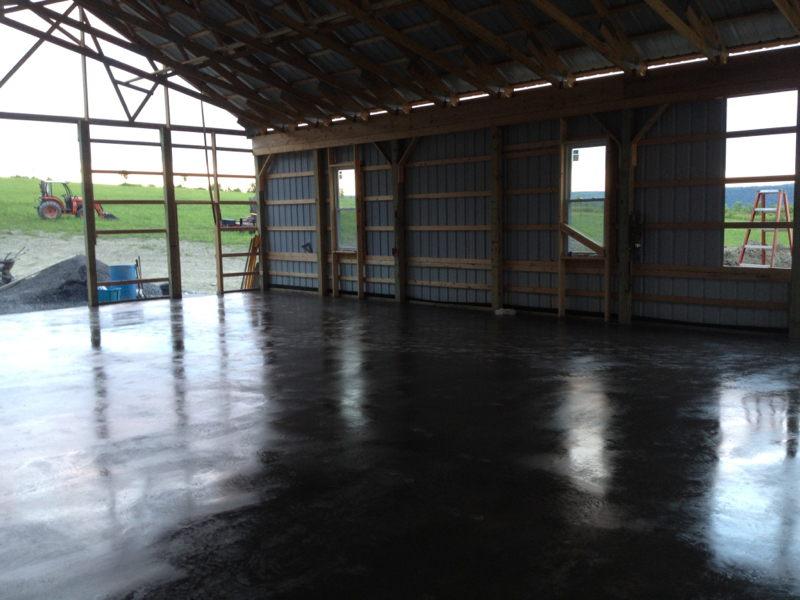

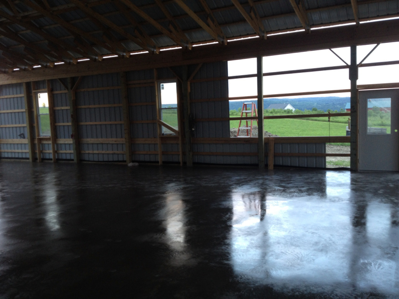

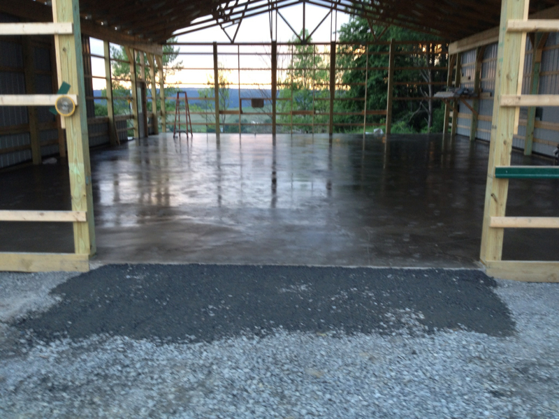

Ok, now I have a concrete floor which makes it much nicer. Alot of work but it came out good. The concrete guy busted there butts. That's my son sitting in one of the trucks. 32 yards to do the floor about 4 inches. I sealed it right after they finished it. Needs one more coat which I will mix with the fine sand material so it won't be so slick when wet. Happy that part is done.
