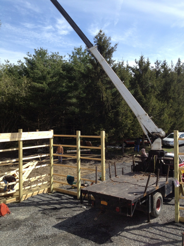

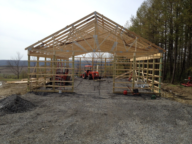

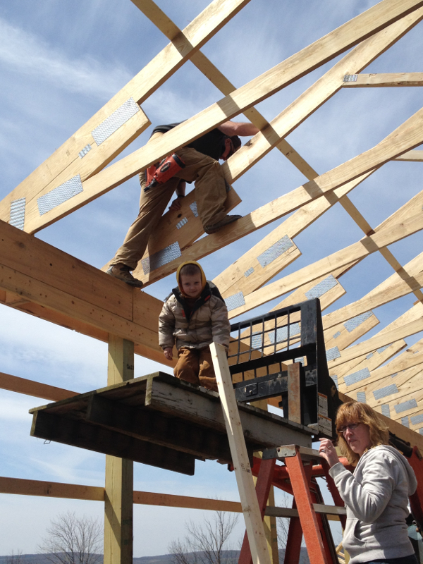

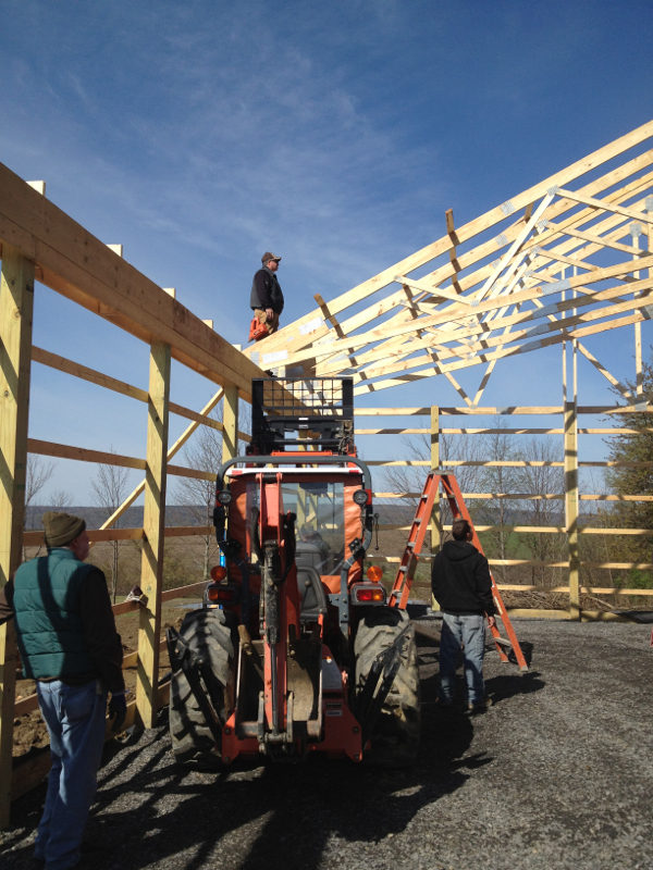

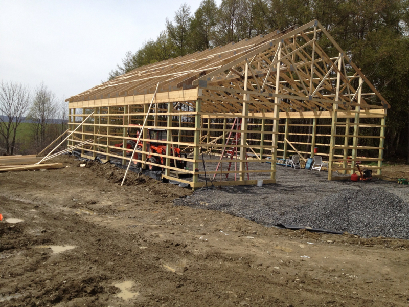

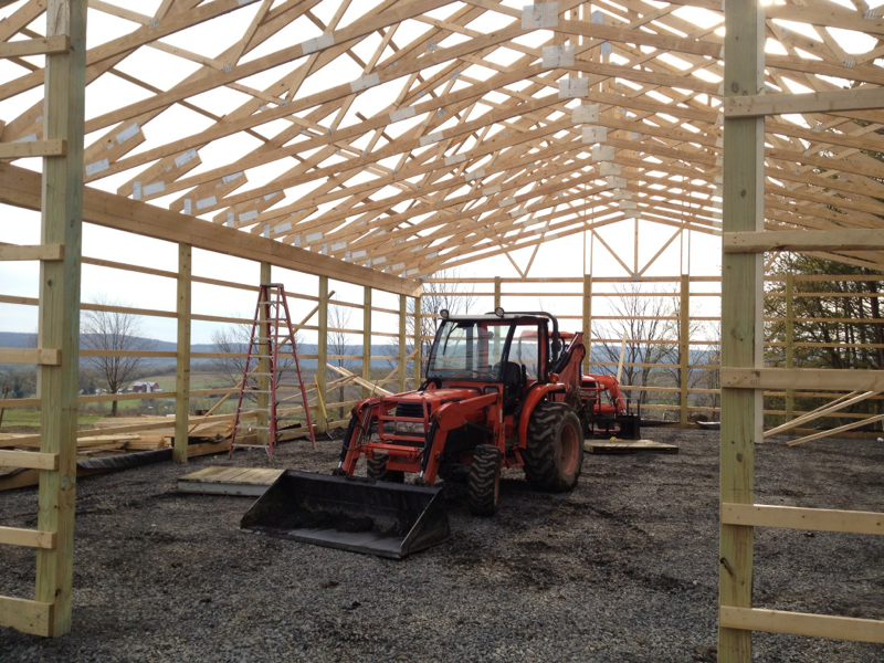

Well after two weekends of bad weather to postpone the trusses, I finally was able to get them up. Four and a half hours for the operator was $450.00 but worth every penny. He could obviously get them up faster but we could not brace them any faster. Anyways, another big step done. Now I need to get the purlins up on 2' centers so I can then get the steel roof on. I hope all the money I'm saving by doing it myself is worth it. Considering a pole barn company is in and out in 5 days. Well, it will be worth it when I'm done.

Even got the family to help. What about child labor laws? He is just small for his age....

Your location in NY, I assume you get quite a bit of lake effect snow? Are those rafters 5 or 6/12 pitch?, and on 4' centers - WOW. Should be heck for stout. Mine are 42' freespan on 8' centers.

Hey Depmandog. Yes, we get quite a bit of snow normally( not so much this winter) so the trusses had to be made to handle the snow load. They are 6 1/2/ 12 because they are a scissor truss. The inside is a 3/12 to get more head rm for storage above an area where I will build my shop (wood working ). They are also on 4 ft centers. Seemed a bit much to me but had it engineered by a pole barn company not far from me. The scenery is beautiful and thanks.

With that big tractor you have there you could have easily made a jib and set those trusses by yourself and saved even more $$$.

Well I thought hard about trying to set them myself with the tractor but thought with them being 42' long and heavy enough that two people could barely stand one up that maybe it wouldn't be such a good ideal. The top of the walls are 12' and the trusses are another 12' so I would have to have rig a long jib. Also, the truss people drop the trusses on the side of the building so it was easiest to lift them over the side wall to put them in place. With a jib, I think I would have had to carry each truss inside the building and then try the lift them in place. I just thought that was going to be too hard and didn't want to risk it not working while all my free help just stood around. Good advice on getting the walls up as quick as possible as I wouldn't want to show up there to work and find out my building was laying in a heap.
