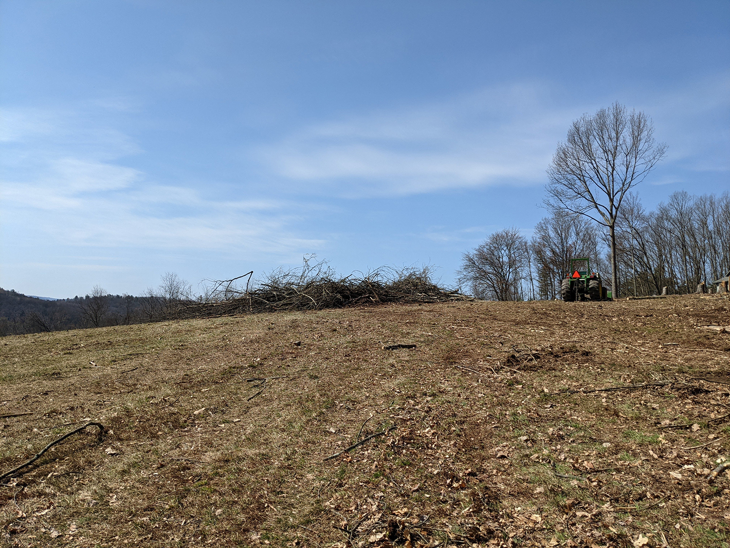

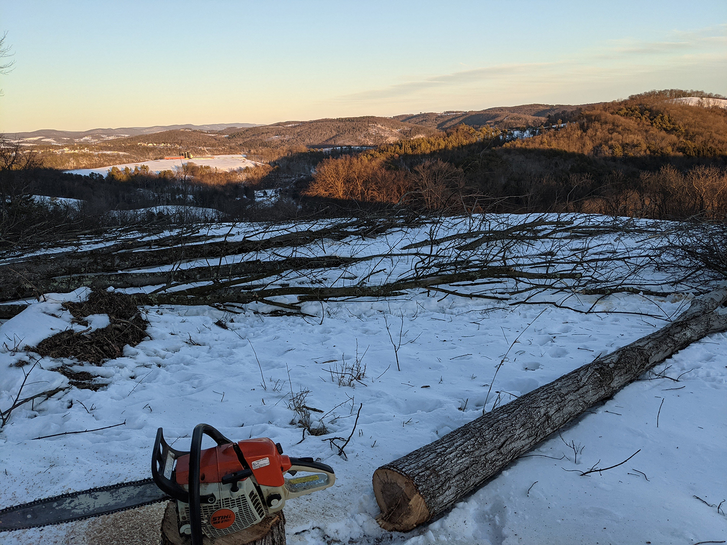

Other than some wiring, framing in an office for my wife, and two sheets of drywall hung, the basement project has been put on hold until lumber prices stabilize. Attention is being moved to the outside. I spent some time this winter downing some trees on the property to allow more morning sun in as well as open up a spot for a future garden. I dropped the trees in the winter, limbed them, and let them sit for the deer to browse and I'm glad I did as our winter was bad here. Now that the snow is gone, I spent a day and skidded everything and pushed the tops into a pile to be burned.
