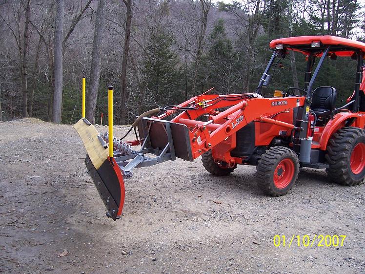

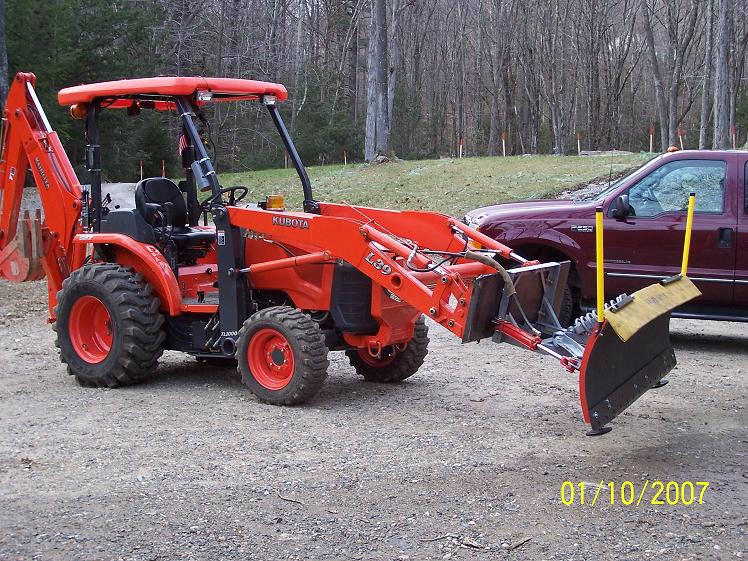

Use caution when attaching plows (esp from other applications) on the loader arms, they are usually mounted too far out away from the front of the tractor. This allows the weight from snow build up in front of the plow, to use leverage in it's favor, and against the tractor. It is even more apparent with a lighter tractor.
Two local Kubota dealers (and a Kioti dealer) warned me against this when I was considering the front (loader arm mount) blades by Curtis. The proper blade made for the tractor is mounted much closer to the frame of the tractor, and does not "hang out" as far as loader mount units. Helps make a much more efficient plowing machine.

WayneW:
Those dealer observations are true. As with any owner created stuff, the burden is on the owner-designer to not exceed the limits of the tractor. After experimenting, it was determined that the proper angle of use means that the loader arms are raised, raising the center of gravity, and placing more stress on the loader arms. As the L-39 loader frame is permanently mounted and stronger than the L-series loaders, I believe it can handle the load that the plow creates.
The plow does project out 24"+ forward of the quick attach plate, creating the leverage that you referred to. As such, you need to account for this when turning & backing, in addition to avoiding solid non-moving items like trees, stones, buildings etc. Whacking that stuff increases the chance of damaging the loader arms, plow/frame and tractor.
I'm guessing the plow & frame were at the dump due to the fact that the plow steel was cracked and frame bent from numerous contact with the above mentioned stuff. I welded, reinforced & un-bent the obvious damaged stuff. I spent around $200.00 including the quick attach plate, steel, paint etc. to restore this. I think that the Curtis plow new is around $2000.00
I feel that I have a usable attachment at a reasonable price. However, as I am the only operator of the tractor/plow, I know it's limitations, and stay within them.
