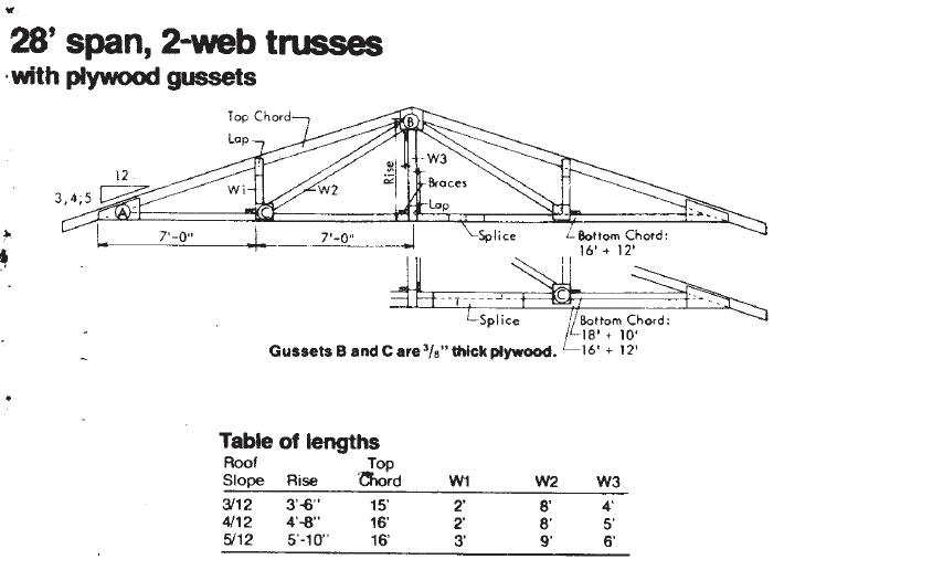

I look forward to seeing the truss design. From my research into trusses I think a 28' clear span truss with 1' overhang will take advantage of 16' lumber with only one joint on the bottom chord and no joints on the top chord.

I am sure everyone has seen these truss designs by Midwest. I don't understand why it is saying both 4/12 and 5/12 use a 16' top chord?
Any problems with this design using 2x4x16's? 24" on center?

4/12 pitch the top chord is 15'10" or use a 16' 2x8 and BANG your done !!

I'm sorry ... you will have to calculate the webbing and layout the plywood gussetts ...
4/12 takes 15'10" and a 5/12 takes 16'3 ... they may be holding the 5/12 in on the bottom web ... on each side, I doubt it ...but they maybe doing it to save from going to 18' lumber
