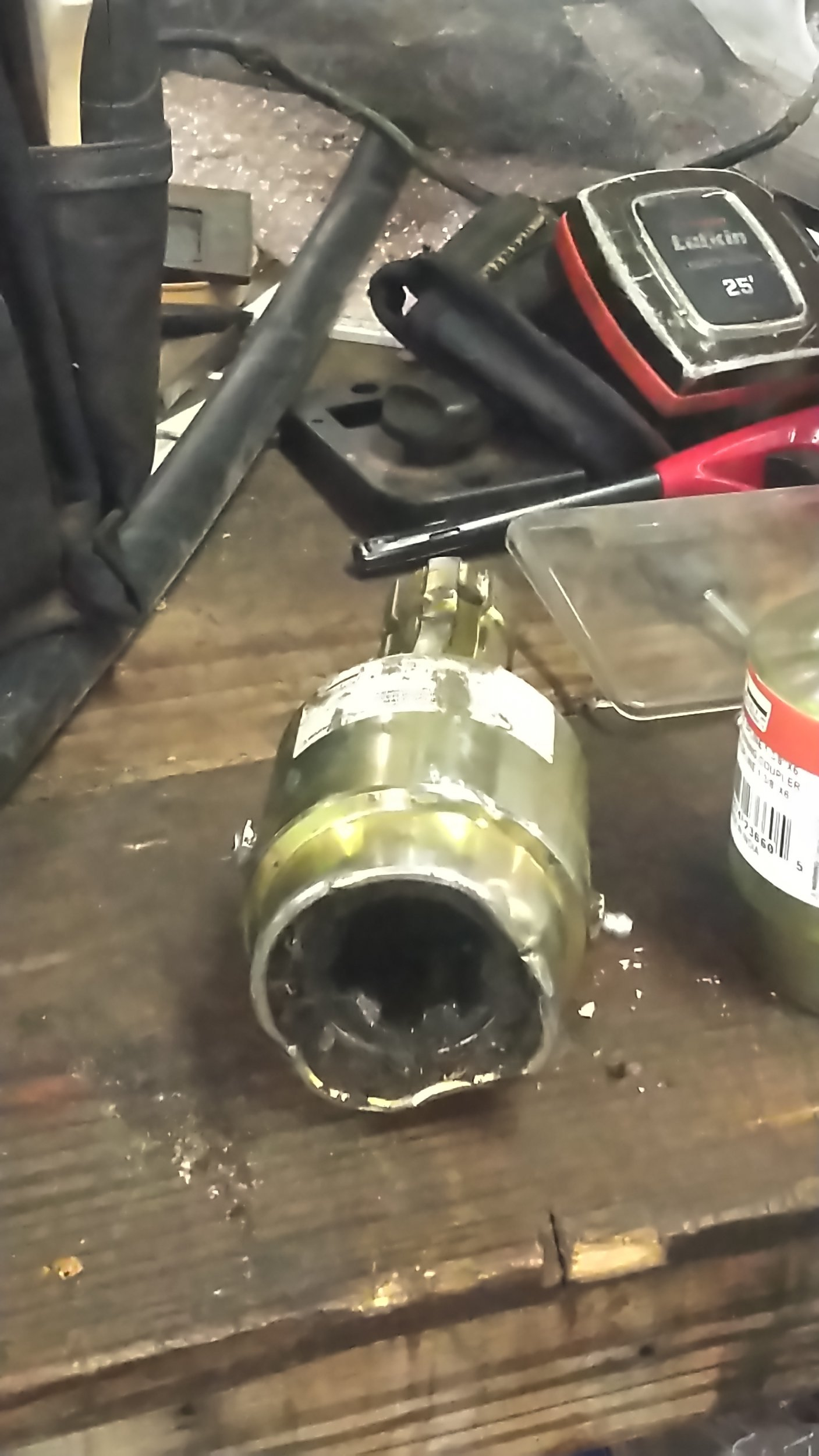

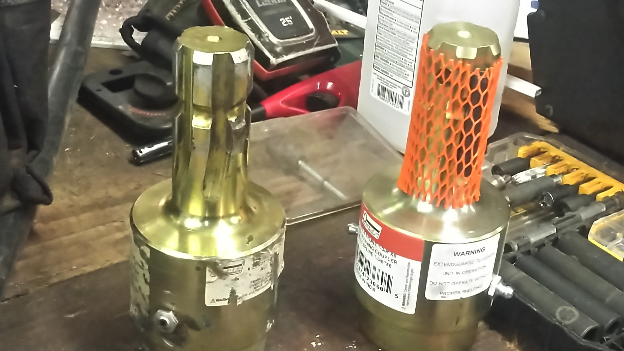

In my hurried arrogance I ruined my overrun coupler it failed before the sheer pins on my rotary cutter. Which I replaced previously with bolts that were not grade 2. It basically twisted the splines and trew the pto shaft to the cutter gear box off, So I told myself I guess my overrun coupler saved the internal pto components on tractor and gear case on cutter thankfully. Ive used pto on tractor afterward without a overrun coupler and everything appears to work as it should.

Don't much care for that style (I believe it's a Weasler)... I prefer the the over the stub shaft lock on style with external grease fittings. Whatever you do, don't allow the cutter to freewheel the stub shaft (no over run coupler installed) because it will eat up the internal PTO brake. Reduce the PTO rpm gradually, don't just disengage the PTO at rated speed. which is something I do even with the over run coupler installed.
O never want to replace the driven pack or the brake plates. Both require a split and dissection of the gearbox.
Once the internal brake is shot, the PTO stub will rotate constantly whether the PTO is engaged or not. That occurs from the parasitic motion imparted to the PTO wet clutch.
Kubota designed the PTO brake to have a 1/4 rotational free turn to allow you to engage a driven implement easier.
