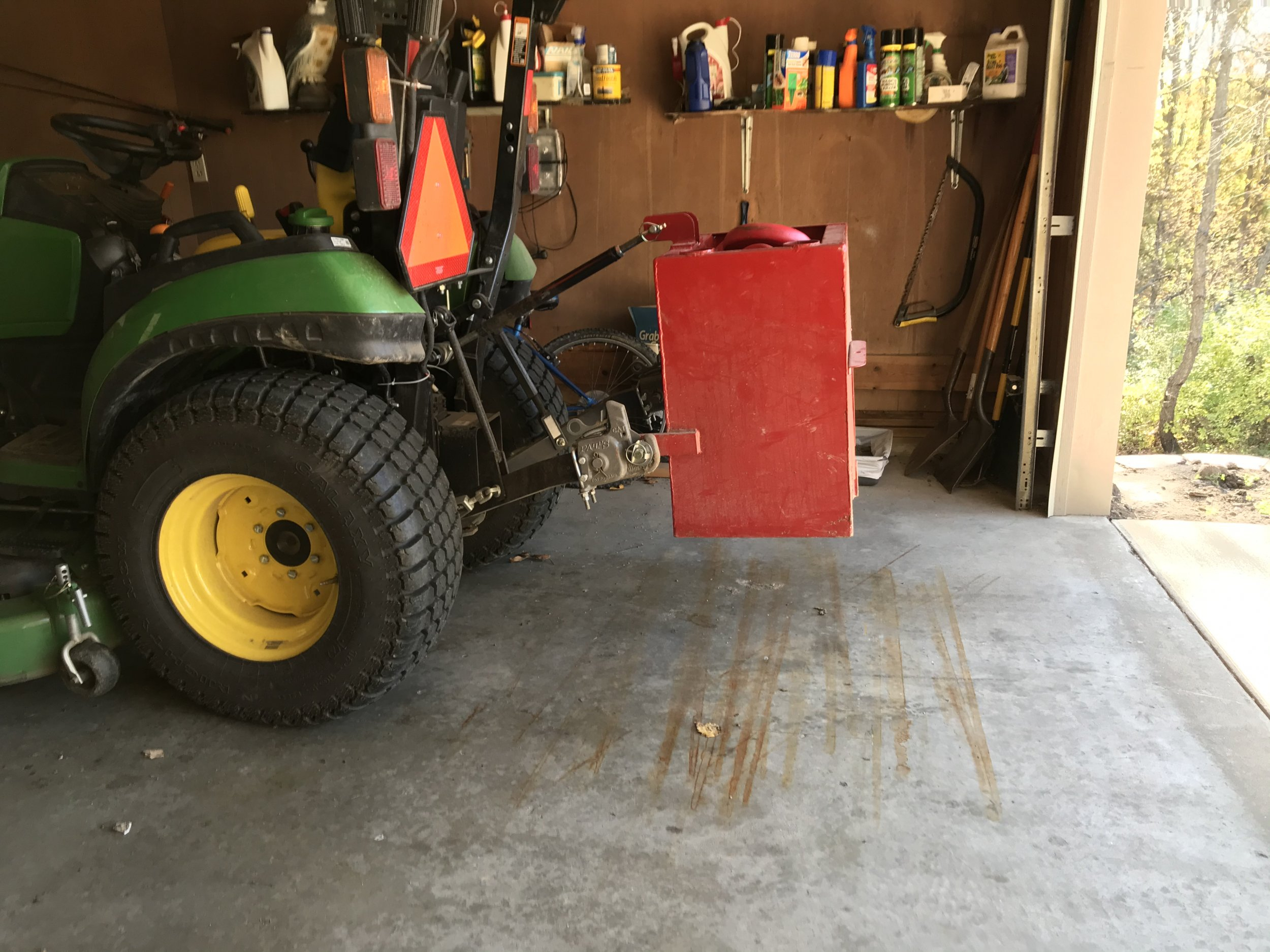

I always hear arguments about placing ballast in the back to reduce stress on the front axle. However, I just can't wrap my head around how this can be helpful without MASSIVE amounts of weight? If you put any more weight on the tractor, even off the back, and the back end is still light (ie wanting to lift when the FEL is lifted), then you have only put MORE WEIGHT ON THE FRONT AXLE. Correct? So, if you are going to rely on ballast, then you'll need to do the math to figure out just how much to offset the front and keep the back wheels planted. The only way to actually lighten the front load is to completely offset, and turn the rear axle into the pivot point. At least that's what my simple brain tells me.
   / Publishing Loader Capacity Numbers That Far Exceed The Capacity Of The Axles #132
Largeone, you are correct. Say the rear tires come slightly off the ground, then the entire weight of everything is on the front axle. If you use enough ballast though, you are taking weight off the front axle.
I can tell when I have my ballast box on. If I have a bucket full and drive the tractor, it rocks back and forth, mainly wanting to rock forward and putting more weight on the front axle. With the ballast box on it doesn’t do this.
   / Publishing Loader Capacity Numbers That Far Exceed The Capacity Of The Axles #133
A picture of my ballast box, you can see how this counter acts weight out front.

I'll have to do some testing...my Mahindra 4540 is a heavy tractor and is capable of lifting heavy loads with the FEL. But, quite a few people have busted their front axles doing just this. I think I would need well over 600 lbs cantilevered off the back to allow the rated FEL lift? I'm gonna pull out my statics book from college...Haha!
   / Publishing Loader Capacity Numbers That Far Exceed The Capacity Of The Axles #135
That's a 5100 lb tractor with a loader capable of 3000 lbs.
I can assure you 600# ballast isn't even close to enough. Unless you hang it on a boom pole about 12' back.
600# for ballast is about right for the real small compact tractors that only weigh 1800# and can only lift 800-900#.
For your tractor.....2000# or so wouldn't hurt

Exactly. My Deere 3303R is lighter than that, and I'm putting 1400 lb. out on the ballast box when doing any serious loader work, in addition to my loaded rear tires. 600 lb. is a joke, on a tractor that size.
