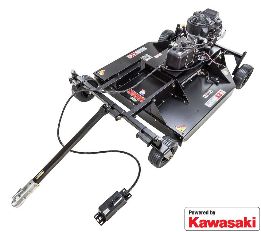

I have an older model 52" Swisher brush cutter that works really well and parts are no problem. It does weigh 700 lbs so a smaller ATV or garden tractor is a little too small. Some of the bigger ATV's/UTV's are probably fine. I had to upgrade to a tractor, however, my brush was tough.
Country Cut 52" 14.5 HP 12V Rough Cut Mower - RC14552CPKA - FREE SHIPPING

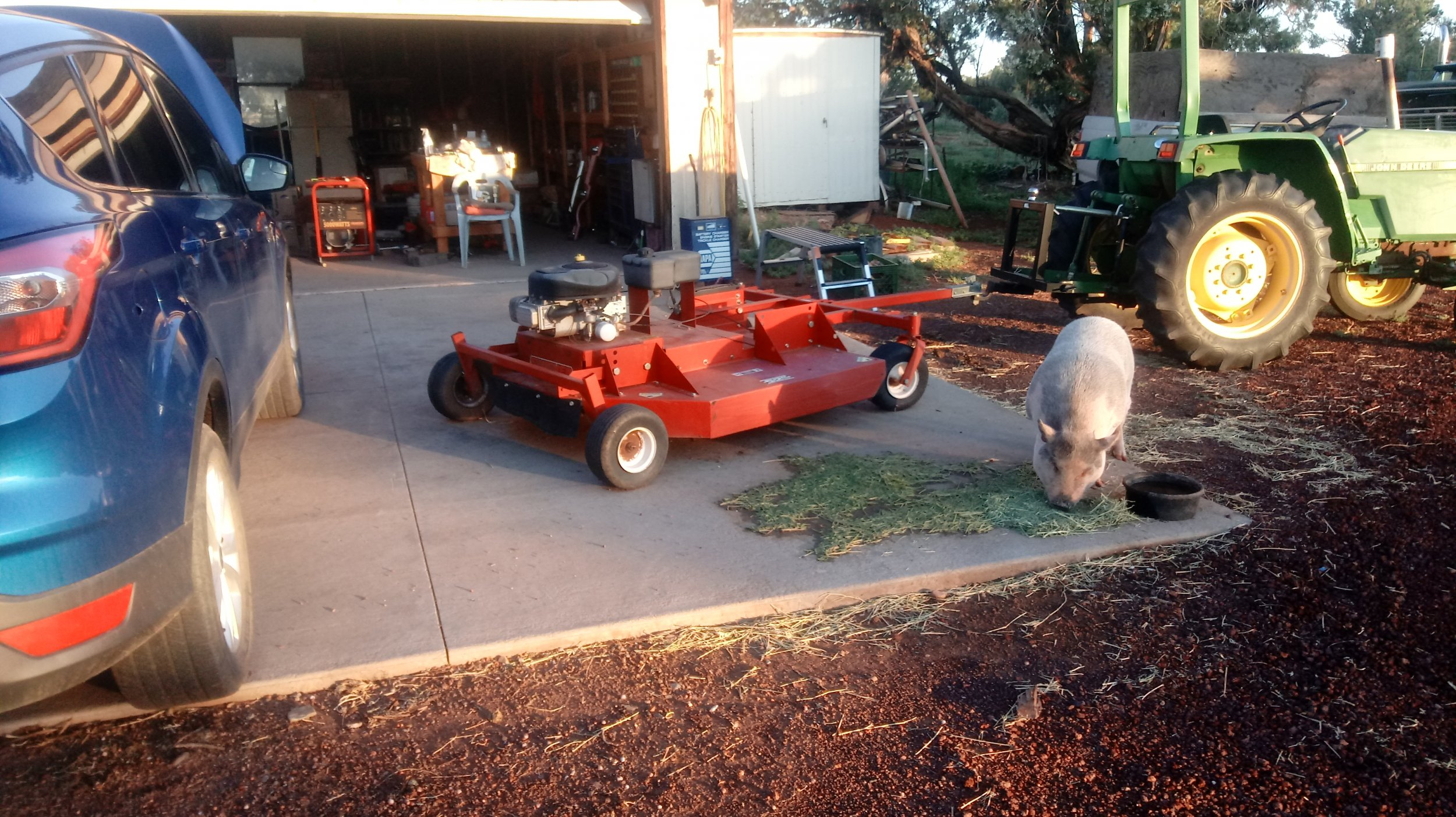

NISAACS A couple questions, if you don't mind. Is that cutter offset to either side and, if so, how far. And what is your pig eating there
Here is a better picture of the front towing setup. You can also flip the tow bar and it gives you a little more offset but it is hard on the hitch. I tow it centered now and just drive the tractor right over the top of the brush. With the quad and garden tractor I couldn't do that. She is eating alfalfa hay, she is my helper...
