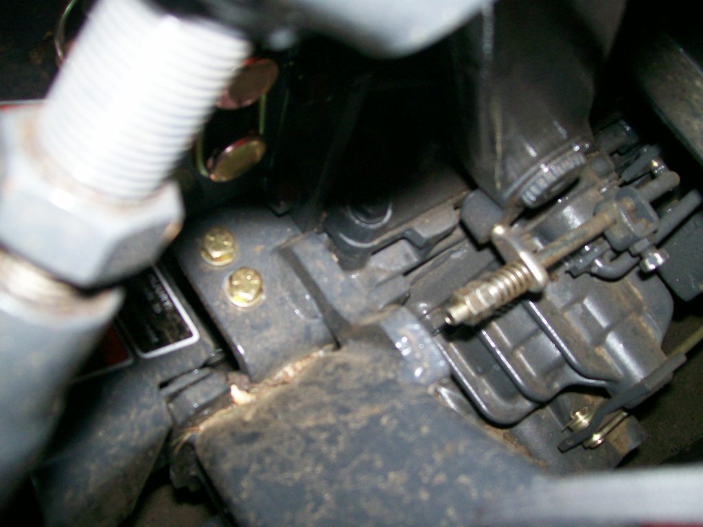

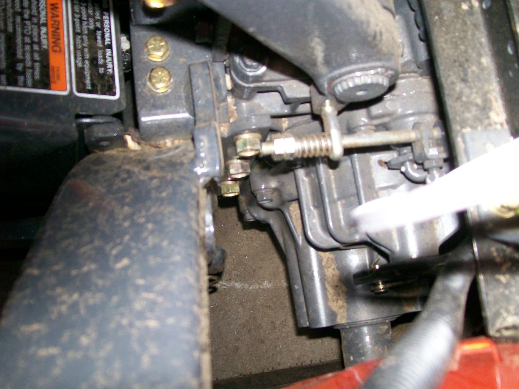

Here are the tabs that are being talked about on a Bxx20 series. That works at low rpm on my tractor, but not at full pto rpm.
Well, after using the tractor with finish mower, I have concluded that I DO NOT have QI. Regardless of RPM, my lift will raise and lower like all the other larger tractors I have owned.
One interesting thing is that the spring on the rod that is adjusted with "nuts" in your photos, only makes contact with the lift arm tab, when the lift is raise all the way up. It centers the lift leaver to "neutral position" When my tractor is running with the lift leaver centered at neutral, there is about 3/4" space between the spring and the lift arm tab.
Since I bought this tractor used, from a dealer, and the owners manual could not be found, they have one ordered.
Closing off the lift knob, unter the seat, and opening it 1/4 turn, solved the lift drop problem.
/ Quarter-inching Valve #65
You will find that the nut on the end that does not contact the spring can be set to limit how far the 3pt hitch drops which is handy when using the rotary cutter, etc. where you want to go back to the same height over, and over. There is a bit of trial, and error setting it, but it does work.
