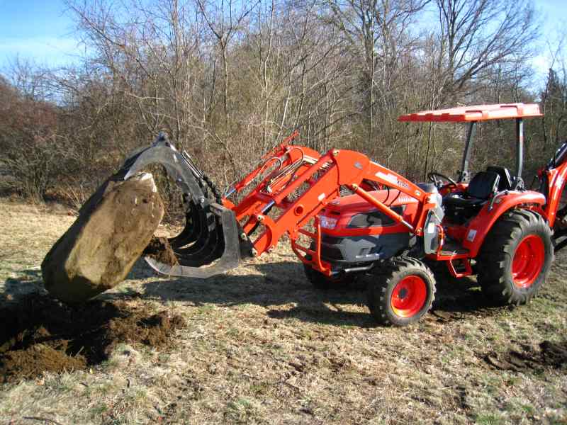

Very reasonable considerations and clearly you are not simply responding to the siren song of "bigger is better". There are a few points I would make in summarizing my seven or so years of using a grapple and participating on TBN in grapple discussions: 1) Any grapple is better than no grapple. 2) Everybody likes whatever grapple they chose to buy. 3) Tractor dealers are mostly ignorant of what size grapples are appropriate for CUTs, 4) Grapple manufacturers sell mostly to skidsteer customers and fail to distinguish between both the capabilities and tasks of typical SS vs CUT customers hence they give the same recommendations. 5) Nowhere is it written that FEL bucket size or tractor width has anything to do with grapple width.
While #1 And #2 would seem to support purchasing just about anything, I would argue that really they mostly support getting a smaller "light duty" grapple. Why get a F450 to drive to the grocery store just because it works and guys who bought F450s to drive to the grocery store report they are happy? Points #3 and #4 suggest that both tractor dealerships and grapple manufacturers are either ignorant of CUT grapple use realities or just want to sell the most expensive product they can talk you into. #5 is important because it is very understandable that someone who is not actively using a grapple would naturally assume that standard bucket width would be an appropriate grapple width too. Indeed, if you are just picking up loose debris at a construction site or fallen tree debris off the ground it is true that a wider grapple is just fine and more efficient.
The rationale for the 48", as you noted, is largely empirical. They work! They dig better. They paradoxically can lift more. When root raking they concentrate force and importantly are much less likely to twist the FEL frame as sudden impacts with hidden solid objects will be midline and between the two FEL arms rather than possibly outside the FEL arms. Those who have not used a 48" often worry that when driving into brush the smaller width will not cover the width of the tractor but this is in practice not an issue. When driving into brush you typically get a full grapple worth well before you drive more than five or six feet into the area being cleared. The grapple is full before you get even past the front wheels typically and it is time to back out and dump. Again, the only time a wide grapple has a clear advantage is when collecting smallish sticks or construction debris which is not all tangled together like typical brush.

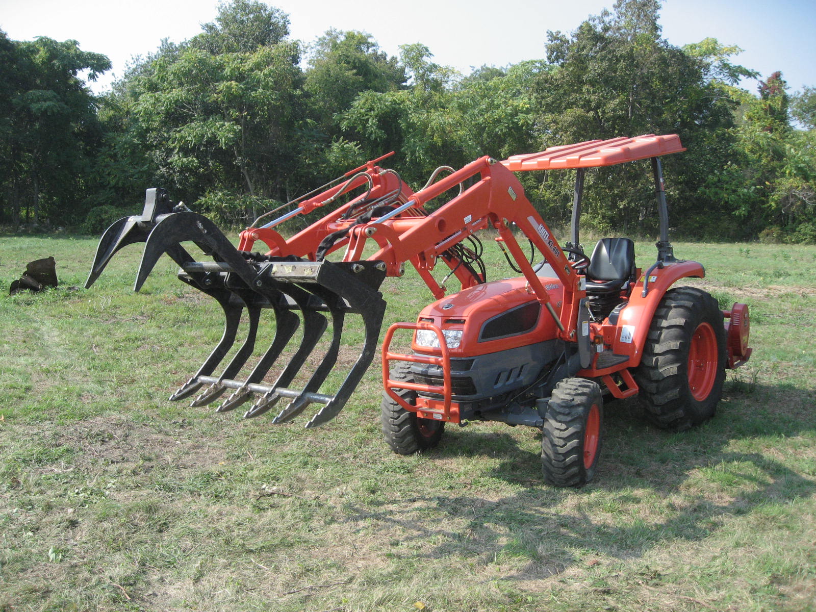

The two basic styles of grapple are also often debated (and the nomenclature describing them is quite confused as both are called root rakes). I tend to use clamshell to describe the grapples with a relatively straight back/bottom tine where clamping pressure from the top grapple arm is absolutely necessary to lift anything at all. The WR Long RBG is a prototype of this style. To me the other style is the OBG from WR Long as well as the Markham, Millonzi, Wildkat etc style where the bottom tines are much longer and most importantly are parallel to the ground so that indeed a load can be lifted without even using the top grapple arm. One style is top hydraulic clamp dependent to fight gravity pulling the material out while the other style actually uses gravity to hold the material in place and the top grapple really just acts to keep the material from falling forward. The RBG/Clamshell type excels at picking up sticks and small objects because the tines are invariably closer together and it functions like a real rake. The OBG style is better for digging and sticking the tines under roots etc as the tines are longer and provide more leverage. Both styles work for clearing brush but the OBG style can carry more logs or big branches because it relies on gravity and has a larger load platform while the clamshell style, just like the 4n1 bucket cannot hold anything below whatever the widest item that jams into the top of the grapple.

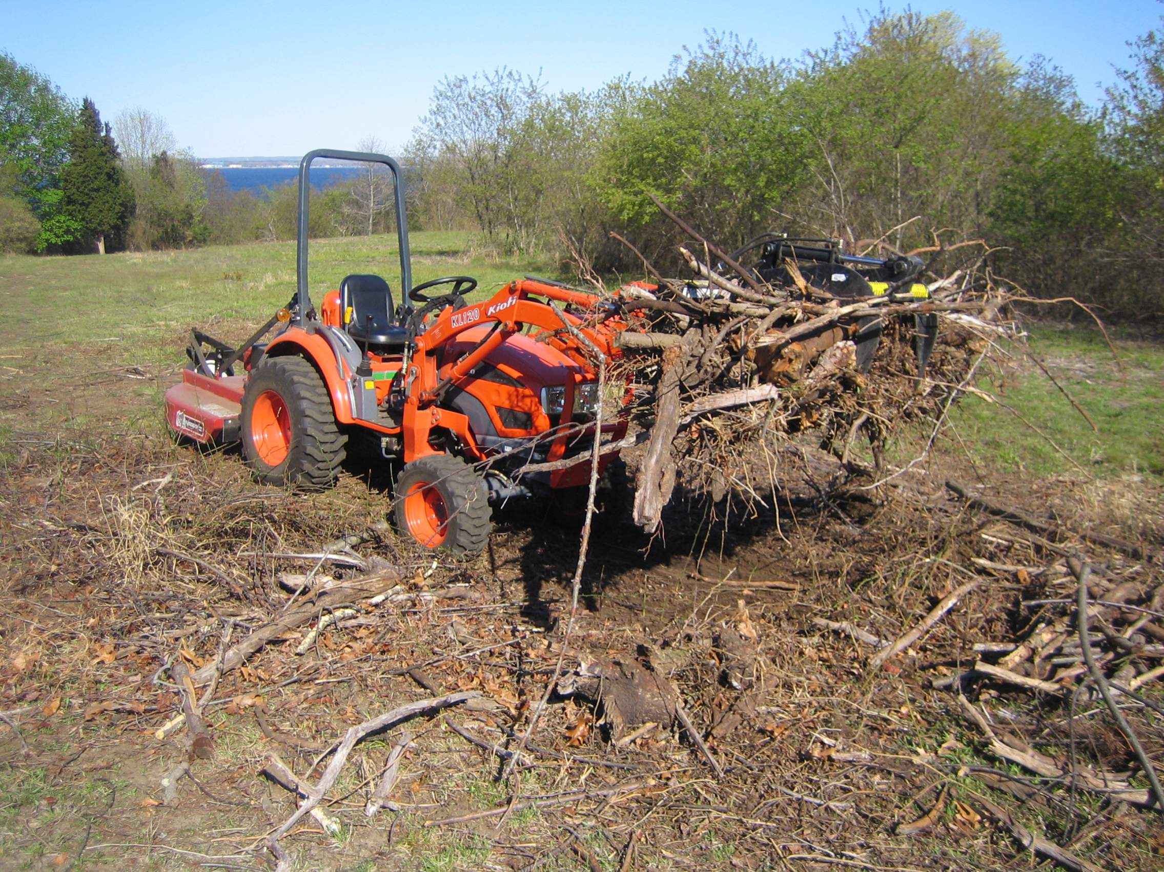

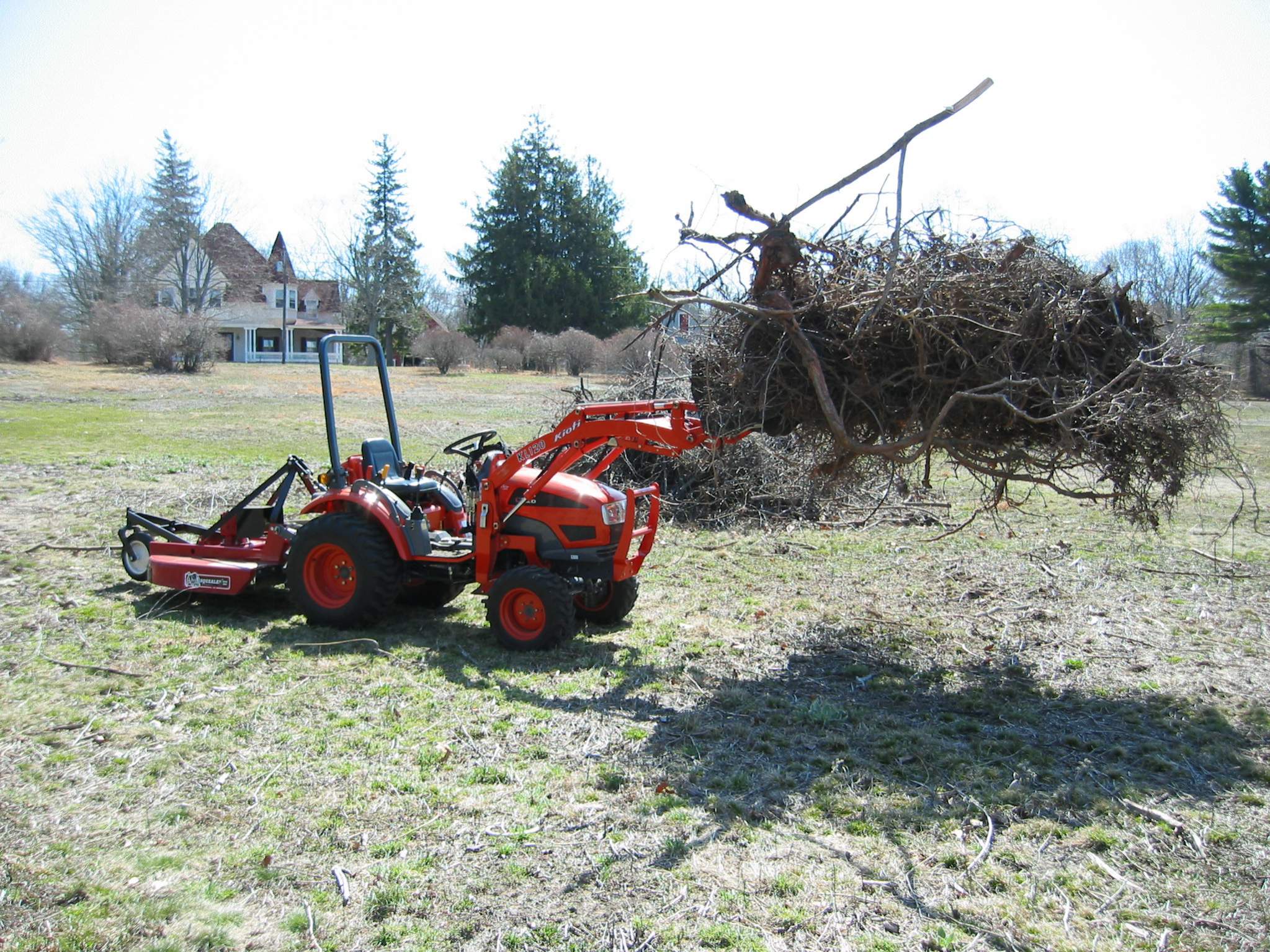

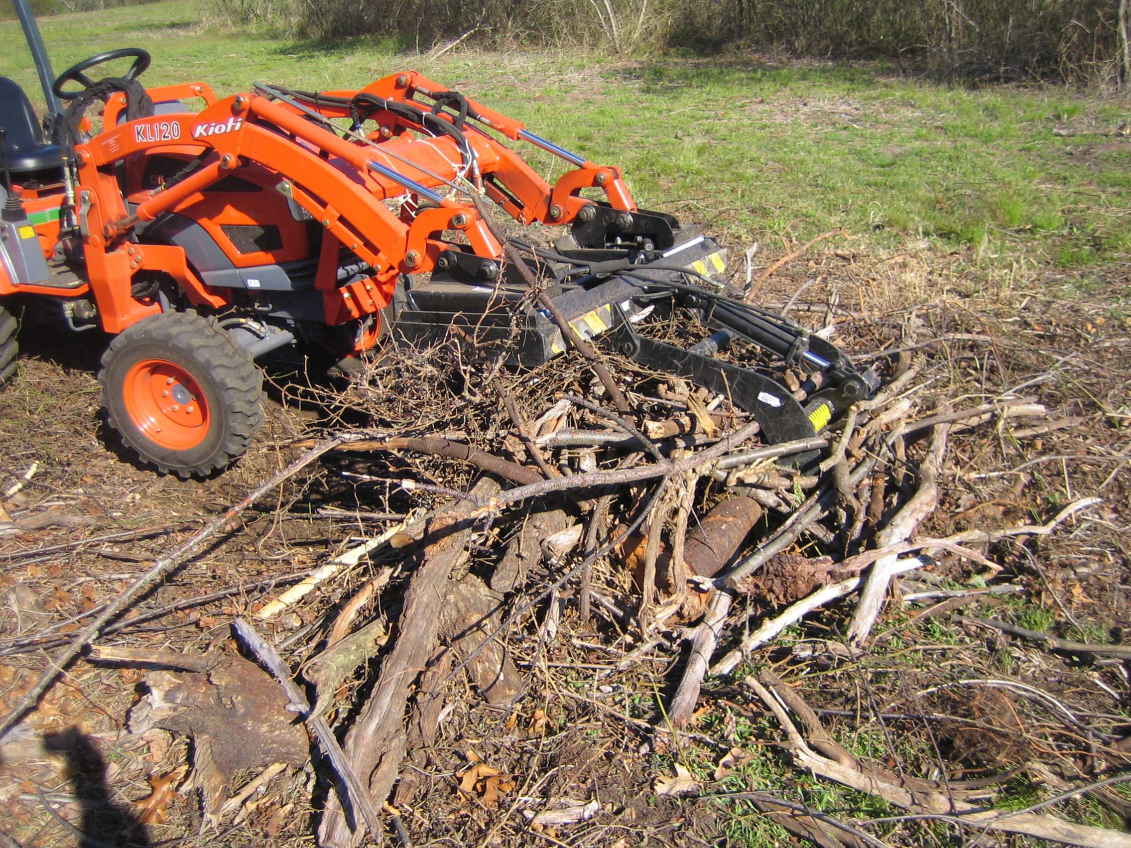

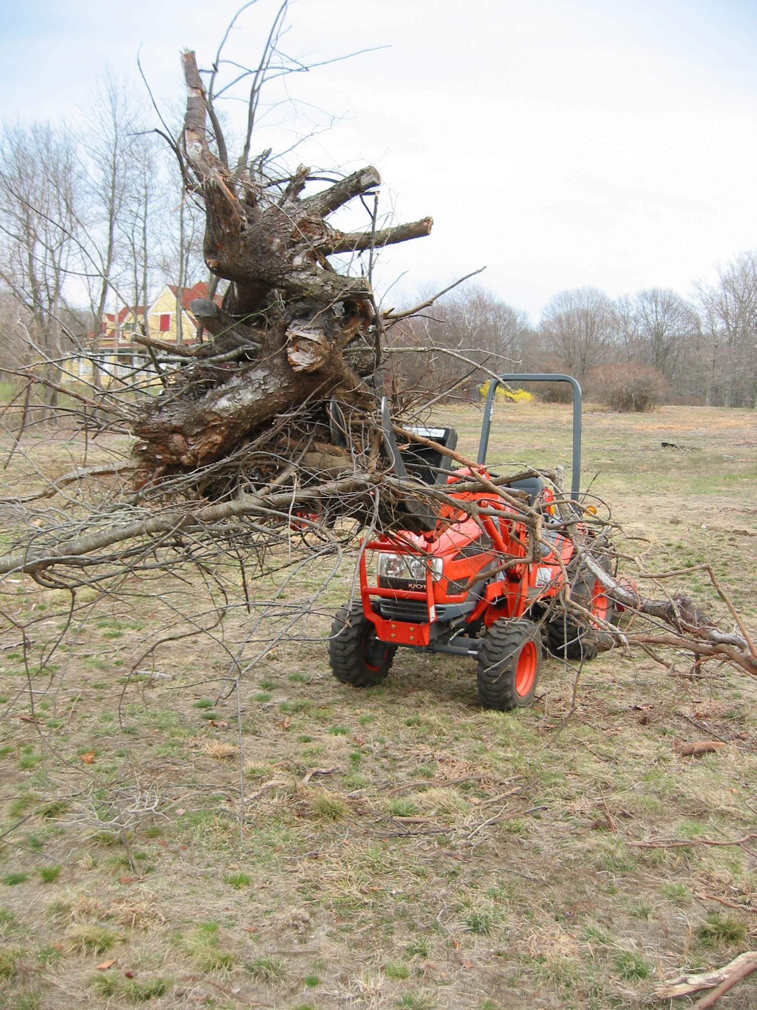

I will answer your last question: can a 48" hold as much as a dual upper grapple wider grapple? Yes. Simple as that. The only potential advantage of the dual upper grapple style is when you are picking up loose short sticks (or construction debris). Any other load is easily managed with a single upper grapple. Why else would our human hands have only a single, rather than double, thumb????
I've posted below a photo that I still think is the single largest load of brush anyone has ever posted here in a CUT grapple. It is in a 48" Millonzi and is being lifted by a 20hp tractor (CK20). The reason the load is so big is that it is brush and includes vines etc which tie everything together. The other photos show awkward loads contained by a simple 48 inch grapple and loads that could not have been lifted if the grapple itself weighed more.

Before you order from Wildkat, make sure they have increased the 4x4 tubing to 1/4 inch rather than 1/8 inch they were using earlier this year. Several failures resulted with the top grapple mount essentially collapsing the tube as I recall. My Millonzi is essentially the same design but has 1/4 inch tube. Millonzi is no longer made but I would question in detail any grapple manufacturer to insure that the square tubing is 1/4 inch. I'd be pretty sure that WRLong will have the thicker tubing but have never checked that. Problem with WRLong is that they force you to go through a dealer and therefore they are not particularly price competitive.
