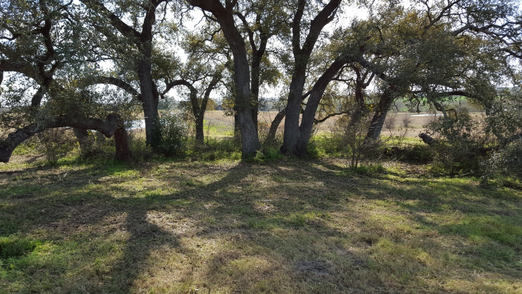

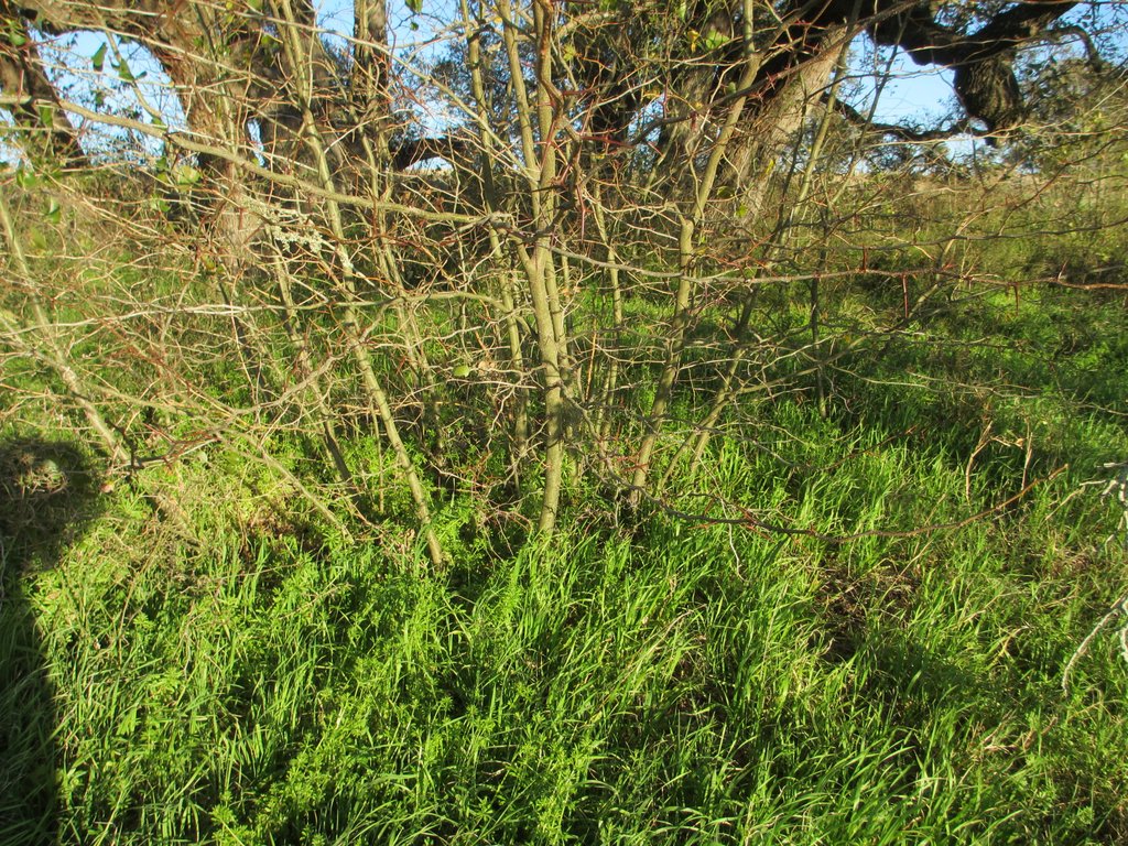

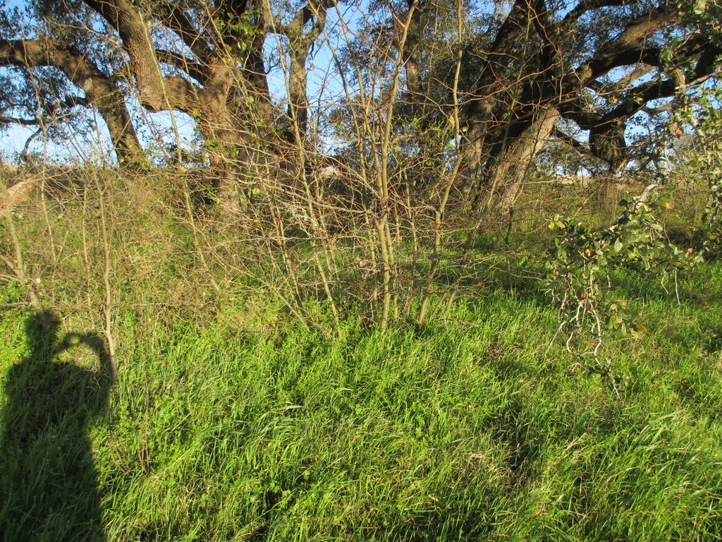

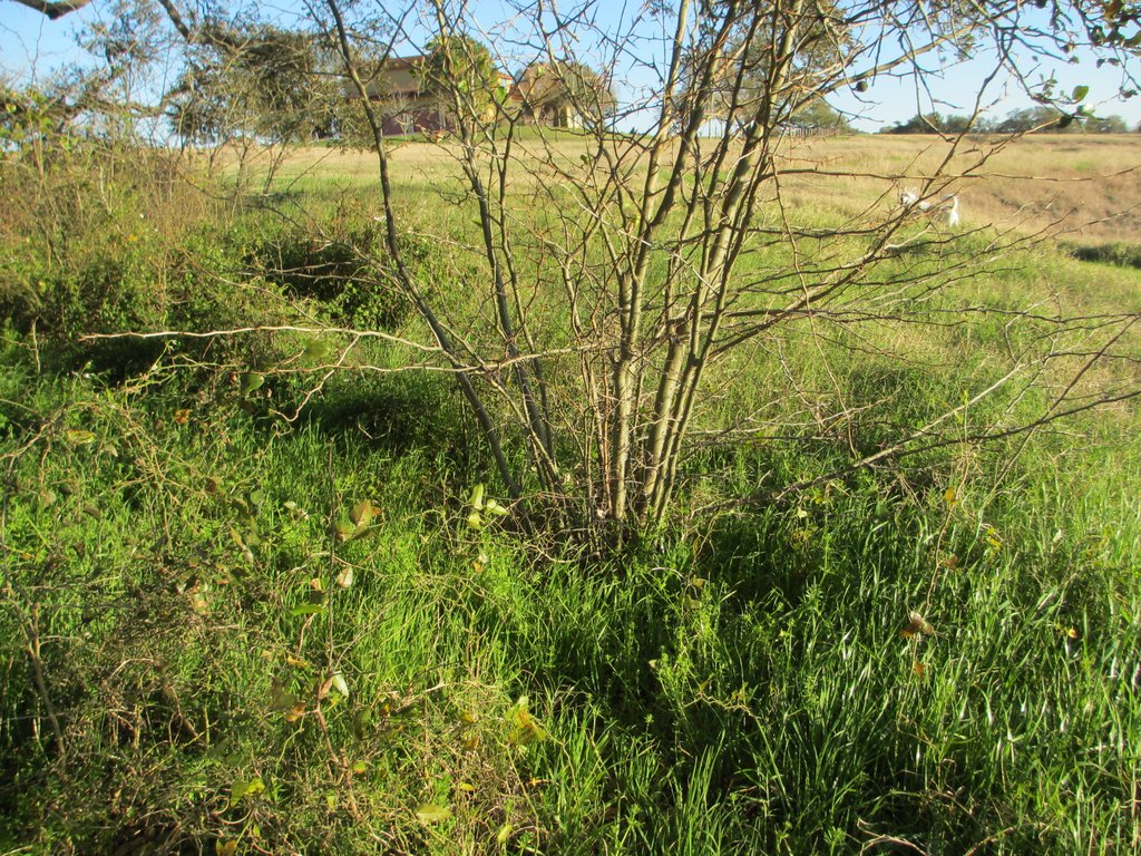

I have a nice grove of Live Oaks that I'm looking to clean under. It has several small trees & shrubs growing underneath, none larger than 2-3 inches in diameter. Can I pull them out with my tractor? I have a Deere 4105, about 42HP.
I'm thinking of using these, one for the small trees, the other for brush. Do these work, and are there any better ways to do this?
Brush Grubber Brush Grubber Xtreme, Model# BG-11 | Weed Control Brush Removal| Northern Tool + Equipment
Brush Grubber Shrub/Clump Grubber, Model# BG-16 | Weed Control Brush Removal| Northern Tool + Equipment
Thanks!
