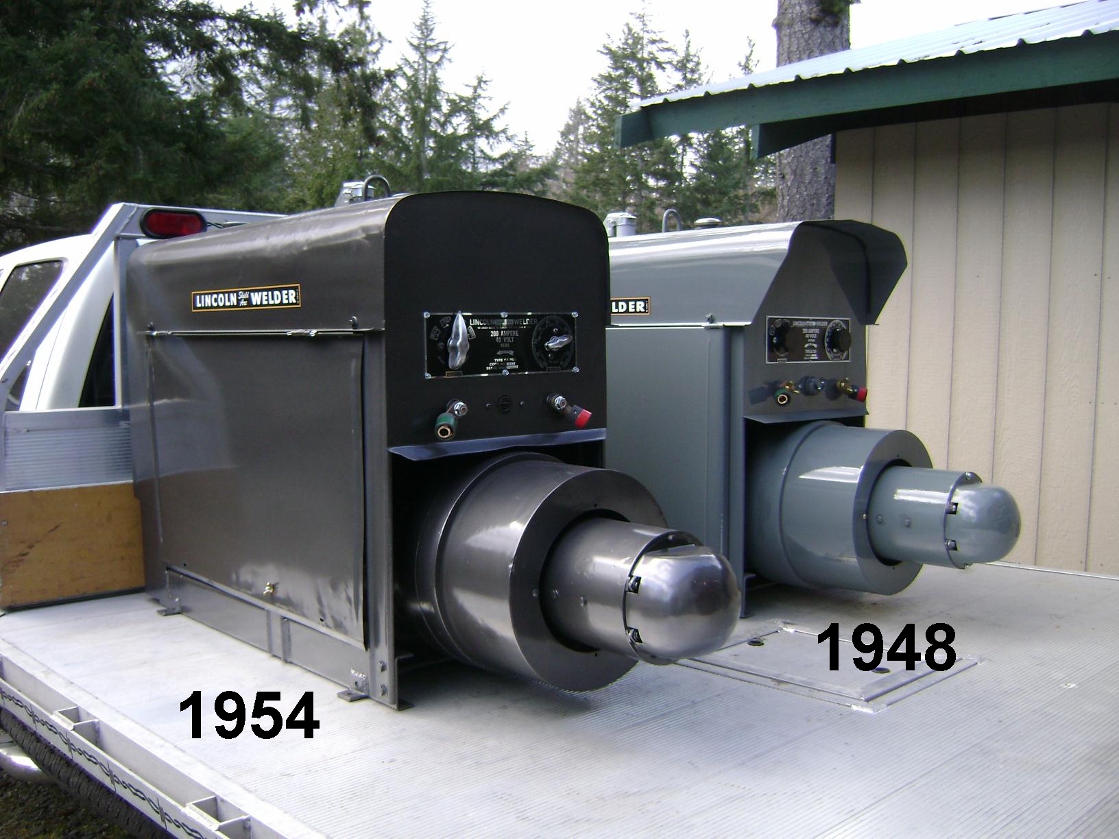

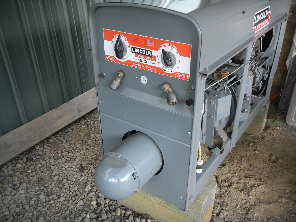

All this money spent on generators to run a welding machine?:confused::confused3::confused3::confused3: $200.00 spent 300-amps capacity.:thumbsup:

Waiting for another one of those to turn up for $200 might be awhile.
*DROOOOOOL*
I wish!!!:thumbsup:
While the true finished cost on your machine is "a little" higher than that ;) - small gas engine welders (like the Lincoln weldanpower 150) are often found around $600 or less near me.
For a running stick welder with approx 5000 watt generator, pretty tough to beat :)
I have one, it's a cool little toy - only $300 for it (it's so small it's almost cute)
....just occurred to me I never tried the little mig on its generator...something for me to play with this weekend ;)
Yes that is very nice and your bad influence may get me in trouble some day.:D
It is not as if you don't have one or two or more to spare but you well know why I asked the question.
Of course that question, for me at least, is totally without a purpose now.:thumbdown::thumbdown:
Good luck finding one in that condition for $200
