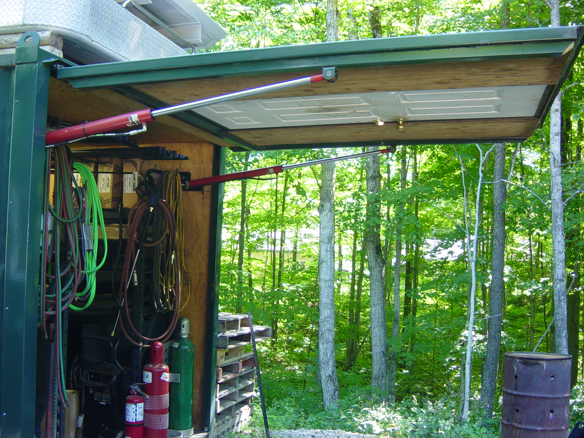

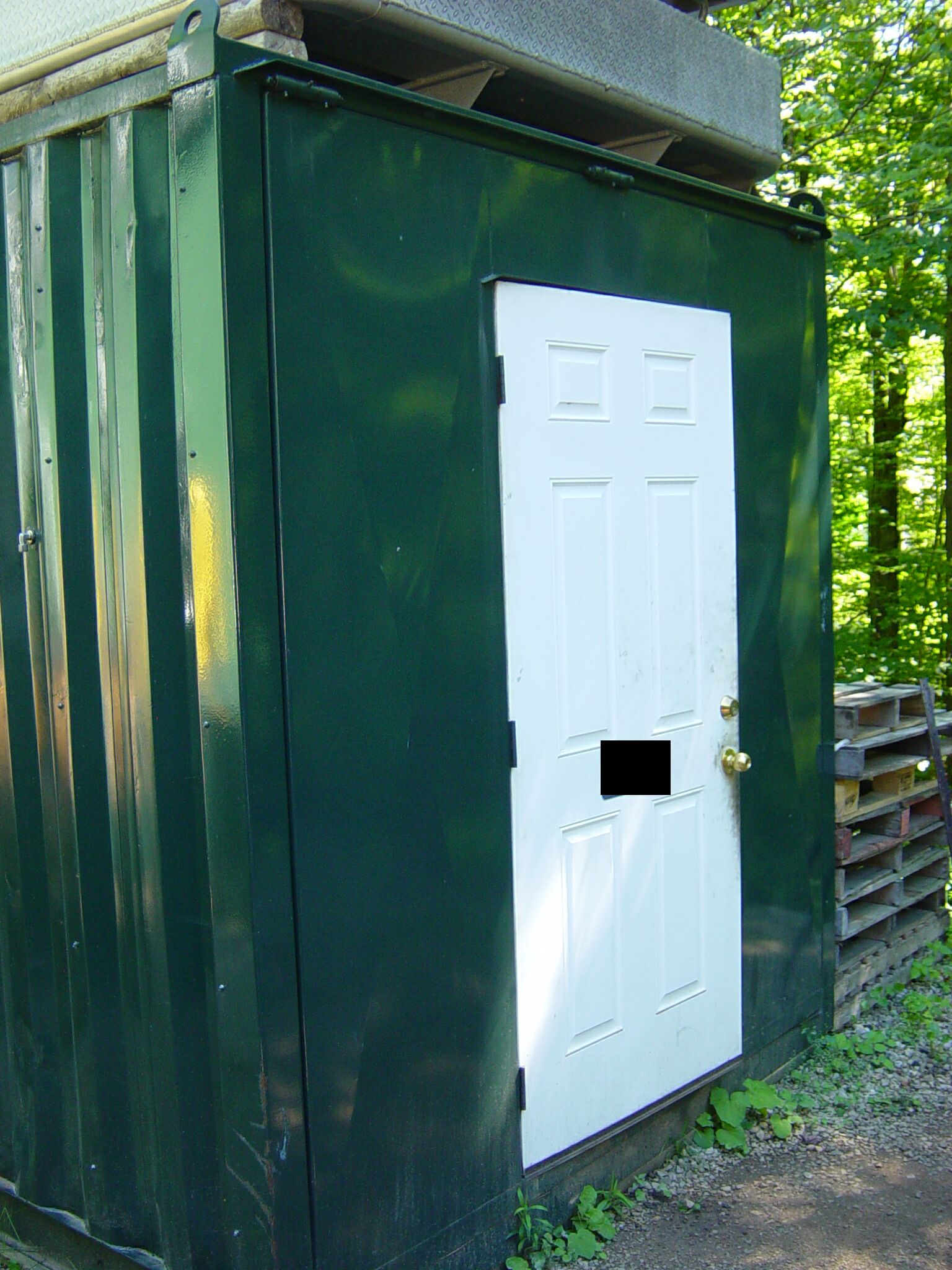

Pictures of my friends container as promised.

Nor a sadistic operator at the controls if you don't quite make it in on time. Cylinders are after all, double acting!
   / Shipping container for tractor storage #85
I wonder why he did away w/ the original double doors.
What he offers is a bit of shade over the steel double originals.
   / Shipping container for tractor storage #86
He cut down a 40 foot and did not get the end with the doors for one. Yesterday, he mentioned that having barn doors would get "OLD". Maybe it's hard to put a man door in one side of a normal door.
OR, I guess, because he can. He is an incredibly talented and capable young man who astounds me every time I go there.

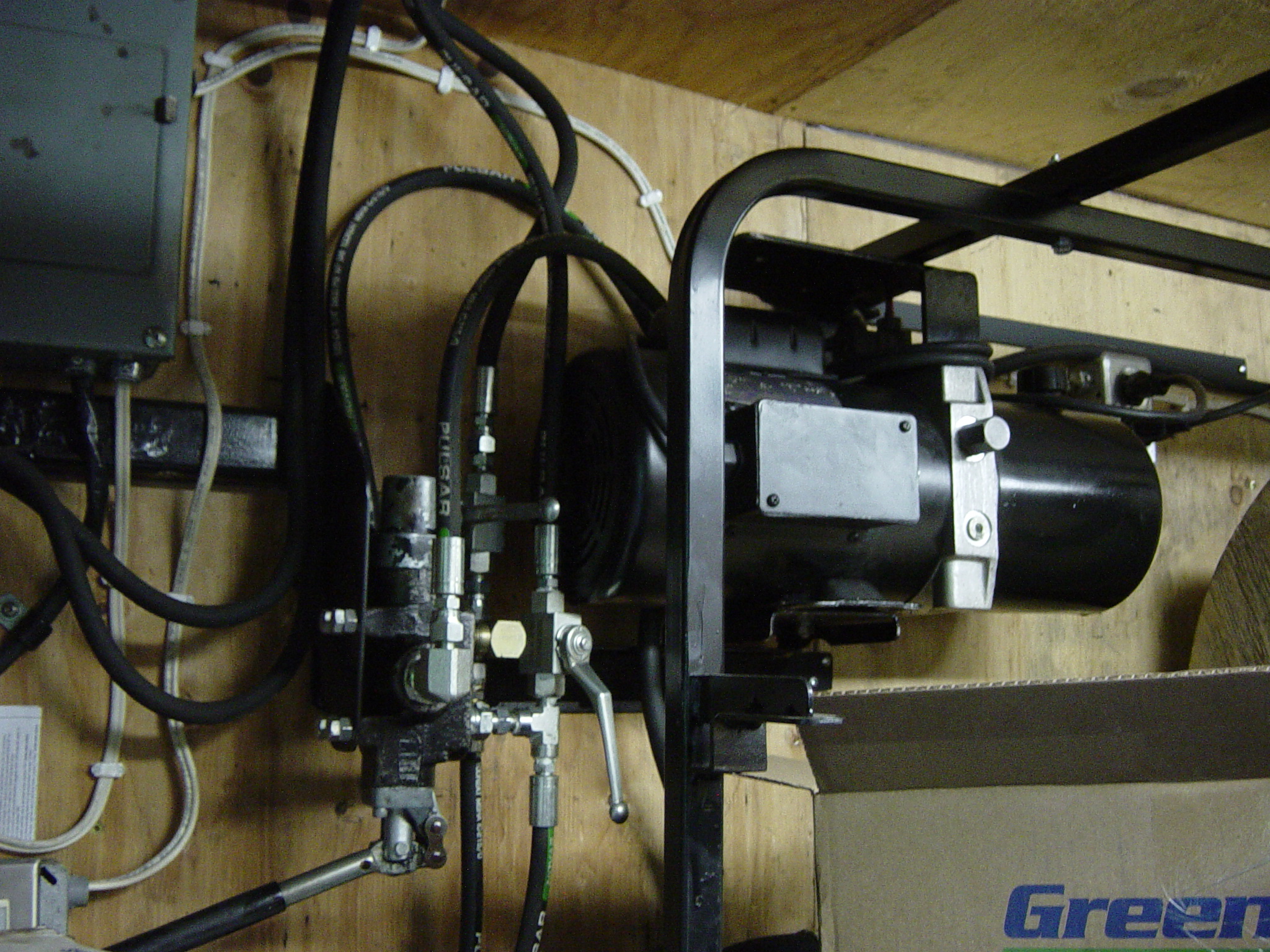

   / Shipping container for tractor storage #88
This young kid does hydraulic hoses, tubing and fittings. He has a better selection and stock than probably anybody in a 100 KMS radius. Maybe more. That helps! Shame doesn't begin to describe how he makes any of the "dealers" around here look! Remember, this is canada. He made me up some stainless hydraulic hose yesterday.

We think he has done a first rate job.
Might have done things a touch different but it works for what he wants.
What is that on the roof ?

What's on the roof? I thought a mattress at first sight. I think it's just some checker plate bed for a truck or something, stored out of the way.

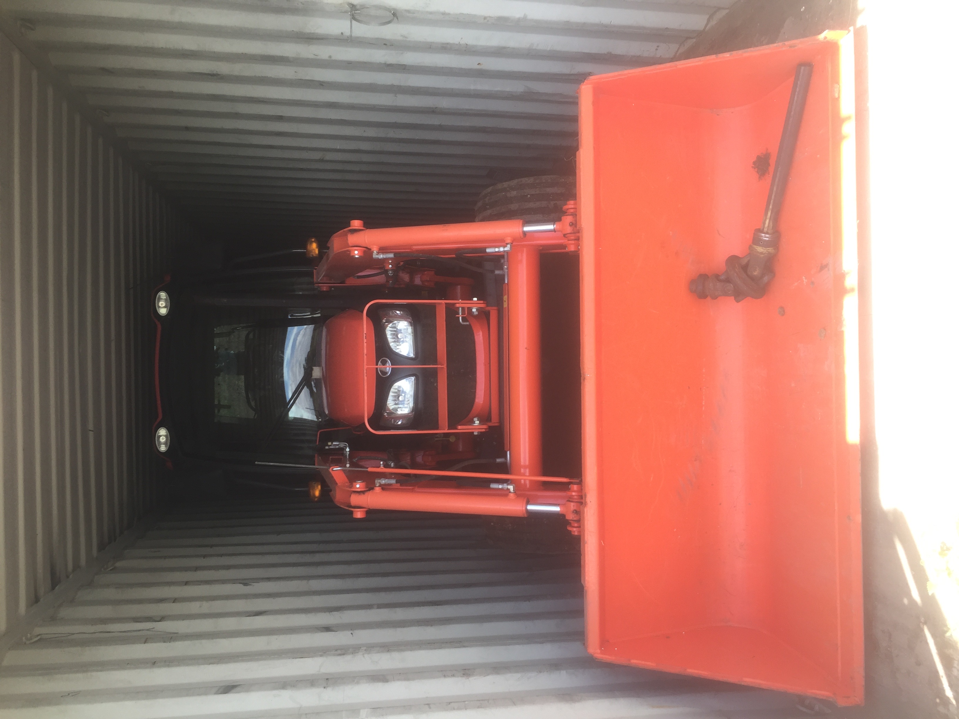

I知 thinking about getting one, too. My tractor (with cab) is just over 8 feet tall. In this case, I need to go with a high cube container. A normal container is not tall enough. I contacted a local dealer and a 40 foot high cube is $5500 plus delivery. Less than the cost of building a pole barn, plus it will be rodent-proof. I just had mice chew thorough some wiring and need a safe space for my tractor.

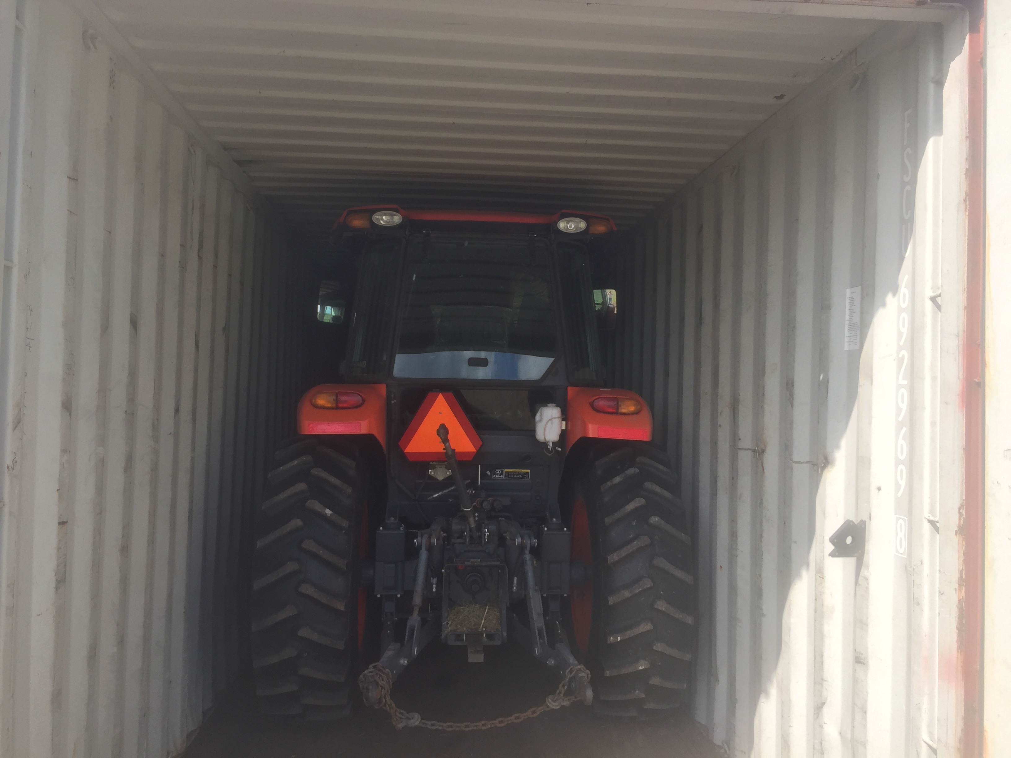

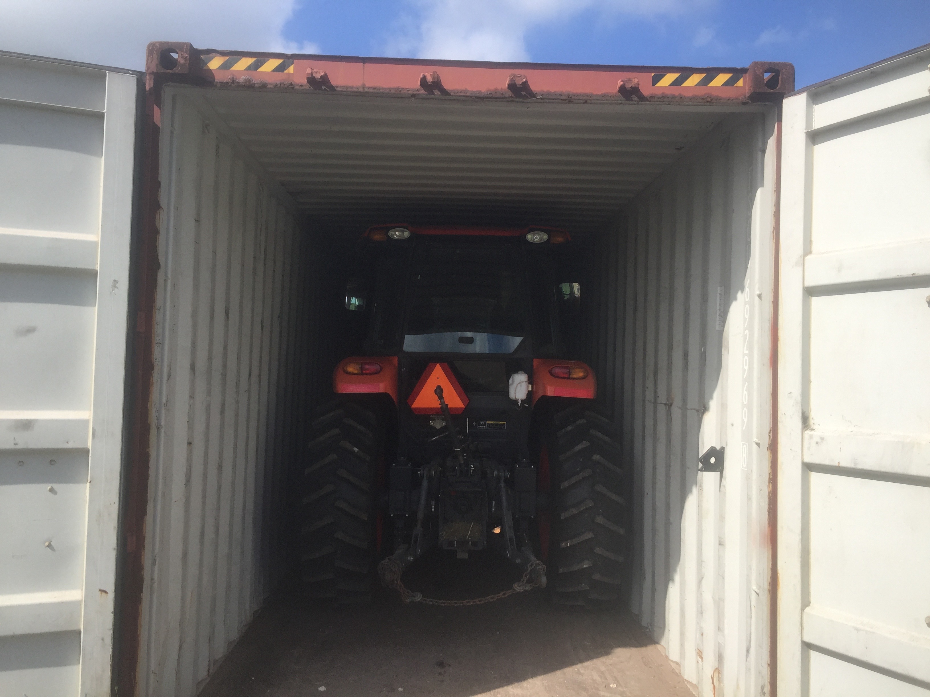

Top of cab at a manufacturers reported height of 100.7in. I measured the entrance at 101.5in

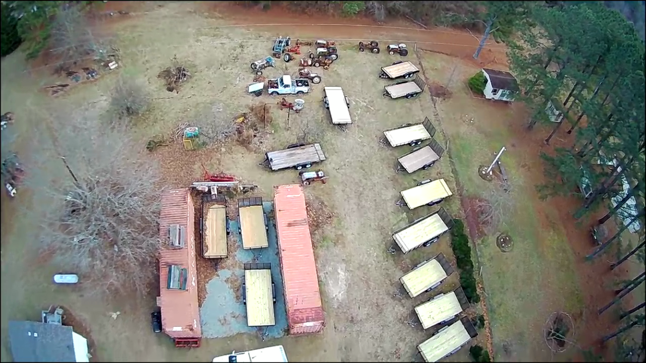

Get a High Cube roof is very high.....I got two 40 ft shipping containers Over 5 years ago HC high cube one half of container is my tool boxes other half is a 8 N ford tractor. An hour after they dropped it on the ground I had it blocked with my forklifts help and moved in all my tool boxes too and dropped in a few drop cords for power and a gas 20 LBS propane bottle with heater and presto instant work shop work with lights $2200 deliver from wilmington NC Tiger Direct .com A few days after I bought the first one they dropped the price a $100 so I had them bring another one USED of course new was like $5200 with $400 shipping..or so... My other containers has anywhere up to four ford in it at any given times ford 3000 ford two of the 8n's and a John Deere 1944 They are too hot to work in during the summer if left in the sun between 10 am and 5 pm ..... ZERO regrets on my shipping containers !!! Animal & Bug proof water proof very secure buy a heavy duty Master lock for one or both doors and privacy proof no one knows whats in it...

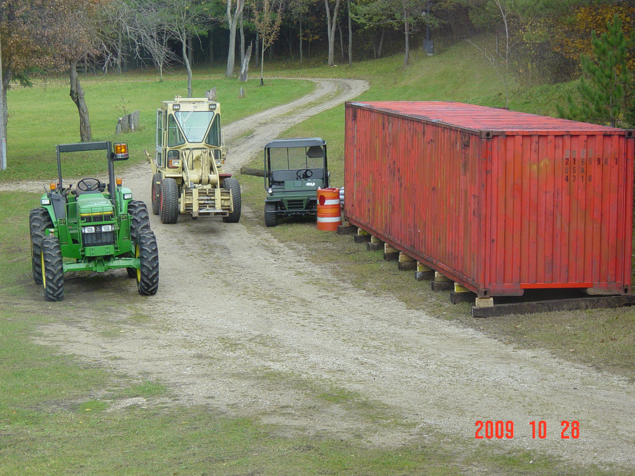

I worked for a retail company that used these for excess seasonal storage. I usually was the person to purchase and locate them on property.
If you get a good container that doesn't leak it will last for many years....painting the top with mobile home coating will reflect the heat and help keep it dry.
The only word of advice I can offer is put it on blocks to allow air flow beneath. If you set it flat on the ground it will sink. Not much, but enough to hamper door fitment create a depression in the ground that will trap water.
After that happens rainwater will collect and stay under the unit. When that starts your floor will begin to rot along with the steel structure holding it up.
Keep an eye on the humidity in the container. If the walls start to sweat you have a problem that you must take care of.
Setting it directly on the ground may seem very handy but it is a sure way to start the rust and rot issues.

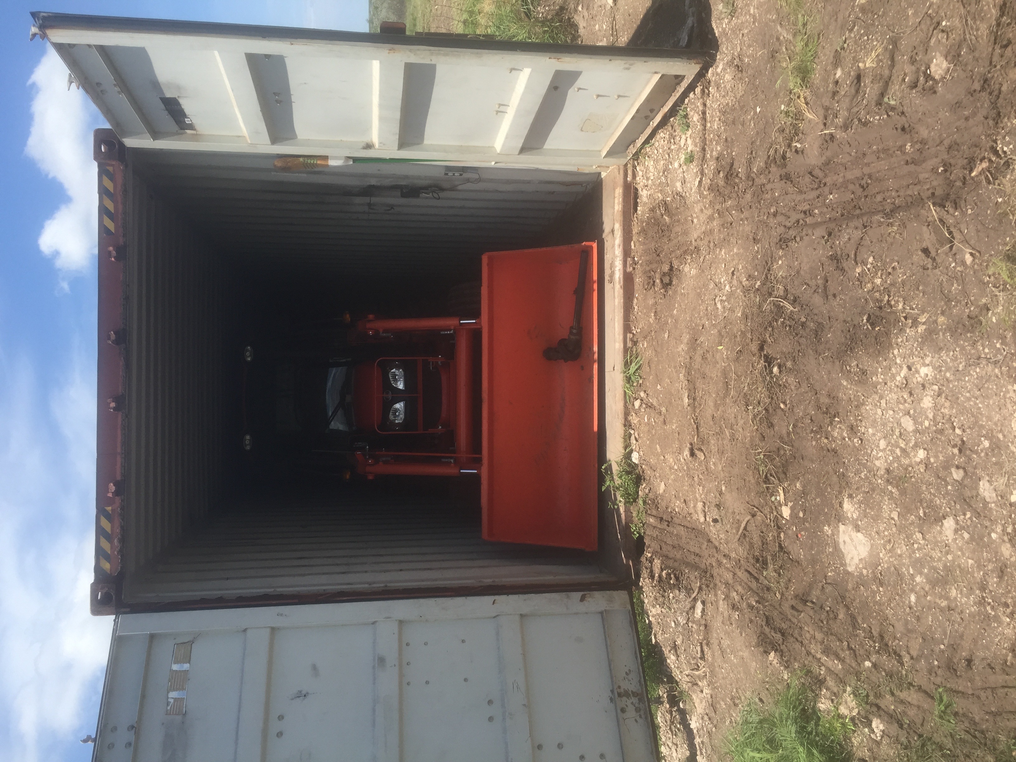

How hard is it to get out of the cab?
   / Shipping container for tractor storage #100
Im toying with the idea of a shipping container for storing tractor and other equipment on our new property. The ID of the container door is 101.5 tall at its smallest point. Specs for the tractor im eyeing are 100.7in tall with Ag tires. I have no way to test fitment before purchase......
Thoughts please.
