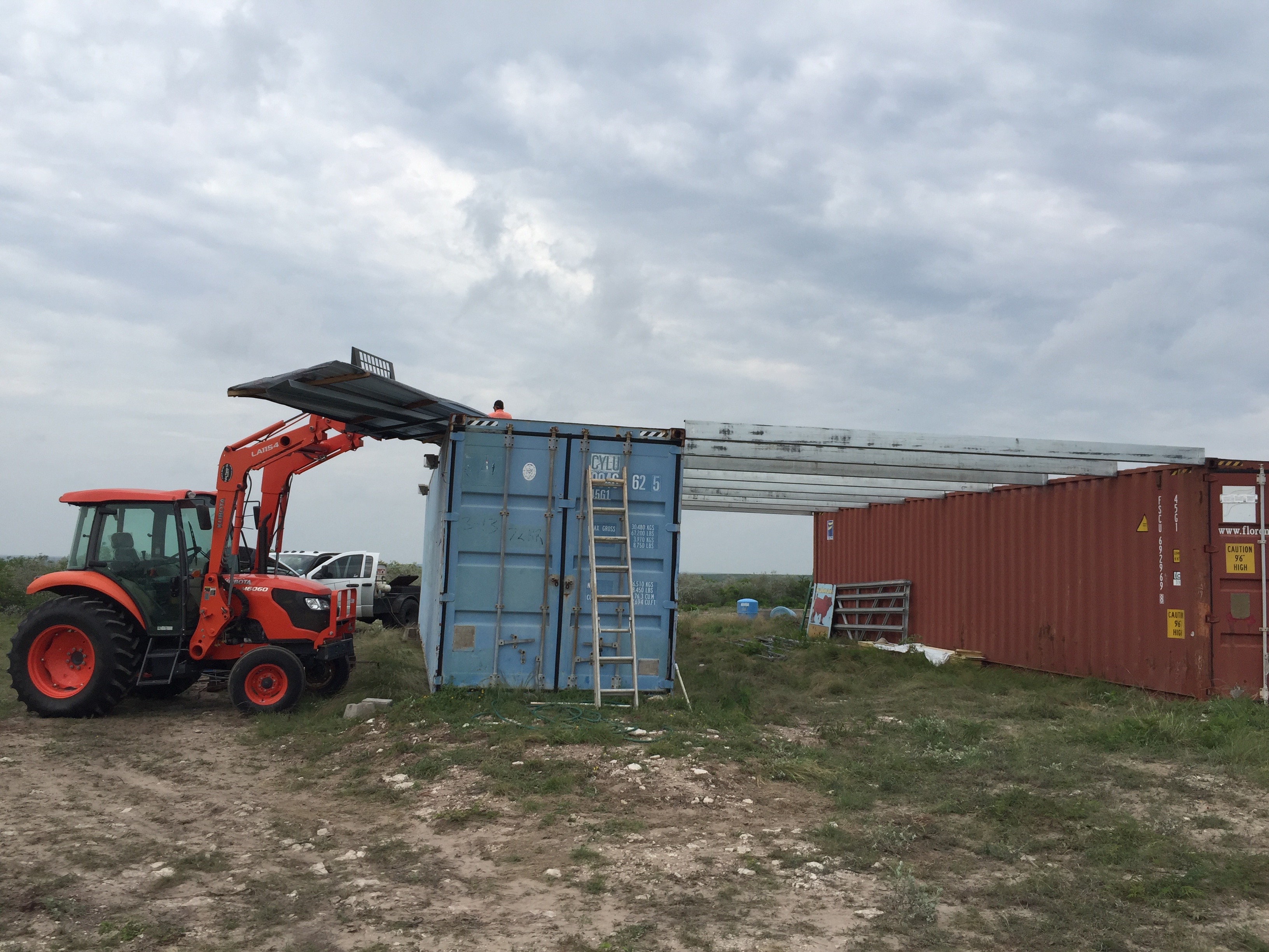

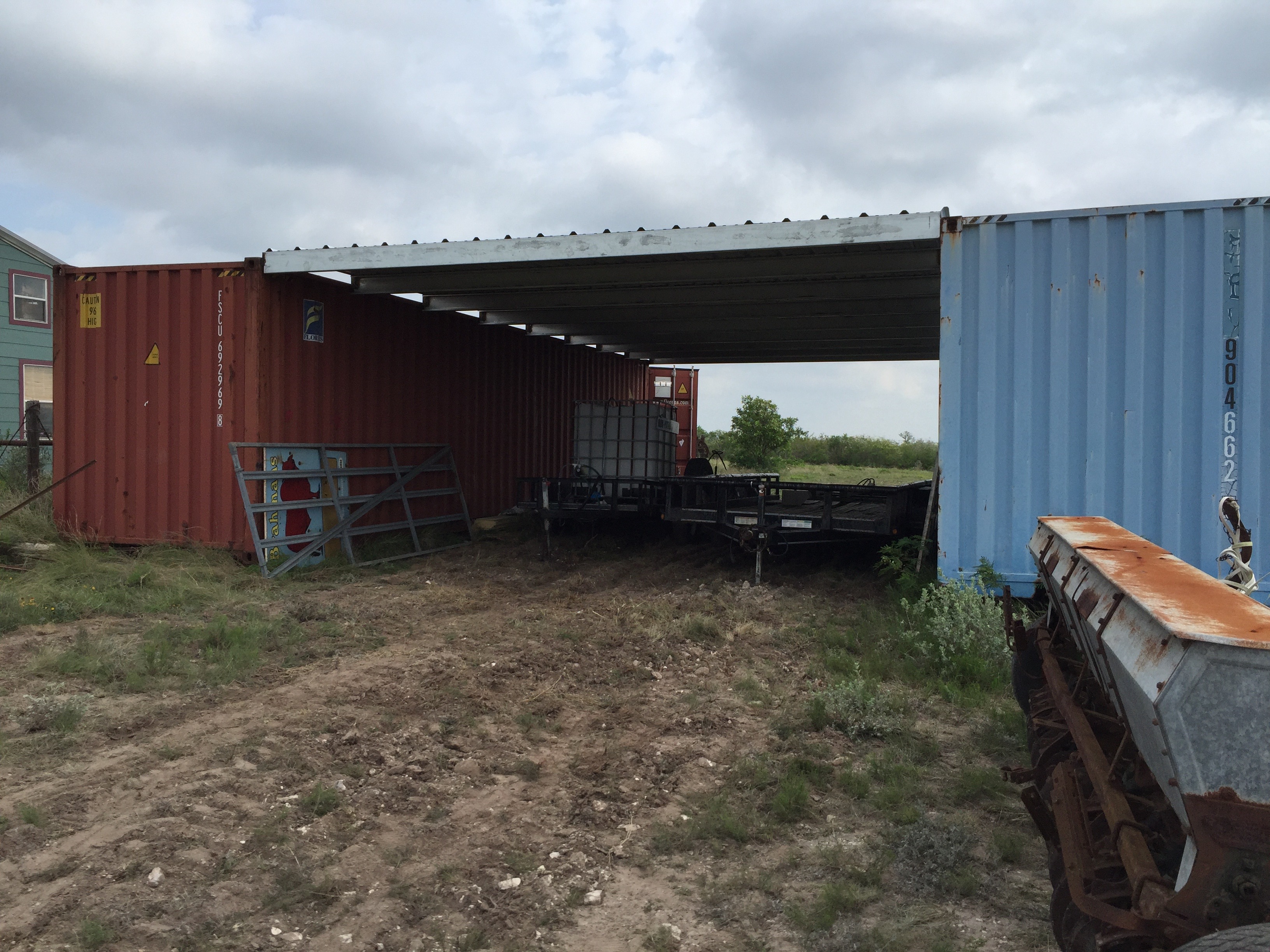

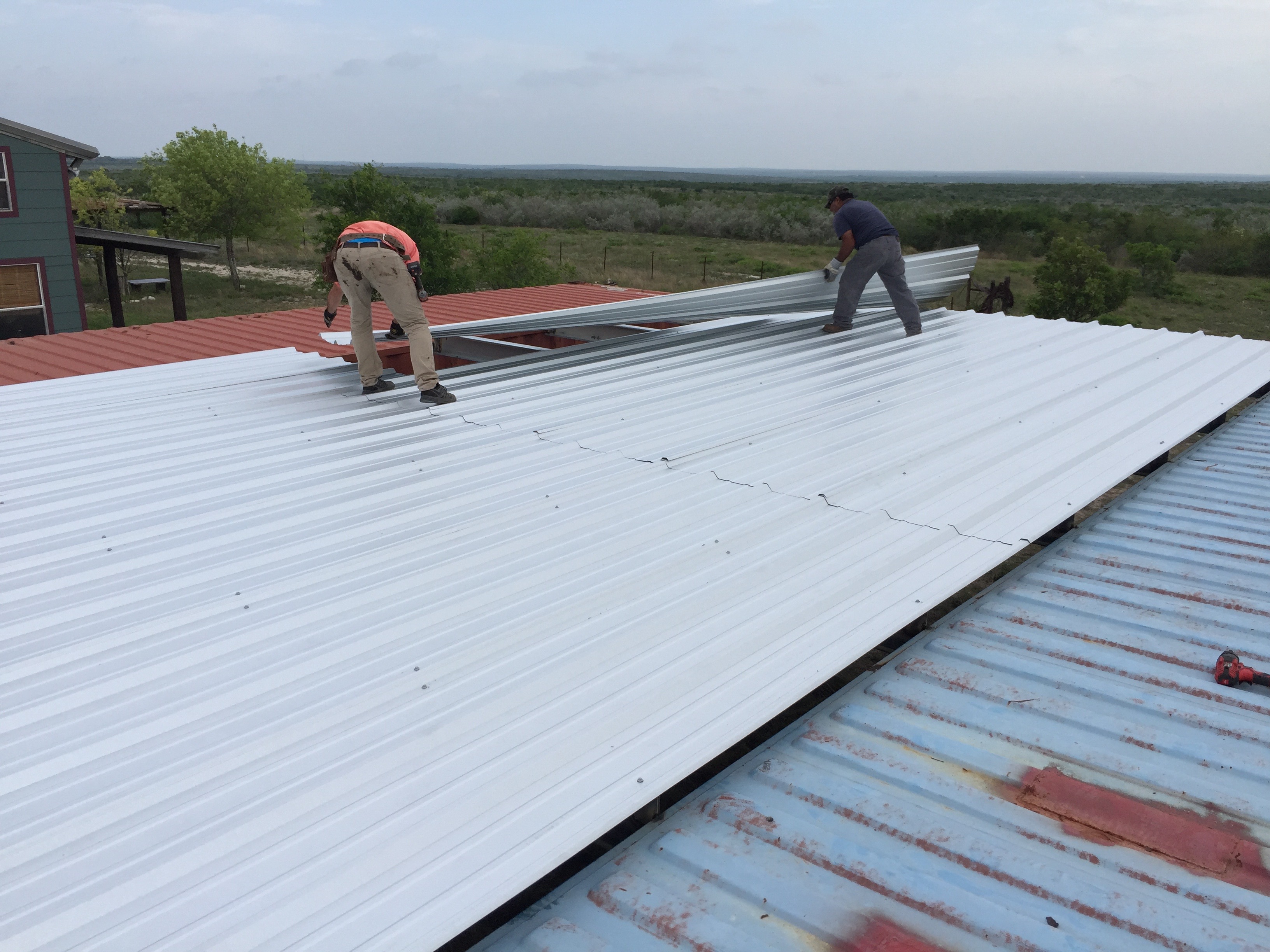

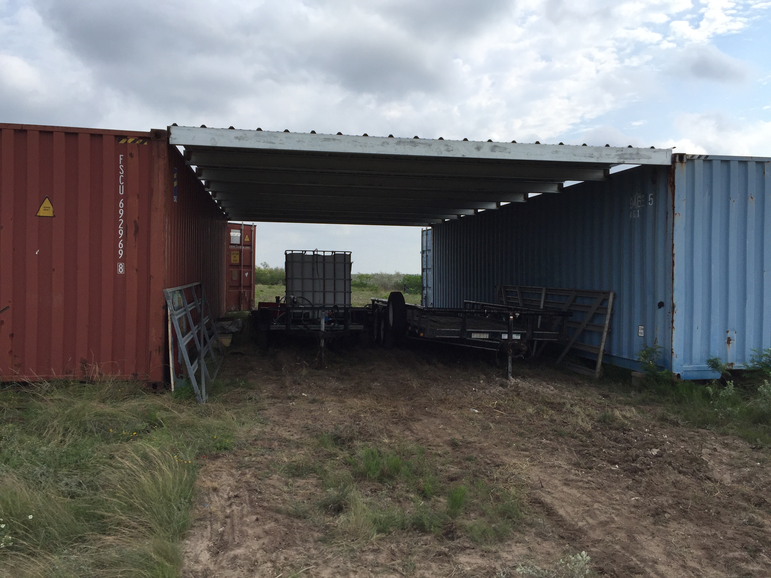

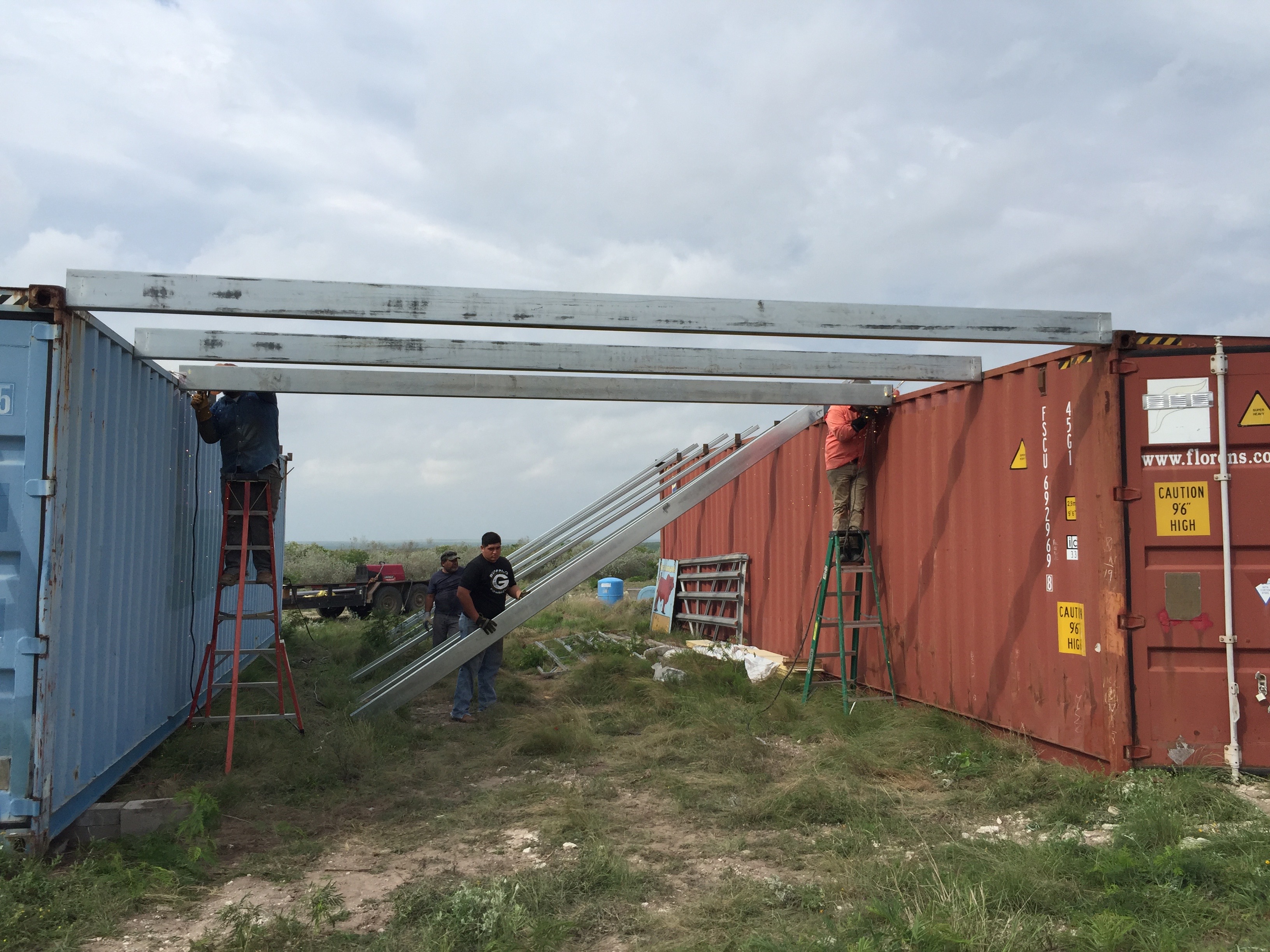

We just finished getting a roof installed on our 40' high cube containers with doors on each end. I keep my Kubota M62TLB , MX5800, and my F2690 mower in them as well as a sprayer & spreader. They fit perfectly and I don't have to worry about mice eating all of my wires again any more. With the roof it was still the cheapest 50x40 barn I have ever built and, from what I am told, it might not increase my property tax bill since it is portable. Not sure about that one yet.

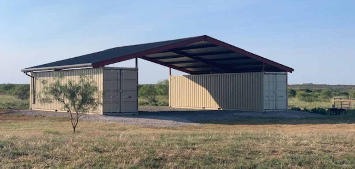

Has anyone considered cutting the side open so that you would have drive in bays - not as deep as they would need to be, but two sea-cans deep would provide the depth - this arrangement would be similar to a machine shed sort of deal - what's the thoughts on that
   / Shipping container for tractor storage #119
It is not all that much work to slice part of the roof off (plasma cutter and Sazall), extend the walls as needed, and reattach the roof. You don't need to raise the roof over the entire container just the open end and into the box far enough to clear the tractor when it is pulled in far enough to close the doors.
