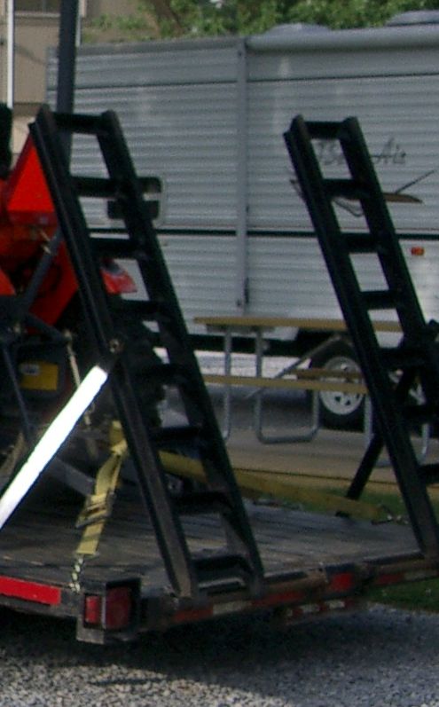

I built mine 5' long with 2" c channel & 1 1/2" x 1 1/2 " 1/4 " angle. I haven't loaded any thing much heavier than a car or my ck 20 but htey are standing up very well.

Mine are 2 x 3 inch 5/16 angle with the 3" lip vertical by about 5 ft long and 12" wide.
Used 1/2 inch rebar to make spreaders and got lucky in that the recyclers had 12" wide X 8ft strips Heavy duty expanded mesh that I welded for traction surface.
The ramps are about 5 ft long and easy to handle one by one but not the pair, so I'd guess 50-60 lbs each,
My tractor weighs about 3200 lbs or so and I get no deflection when driving onto the trailer.
I do, however need to place legs under the trailer as otherwise I can practically lift the truck rear end by the hitch.
I shaped my ramps so that I have a lip that hooks onto the trailer rear end. (don't want to have the romp slide off of the trailer when climbing in!)
Once the tractor is loaded I slide the ramps between the wheels.
In fact I have loaded my tractor into my 3/4 ton pickup many times as well (without implements or FEL)
