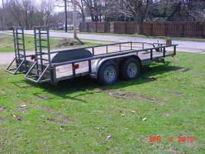

My ramps are made out of 1½" X 1½" X 1/8" square tubing. There is number 3 or 4 re-bar welded on the cross pieces for traction. They work well and can easily support anything that should be on the trailer.
