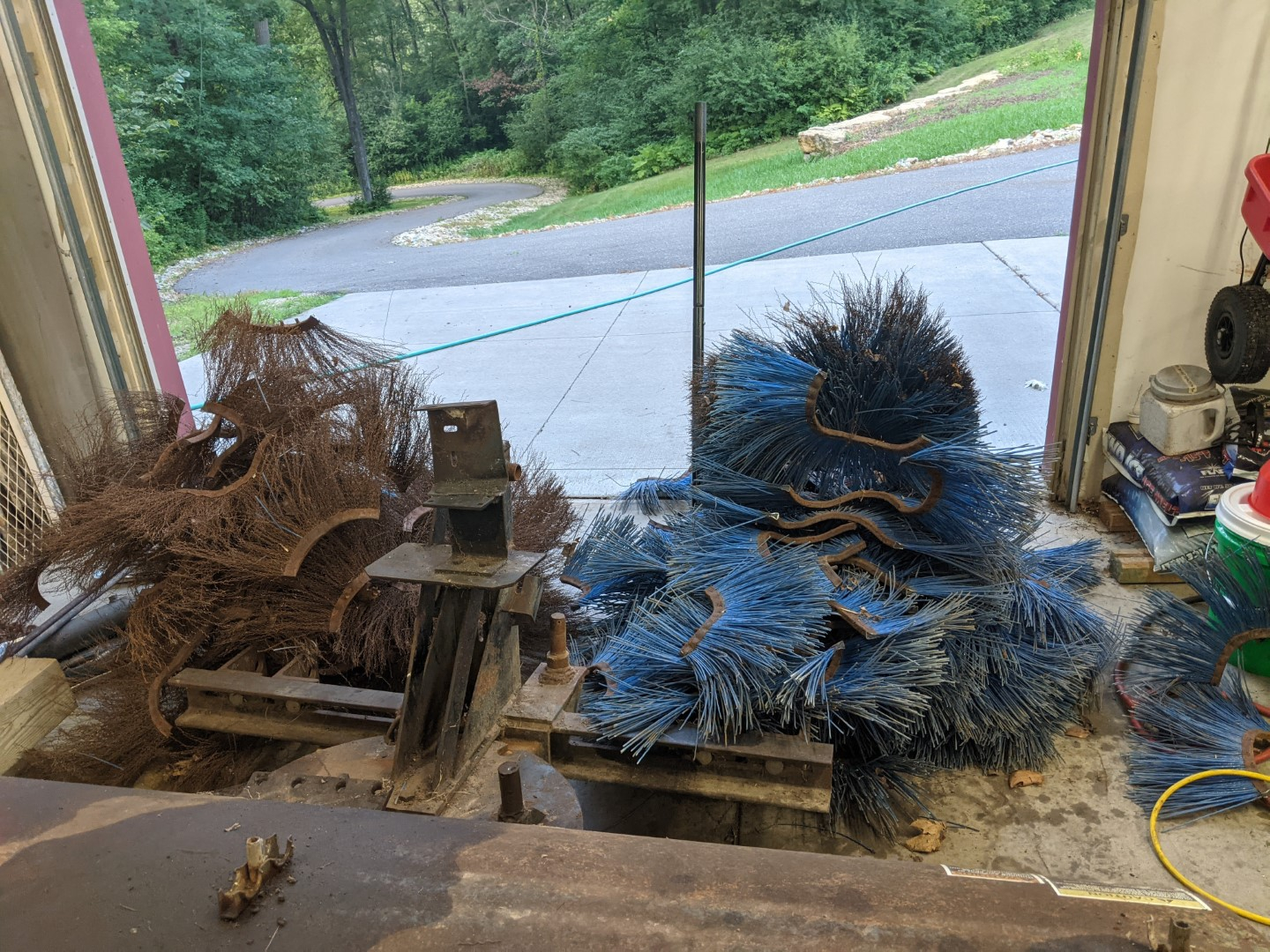

Well when I called the factory with a few questions one thing they said was you don't want poly/wire mix for residential use as the wires get stuck in everything (and eventually probably your tires too), so I was planning on getting rid of that (this one was 50/50 poly/wire as purchased). Well I found another reason to avoid wire - impossible to take apart. They tell you to take off the end cover and start sliding the sections off to change the broom. Riiiiiiight. The wire sections tangle together and it is utterly impossible to break them loose. I ended up having to chop them into sections and then cut through the tangle of wires to get them off, bit by bit. The poly sections came off reasonably but the wire ones were impossible. That was a lot of fun.
But here is the bare core now. Just need to get the motor off now (rt side). Got the nut off by some miracle but the shaft is wedged/rusted in pretty good. Soaking in penetrating oil for now and will probably get the air hammer/chisel involved tomorrow. Maybe some heat if that doesn't do it.
And the pile of broom bits. The plastic ones will go in the trash but the metal ones can go in the recycle bin (which is free!). The last few sections came off as one clump which saved a little time.
That was truly awful. Fortunately I'm guessing the last time I'll have to do it in my lifetime... Amazed I didn't start a fire with all the dried leaves, grass and such embedded in all this coupled with abrasive cutoff wheels. Tomorrow - to the dump with old broom chunks!

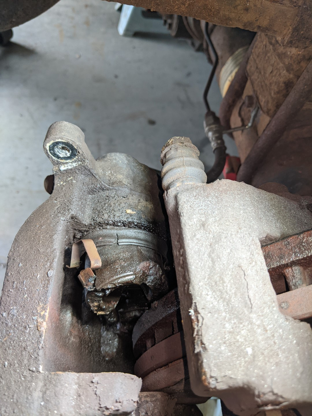

Well something is always interfering with progress... I went to load up the truck to haul the scrap broom parts and the brake pedal went to the floor and I saw fluid at the rear passenger side wheel and then found this mess:

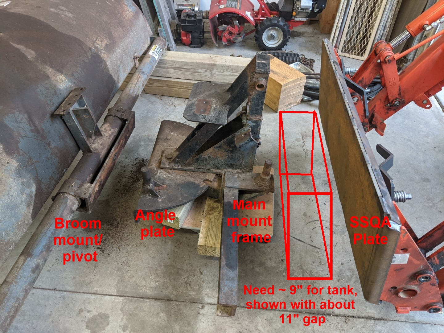

So with that fixed it was time to wrap up the disassembly part of our saga and start figuring out what to do next. That just happened tonight. In the pic below you can see the main pieces of this. That angle plate/frame in the middle was just pulled off the broom mount on the left before the pic, so that will go right back together later. The angle plate pivots the sweeper on that pivot bolt in the center via the cylinder from earlier pics on those 2 large pins in the foreground. The right side of the pic is where the head scratching starts.
I will be making the tank, and it needs to fit in between the SSQA plate on the FEL and the frame. I also need to figure out how to mount the main sweeper frame to the SSQA plate while still allowing room for the tank. I've run some basic volume calcs and there are a variety of configurations that will do it. Something around 36x18x9" will do it. The upper part of that A-frame on the main mount was a hack added on by a previous owner that will no doubt be coming off, but that will come later once I figure out what I want to do. The SSQA plate is 45" wide and the heavy channel on the main frame mount is currently ~52" long and it has some slots in it for brackets for a 3pt mount that you can see in the previous post if you zoom in.
So I'm open to suggestions here. I want to keep it as close as possible but the tank has only one reasonable place to fit, so I need some structure to bridge around the tank. It would be a little easier if that angle cylinder pin was not there, but I'm not sure moving it is a good move. I may need to replace it as it was also hacked on there by previous owner. Also welding the tank leak tight is going to be enough of a challenge to my welding skill set so no need to make it more complex than a basic box.
So let's hear your ideas, TBN! I'll keep noodling on this myself, of course.
   / Sweepster Rotary Broom - rebuild and modification #33

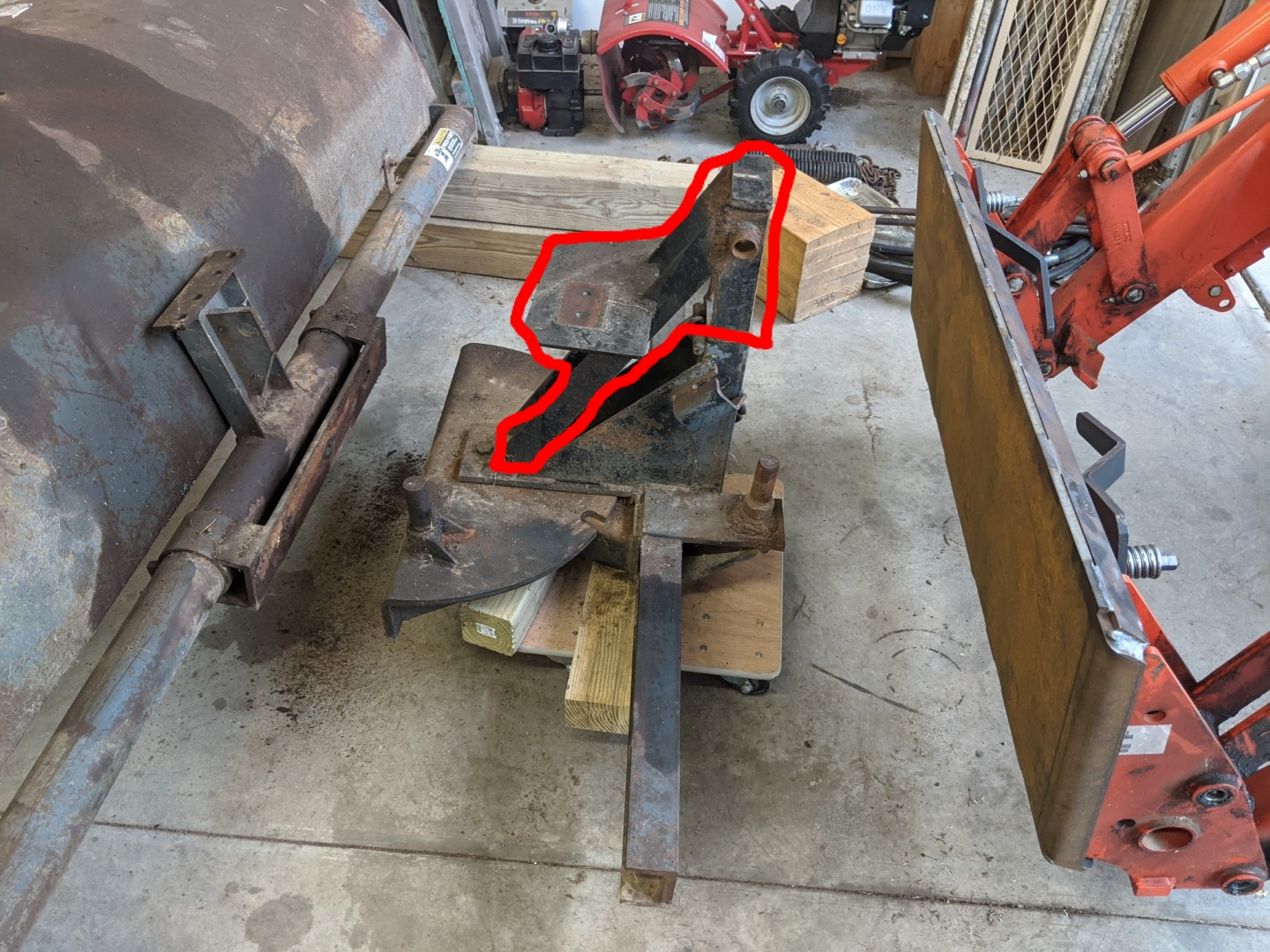

So my 1st question is why does the tank have to go between the SSQA and the main mount? If you are going to remove the "A frame" anyways why can't the tank go in that spot? You might need to mount it a bit higher then but it's not going to restrict any visibility if it's mounted higher. You could also then build more of a square box for the tank. You might need to angle the front corners of the tank to leave room for the broom when angled. I'm not there so it's not as easy to visualize how everything fit's together.

Thanks for the ideas. I think it would sit way too high there, but I can look into it more. The A-frame is part OEM and part hacked on. If you look at the vertical upright, a little over halfway up there is a weld going across it. That weld and above was hacked on. And then those 2 braces going forward with the plate to mount the valve were part of the hack. The rest of it is OEM and should probably stay by all rights. No time tonight but tomorrow I should get a chance to look into it more again. The parts in the red outline are the hack that will probably get cut off.

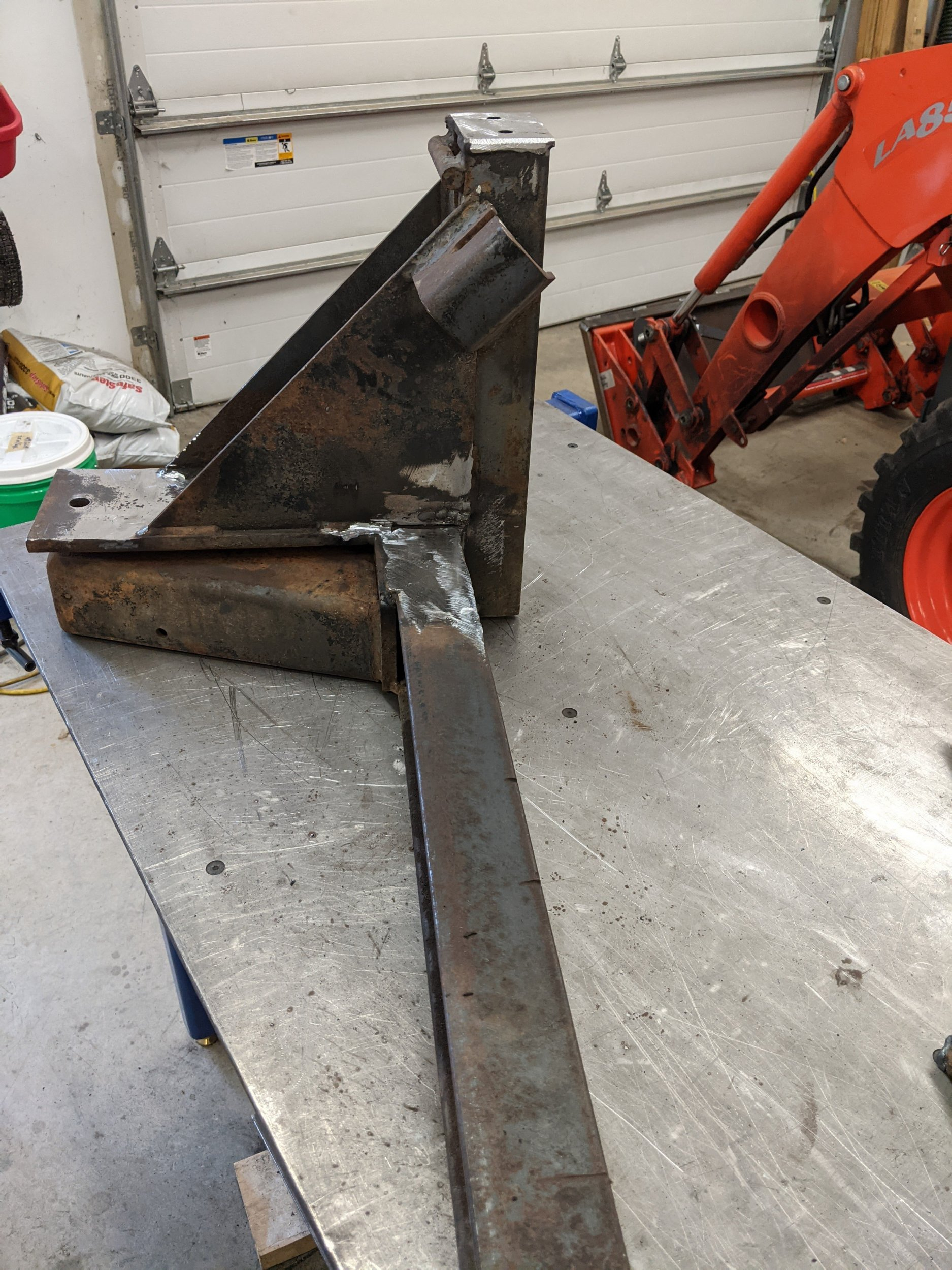

Many things getting in my way on this but I am getting back to it more seriously. I did a bunch of design what-if's in CAD to help sort out some issues on how to plumb all this and deal with component placement and tank design. Now that I think I have that all settled I have started to dig into the modifications to the existing metal and repairs, etc that need to be done before I can move forward.
So here is the main frame before I cut it all apart (sort of, it is already cut but this mostly shows what it was like).

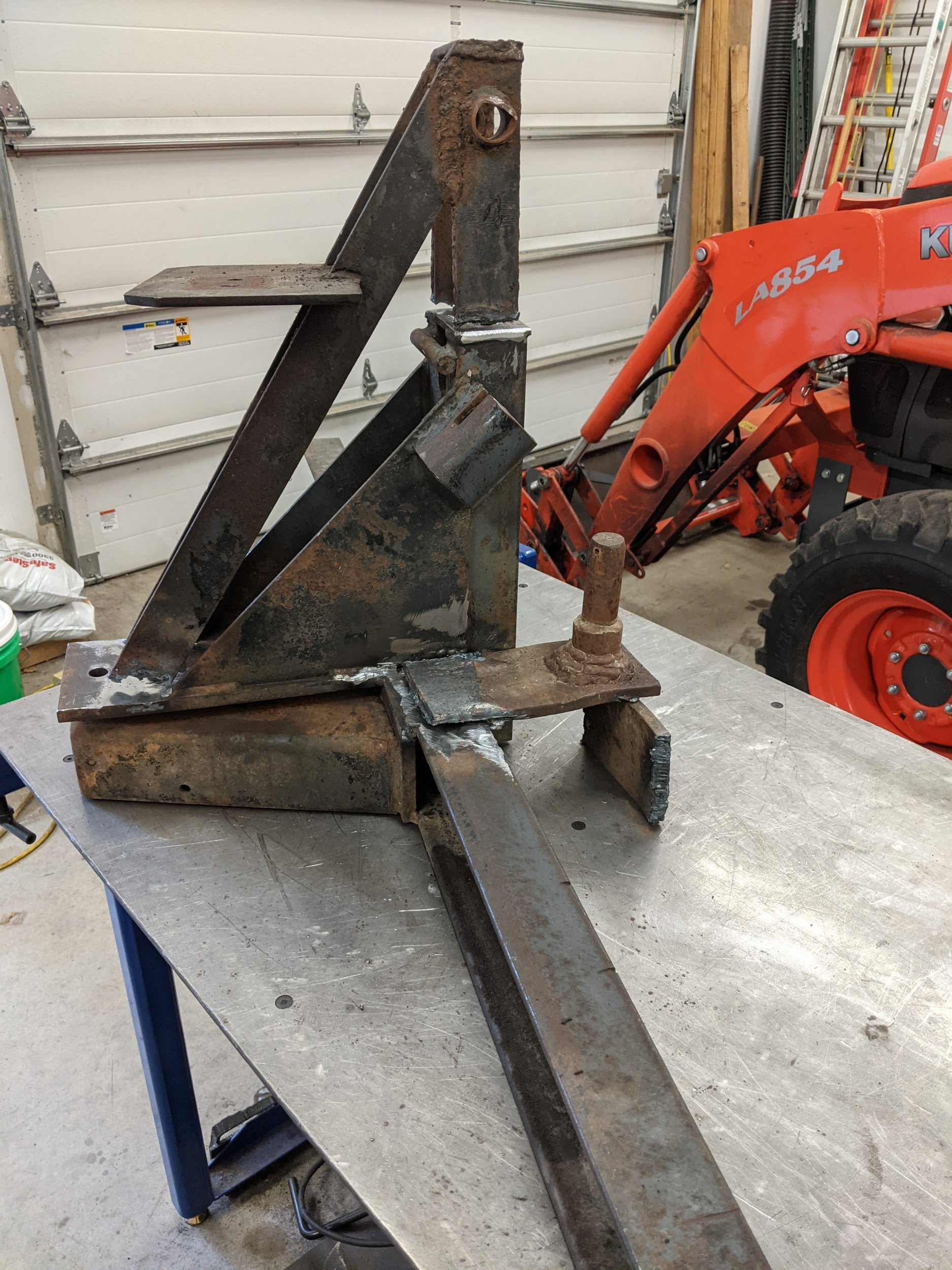

The pin for the angle pivot cylinder was a hacked-up mess so I decided to just cut it off and start again. Some PO also hacked on an extra frame to use it on a 3-pt hitch which also went away.
And Viola!
So I used my oxy-propane torch and cut off wheels to get these parts off. I am not good with the torch plus access was tough in corners, so gouged into the meat of the frame in a few spots. I ground out any residual slag and welded those back up to solid and then ground it off flat so this is good to go for the next step.

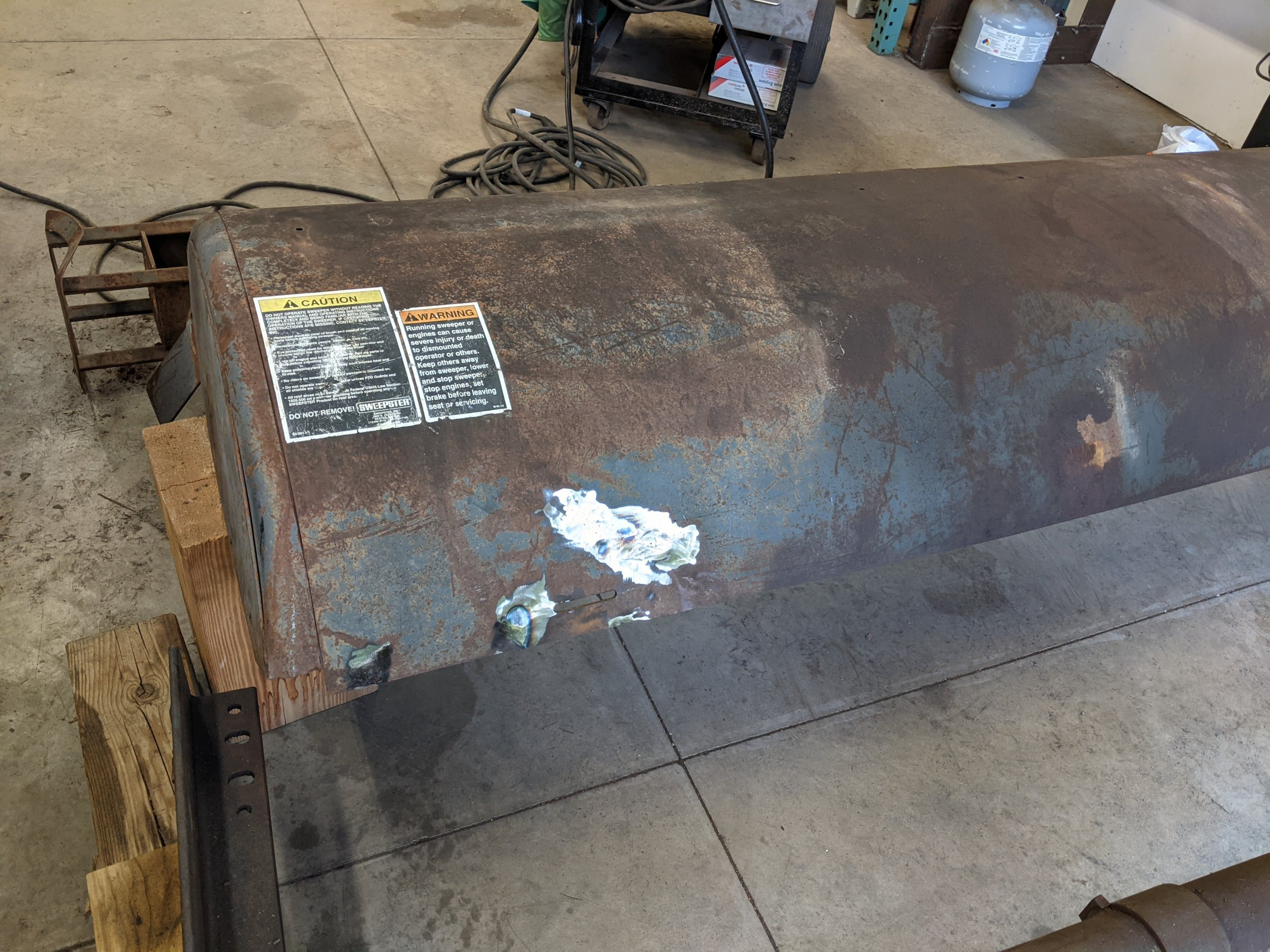

The shroud for the rotary broom had some damage to it, so i repaired that. Again not easy as I have 045 wire threaded up in the MIG and this is probaly 16 ga sheet metal. Yes, I probably should have rethreaded 030 wire but that is a pain and I am lazy... So a billion tacks and a half dozen grinding sessions and it is basically fixed up. Except I think I saw one blowout that I missed so I should fix that first before moving on... But after that it is on to making the structure to tie the frame shown above to the SSQA plate, with room for the tank. I am having a shop cut and bend the tank parts for me as I cannot do that. Other parts on order... Trying to move this along so I can actually use it this winter!
I've no experience with sheet metal, so this was no more than "good enough" to get it in decent shape for later powder coating.
