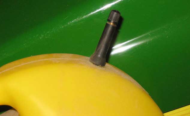

A friend bought one of these when they first came out, didn't like it & passed it along to me. Agreed with his assessment; however, I had a few spare tire valve stems laying around. Took a few minutes, works just fine. Mod is now 2+ years old and holding up well. Merry Christmas.

al3,
That's the best solution I've seen yet!!
I drilled holes in mine and put a piece of duct tape over the hole to stop splashing while I'm driving home from the gas station. The small hole lets in enough air to pour the cans quickly and without spilling.
Thanks,
Eddie
