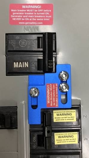

This was posted by Moss. Simple and no chance of generator breaker on, main on simultaneously.
