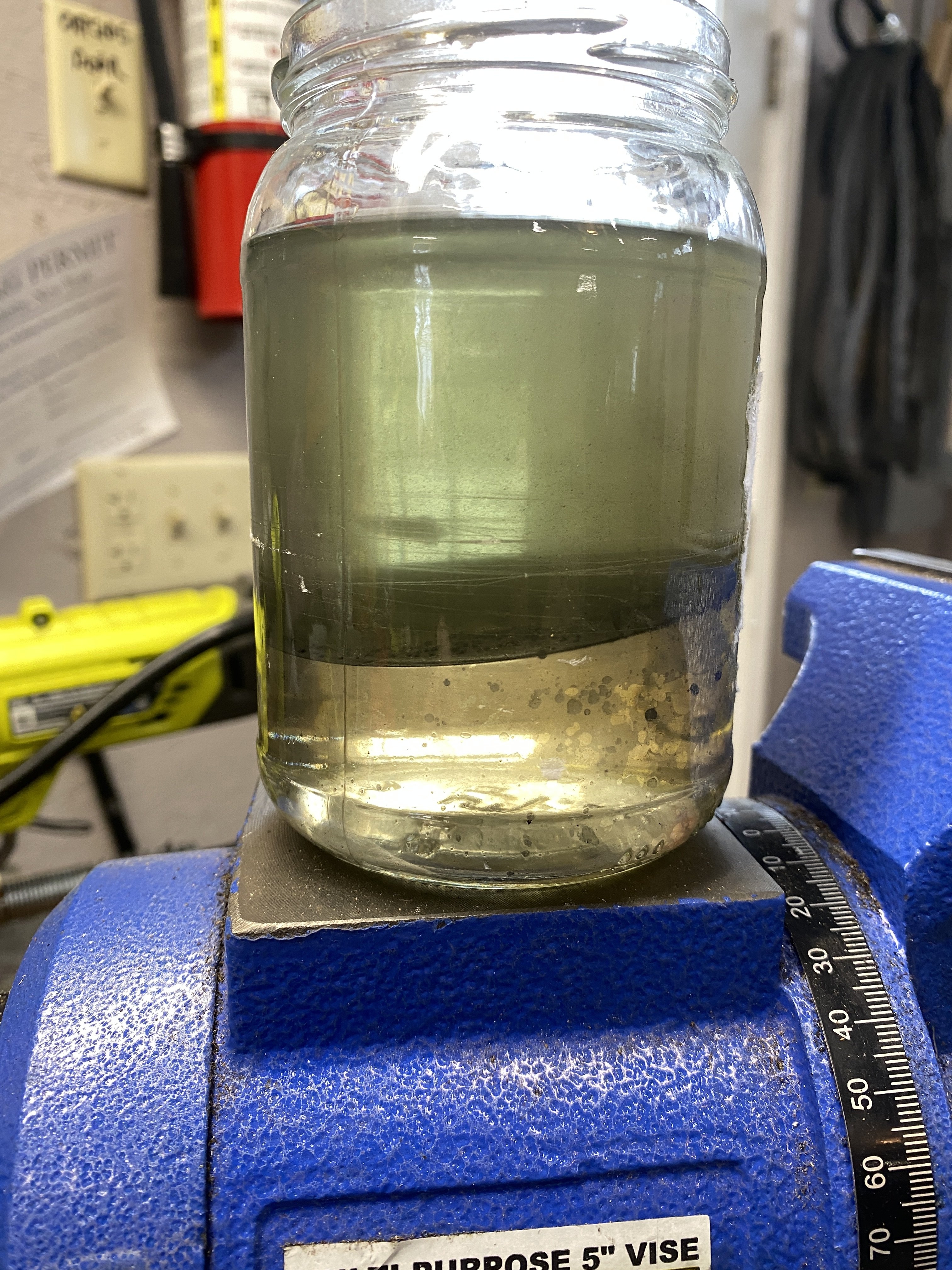

WATER IN FUEL:
We have recovered up to a liter of water from a 5 litre or one US gallon fuel canister. Ethanol is a pure alcohol. It mixes readily with water in air in tank, then this water+ethanol mix interacts with gas, and creates an acidic gel that corrodes carburetor metal. If water is in excess than what the ethanol can absorb, or fuel is ethanol free, the free water will go to the bottom of the tank.
There is a green colored plastic funnel that has a filter in the middle. I tested it. Water does not go past this filter. The method is slow.
Or, once you have removed the water by decanting it, and see no water at the bottom of the tank, shake the tank. If the fuel turns cloudy, water is mixed with gas. No choice but to discard it. Use it, and your engine should suddenly stop again and again.
