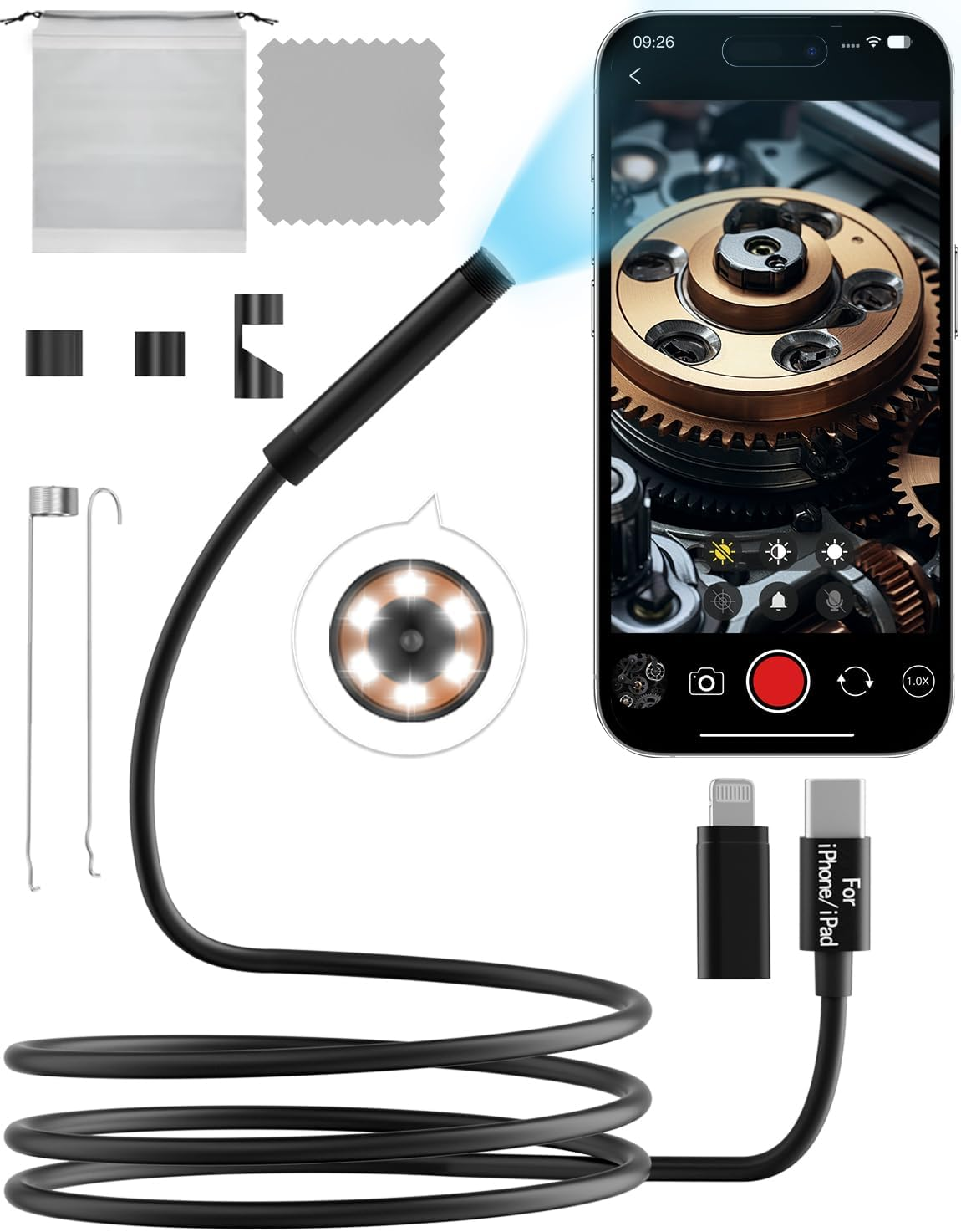

Buy a cheap inspection camera for your smartphone like this one:
I have one and it works amazingly well. Use it to inspect your ductwork in various places. If they're dirty, get them cleaned.
I worked in an office back in the 1980's where half the employees smoked. People began getting respiratory problems and the company eventually had the ductwork inspected. I happened to see a worker when he opened up a section and I almost lost my lunch! It had a half inch thick coating of green gray mold coating the entire duct! They closed the office for 3 days while the ductwork was cleaned, and in some cases, replaced.
I doubt residential ductwork would ever get this bad but it might be worth spending $16 for the above camera to be sure.
