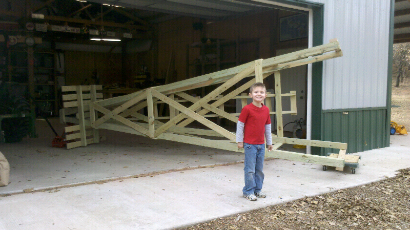

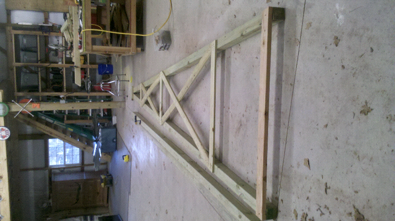

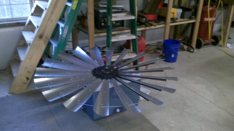

Well, i didn't intend to let this thread die out. Ive purchased the lumber and most of the sac-crete to finish the project. Here are a few pics: one is a single side being completed and the other is the 5' fan. Hopefully the weekend will allow me to be quite productive. Im gonna wait until it warms up before i attempt to form & pour the slab for the base.

Looks like the fan blade I have but mine has a fixed rear wing,, If yours has a grease able front bearing you might want to put an axel cap on it,, Mine got water in it in the first few months now that it's capped it's doing much better,,
Keep the pic's coming as you build the frame,, mine is on a steel pole but like the looks of the wooden structure ..

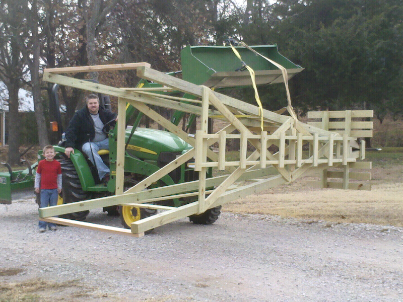

Moved the tower today. Rather difficult to maneuver a 16' wide unbalanced load thru a 10' gate. Here are a few action shots. My wife and son helped supervise and stabilize, respectively.
