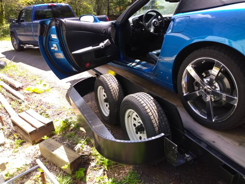

I appreciate the advice, but the car hauler only has 4 deck rings, one at each corner. I wouldn't want to try & DIY additional ones for fear of screwing it up.
Understand. Seems like trailer manufacturers don't see the whole picture. Keep in mind, you do not have to use just the D rings to tie to. Looking at your picture, at the rear of the right hand fender, it looks like you might be able to wrap the chain around the frame upright. Not sure but a thought. BTW, is your trailer aluminum?

Yep, made by Aluma. Not sure about the strength of the rails & uprights, it isn't adressed in any of the trailer literature. FWIW, I'd use an axle strap if I was tying down there.

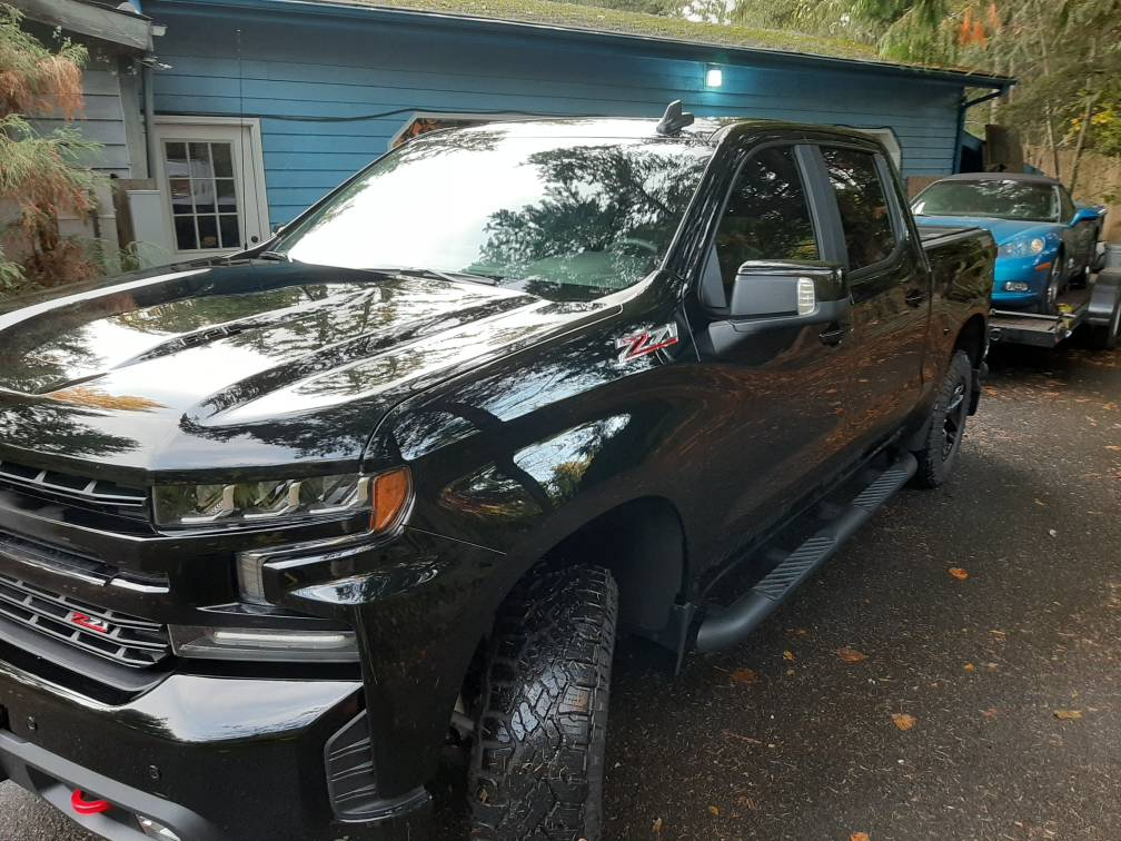

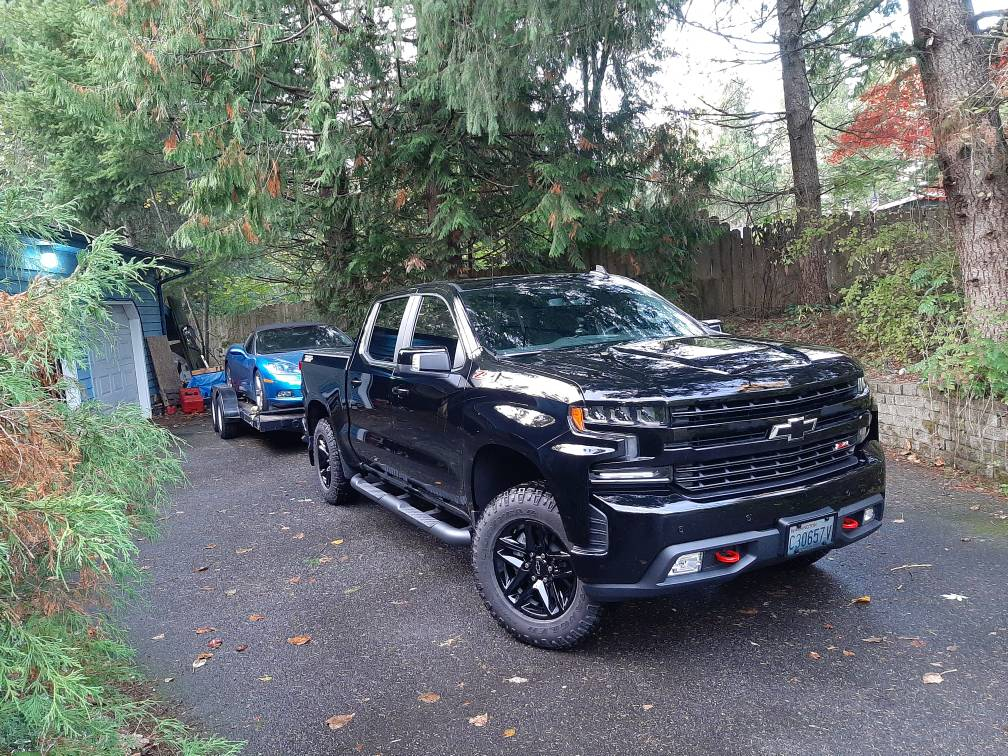

I like the colors! The truck and vette match (or close anyway)!
The car is Jetstream Blue. It's kinda a rare color. It's a tint coat color so it changes in different lighting.

Maybe having a truck and toy the same color is a theme with me. I also have a black truck and toy. Although the black toy is undergoing a little restoration right now. So no photos of it on the trailer behind the black truck.
