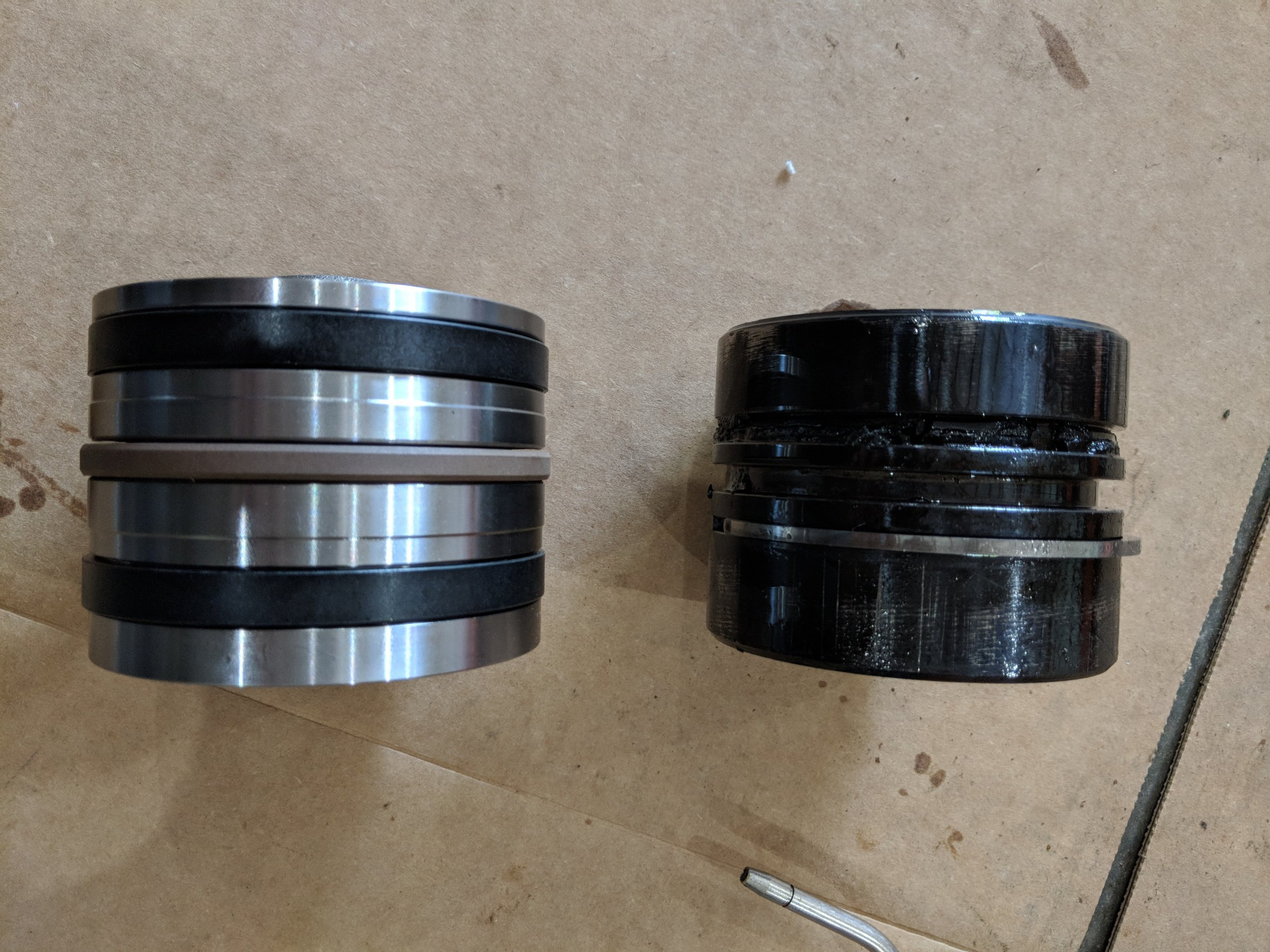

Replaced the hydraulic pump this morning. Disappointed to report it has not helped at all. Tractor still won't lift any weight. At a total loss now
   / Zetor 5211 some questions #19
Your lift piston probably has no seals left on it. They have an updated piston that uses a Teflon seal instead of the original rubber and iron ring. Here is mine as I removed it from the tractor.. You can see there is no longer any rubber seals on the original piston.
#20
Just want to update this as the issue has been solved.
Ended up being the seals that had worn and oil was leaking out. Got them replaced and all working perfect now.
