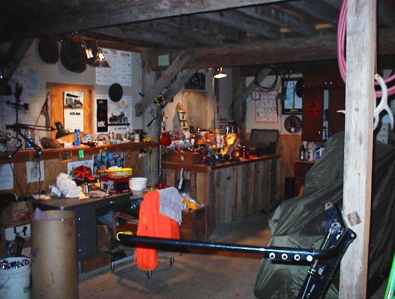

Unlike the Webmeister, i don't usually have time to comb my hair before picture taking. Thats why my shop is such a mess! My workbench is made out of scrap and salvage material.(mostly palats and a few economy studs and one sheet of 1/2" plywood) My entire barn is made up of the same including garage-sale stuff. i took a couple of pics of my bench and shop. Entire cost of barn, right around $3500.00! Shop,24'x24': Entire barn, 24'x40' with hay loft above shop part.......Will try to start a post with all info and pics later.....Great thread, Todd...

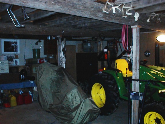

another one from differant corner.......

I detect some rattlin' horns hanging on the post and the orange hunting jacket on the chair. Didn't see the bow or the gun. Looks like a great shop too.

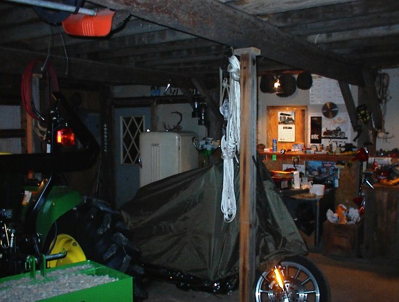

still another corner.............
