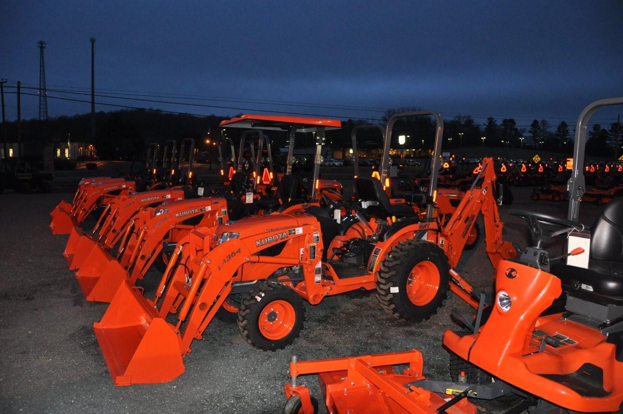

The B2630 sounds OK to me, but would look for either the B2320, for smaller, or B2920 for larger, with all the attachments you would like. This size is also easy to move with a smaller trailer, 16ft tandom. I have now moved up, to a B3200 tlb, and need a larger trailer to move it, if I am going to move it a lot, if not will make do with the 16ft. Ok here is a teaser photo, of one I saw on a lot in NC.
