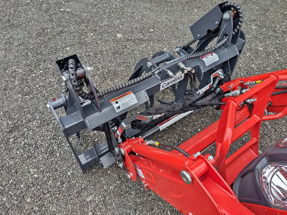

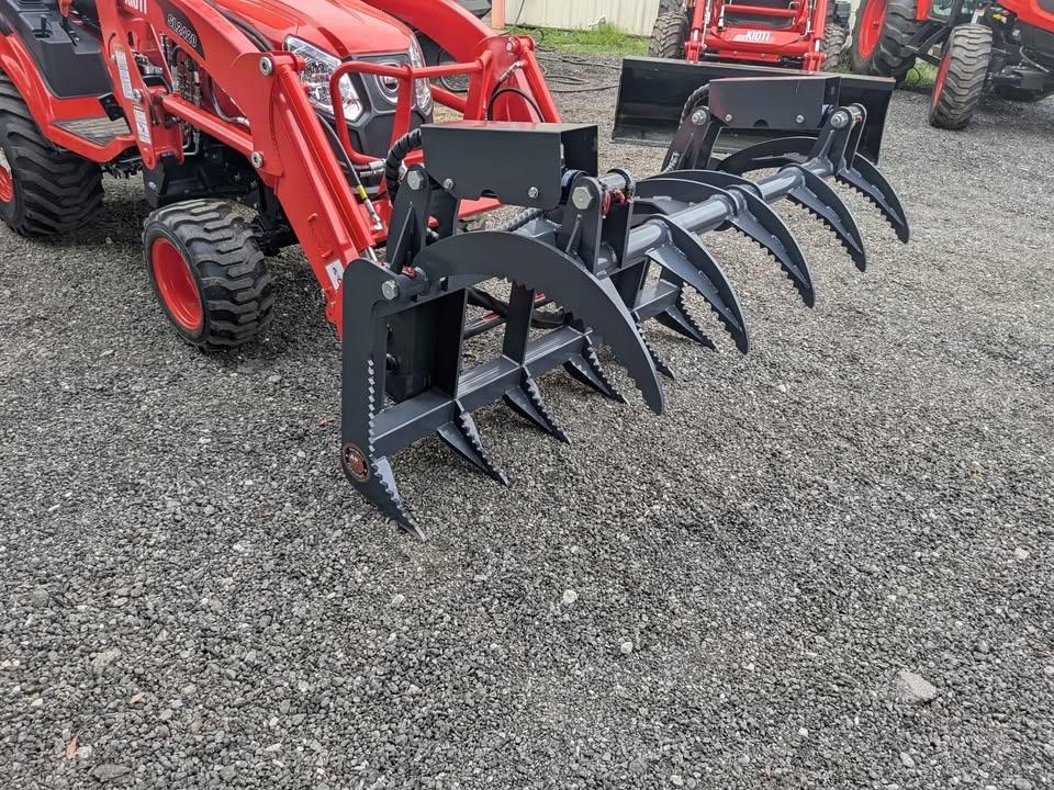

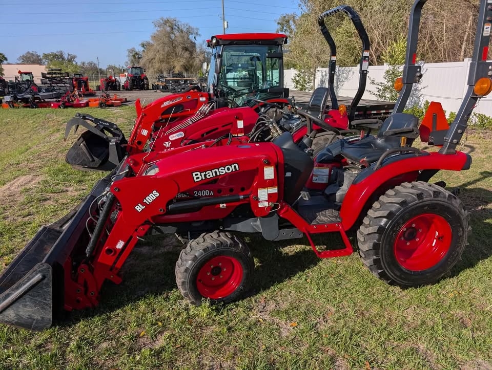

My decision comes down to weight with a BL100 FEL rated at only I believe 1300lbs.
The Catawba 54" is 212lbs but no bottom teeth (2)4" cylinders, grease fittings. $2200
The Catawba 55" is 300lbs and has bottom replaceable teeth plus 3rd lid arm, (2)6"cylinders, grease fittings. $2600
WR long RBG3-56 is 238lbs good bottom teeth, no 3rd arm, (2)6" cylinder but on top not in back.$2500
I have a Branson 2400H with BL100FEL, the dealer has Carolina 54" 250lbs $1500 to me and local to pick up. Single lid arm which I like, don't like the separate arms.
Cylinder on top but covered.
Thoughts? Think I may just go with dealer who sold me the tractor for $1500
