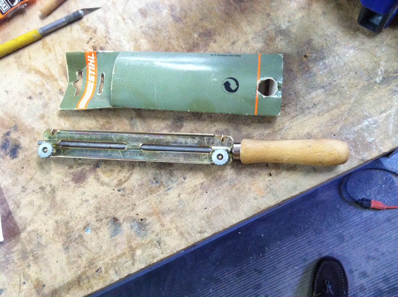

I have one for 3/8 chain. I use it to check the depths of the rakers, not actually to leave in place while filing.
