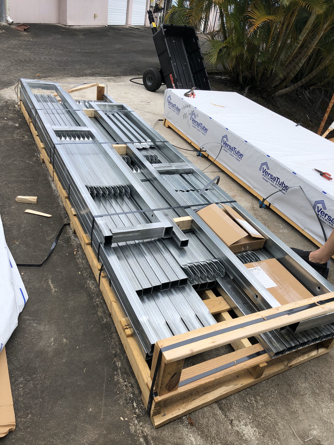

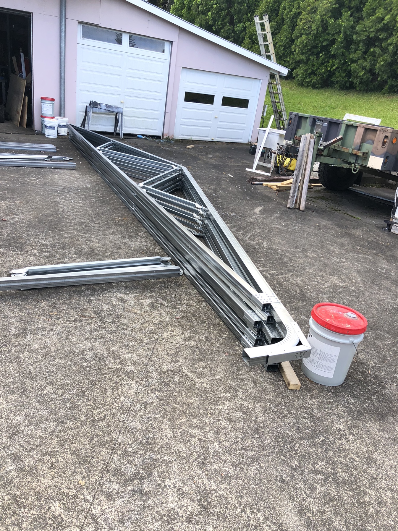

30 nuts and bolts, 816 self drilling screws later - 6 31ft trusses
All in all, a pretty good day. Impressed with how well it went together. Basically check a couple of measurements, find center, make sure collar tie is straight and it went together easily.

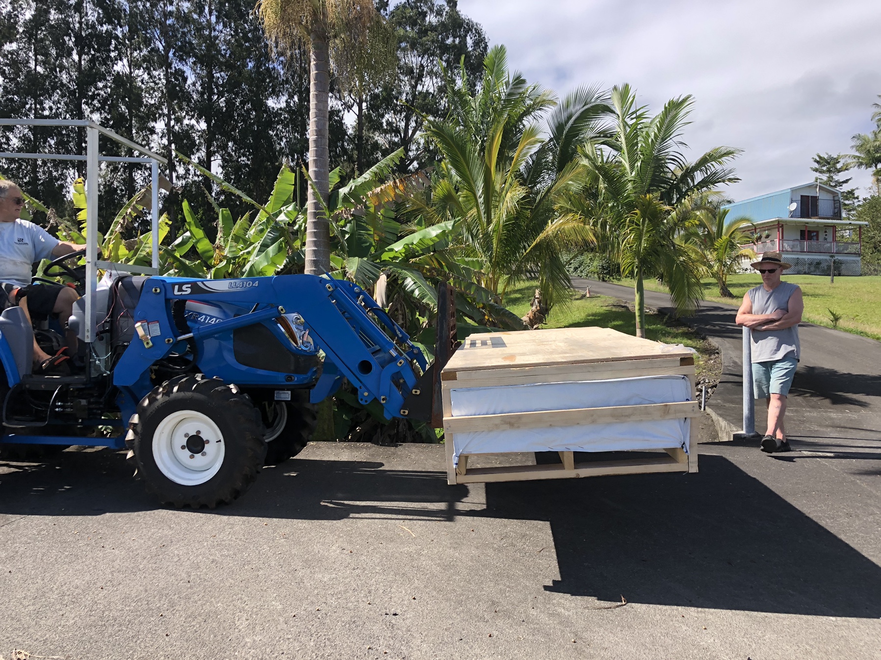

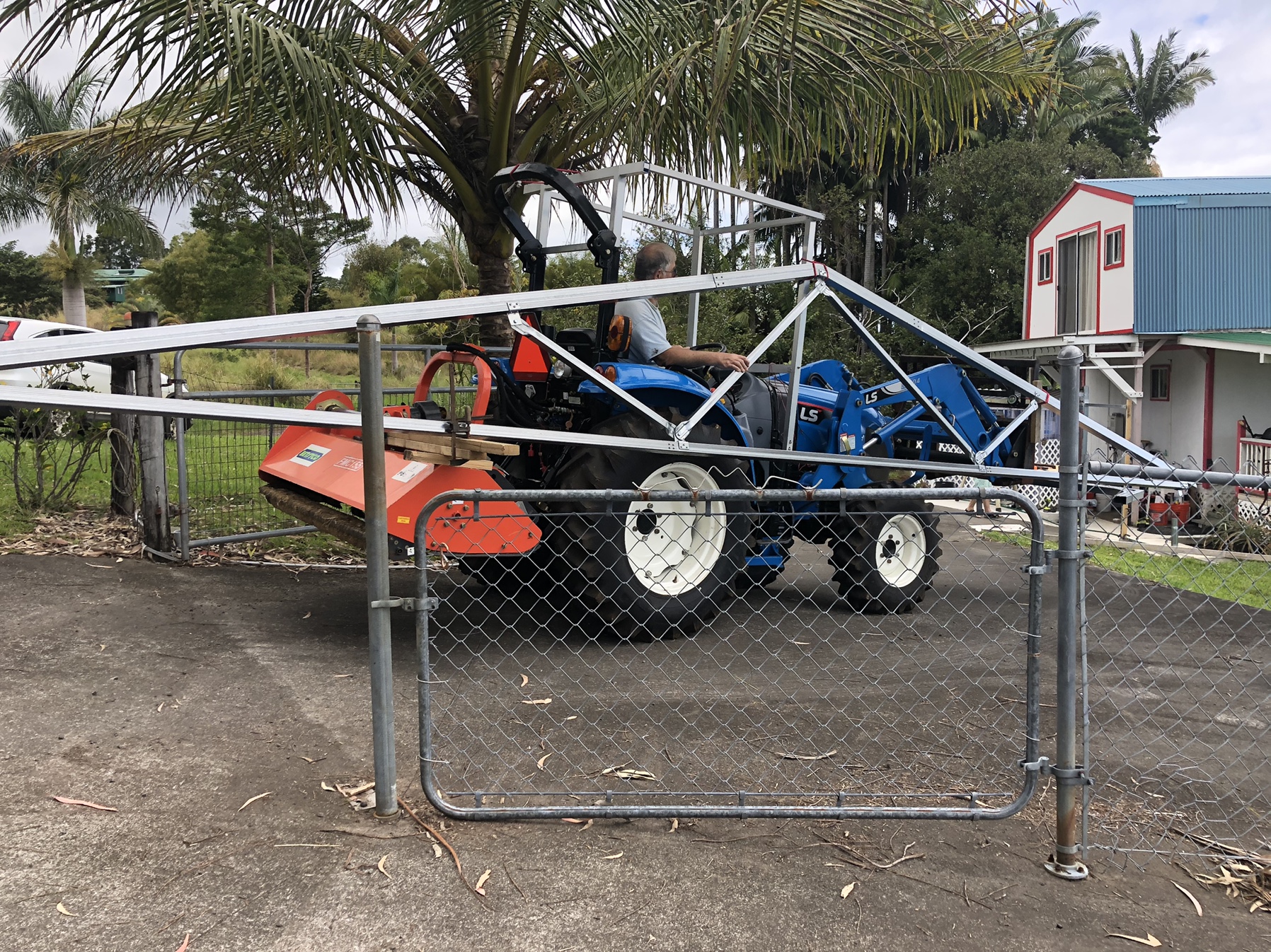

Rain coming in, but managed to get corner brackets installed. Actually been sprinkling on and off most of the morning.
Next step is to mark locations for the purlins. Easier on the ground and will aid getting trusses in proper alignment. Challenge is my marker doesn’t work well on wet metal.

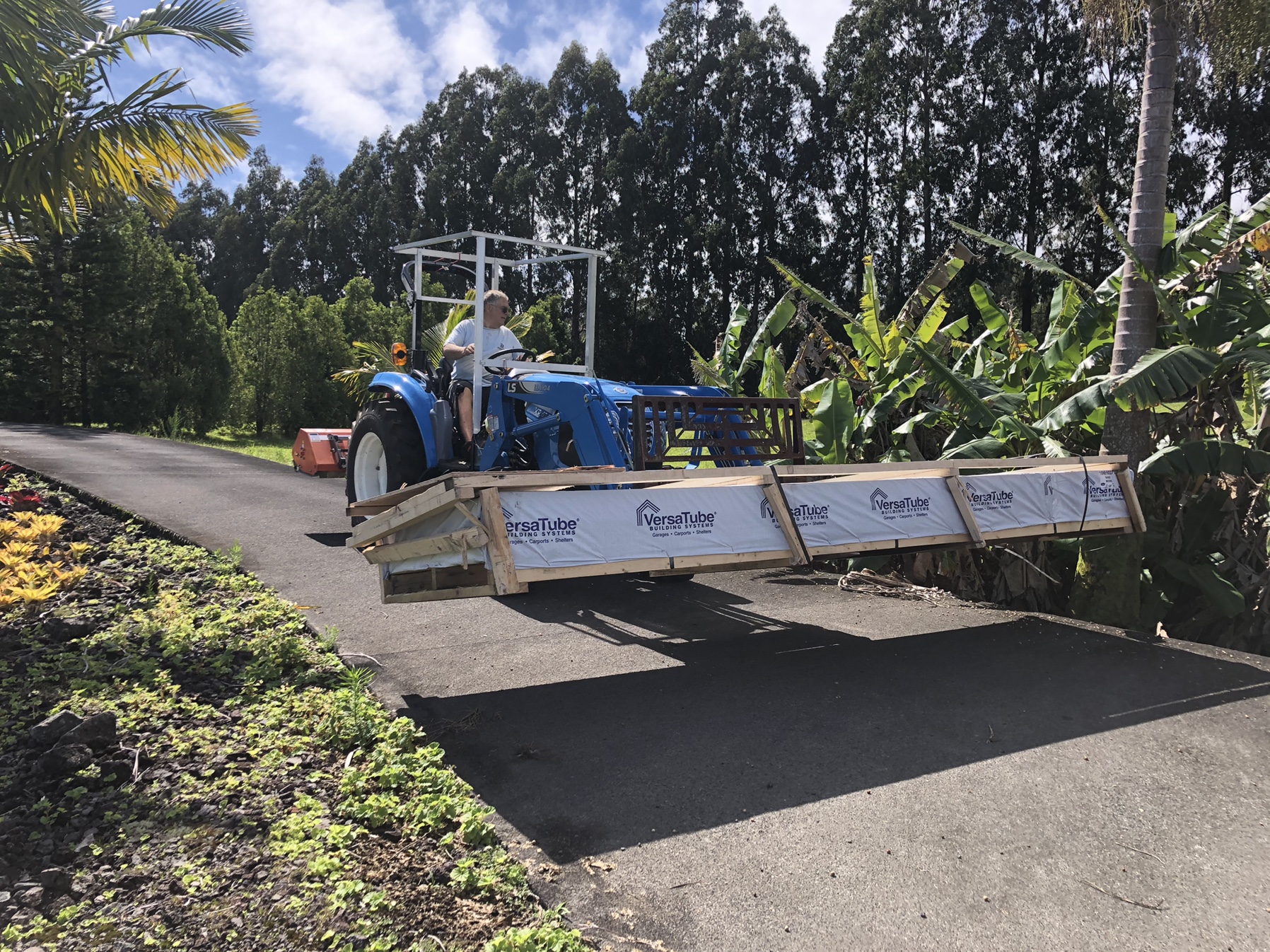

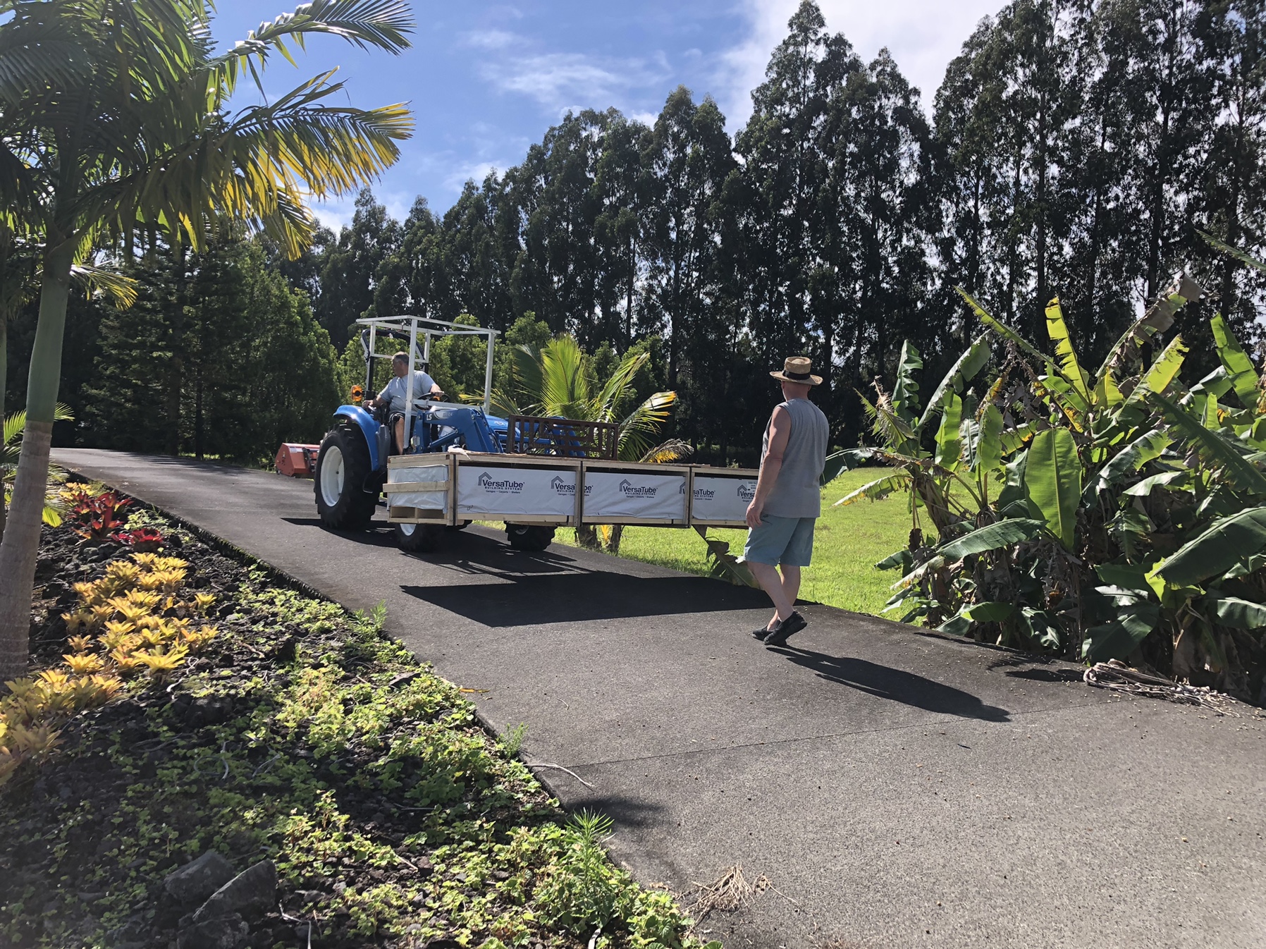

Will transport trusses individually via tractor. Don’t have flat area of sufficient length for leg installation at the cottage. Current thinking is to install legs temporarily here at tractorshed, uninstall for transport, reinstall at cottage. More work, but I think actually easier.

Rain held off long enough.
A few paper towels later and I was able to get trusses marked for purlins. Also played with positioning leg support brackets. All in all, a good day.

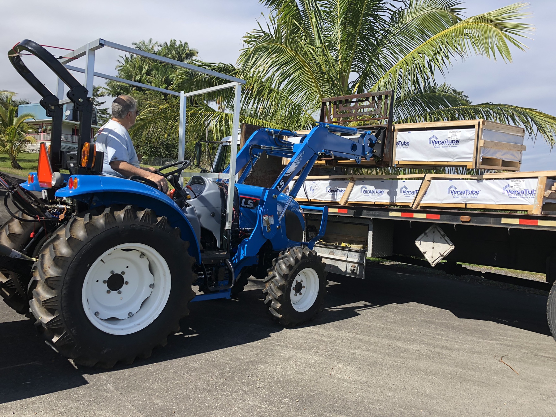

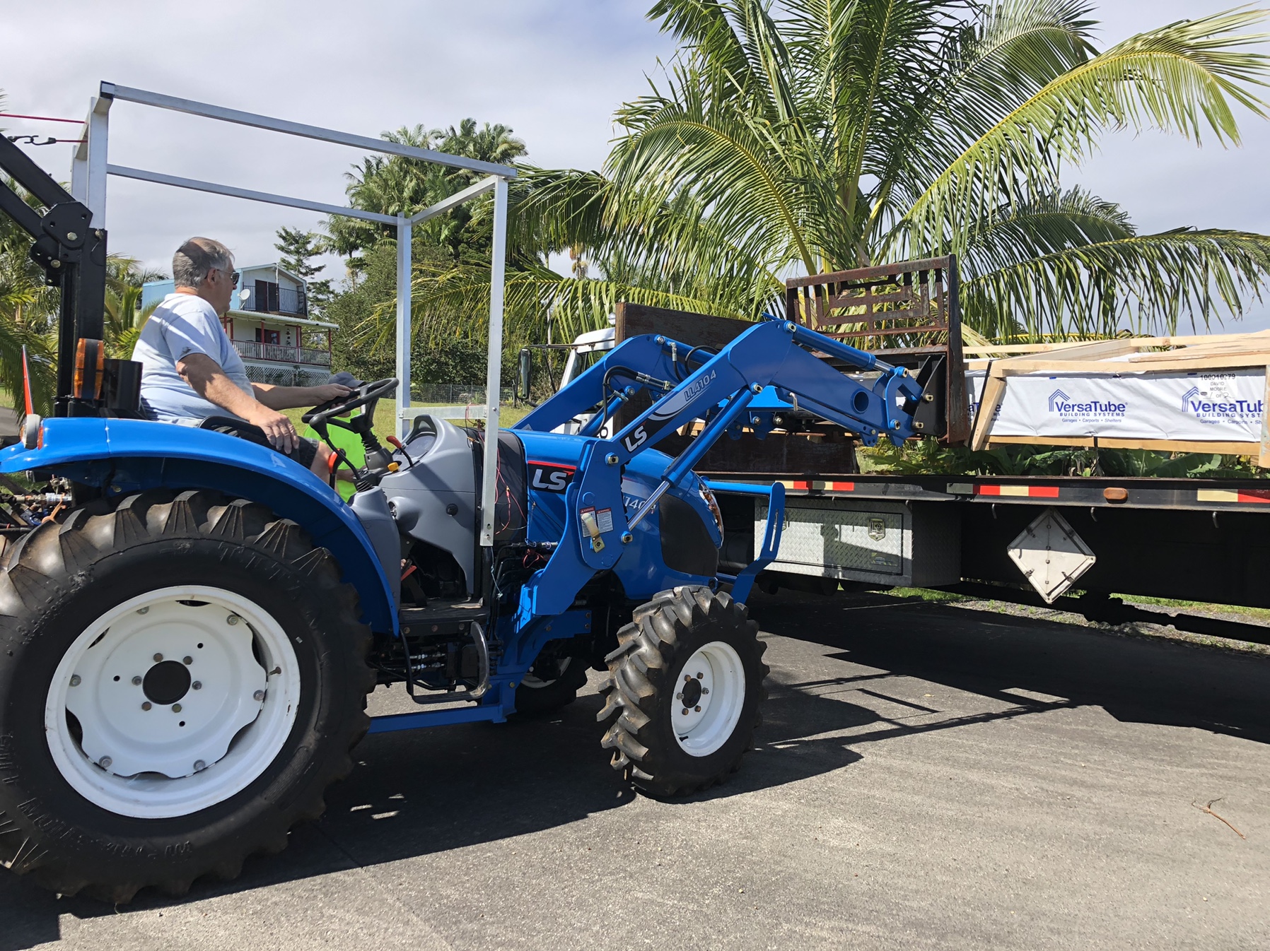

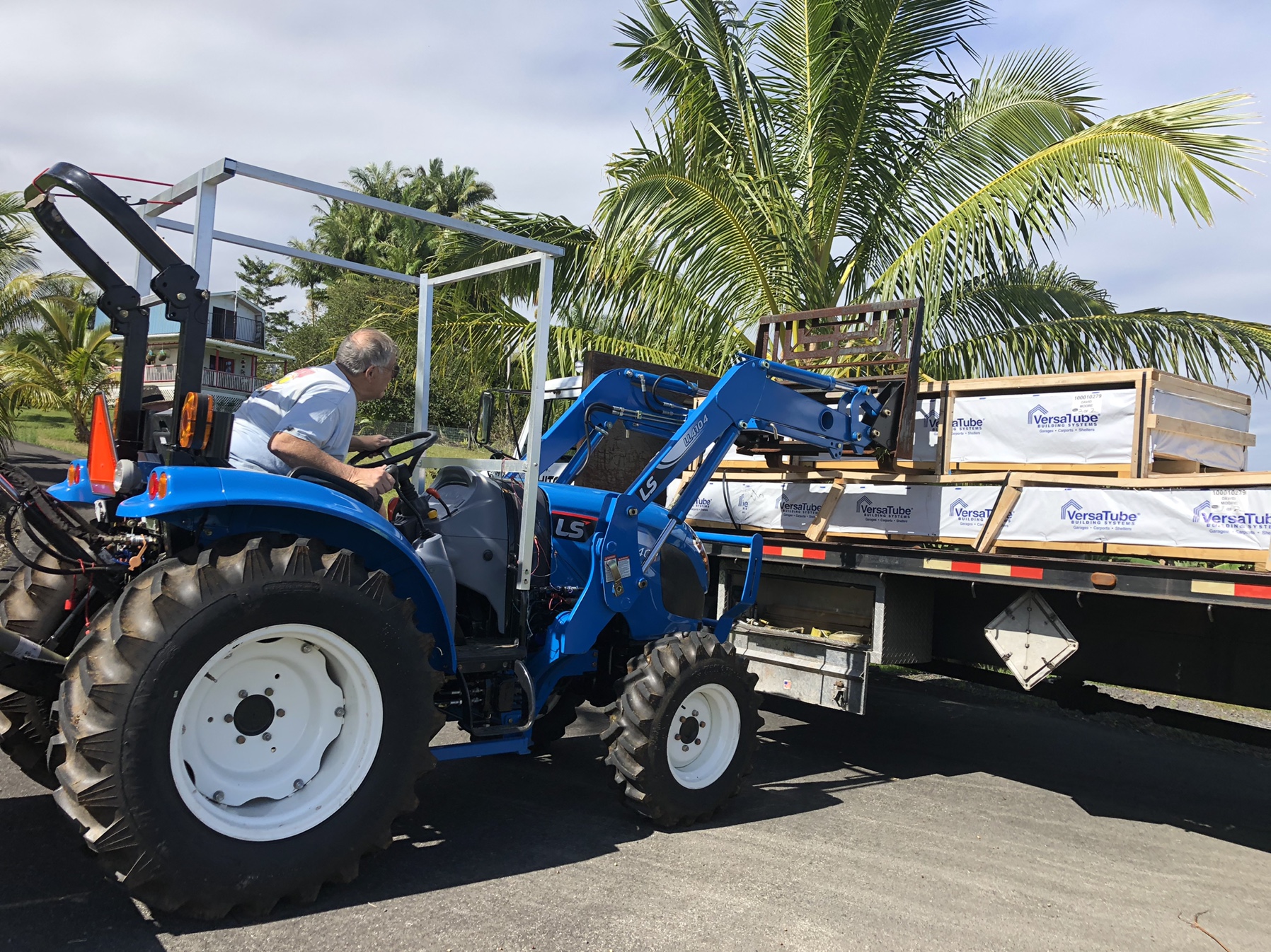

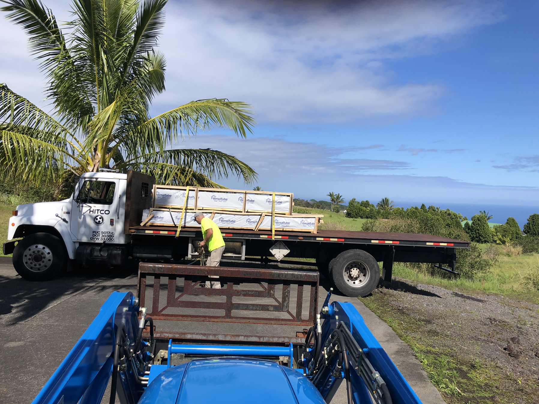

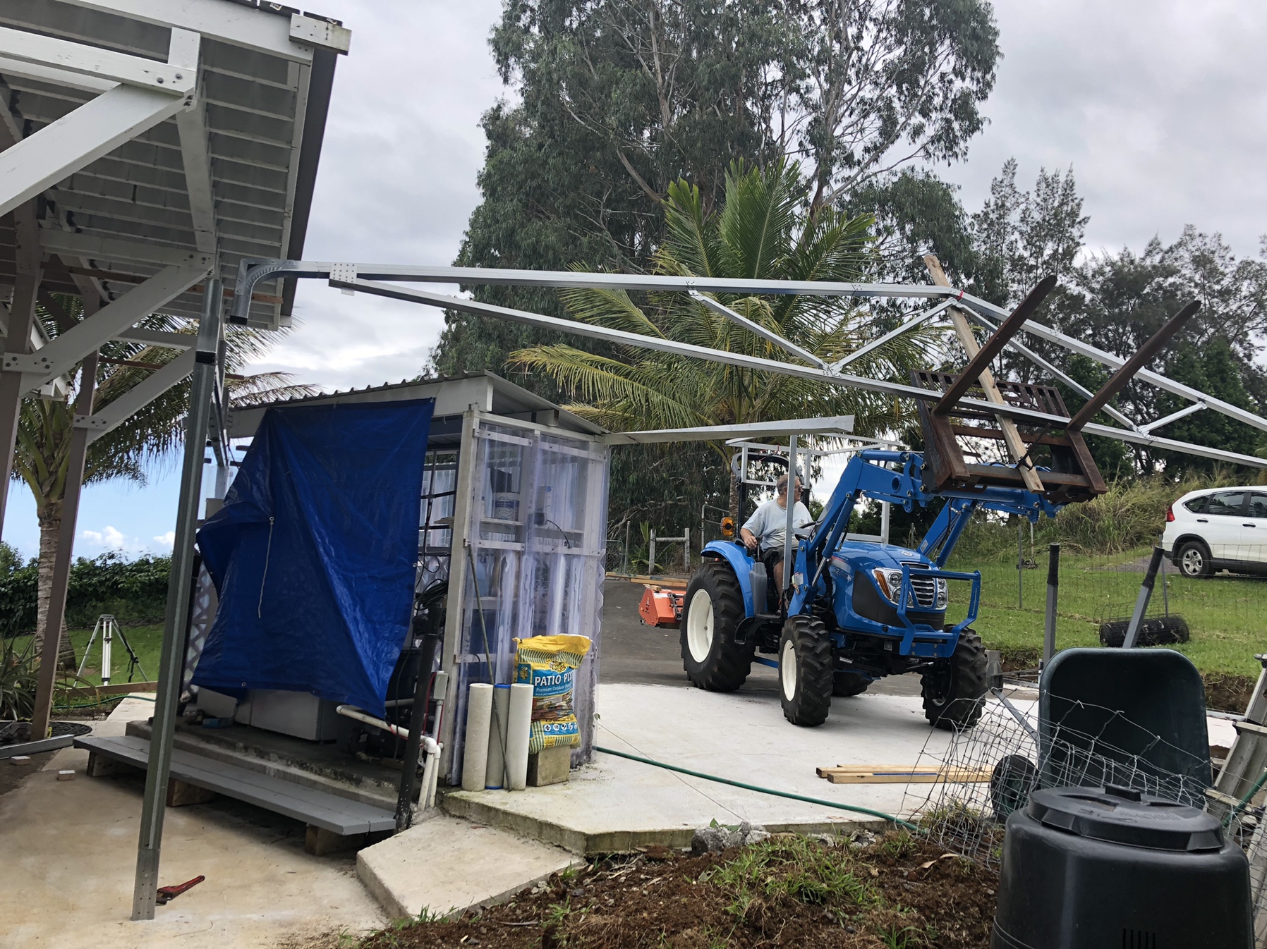

Hope to get started erecting wall today. Slow and easy. Will report back.
/ Cottage Carport
#94

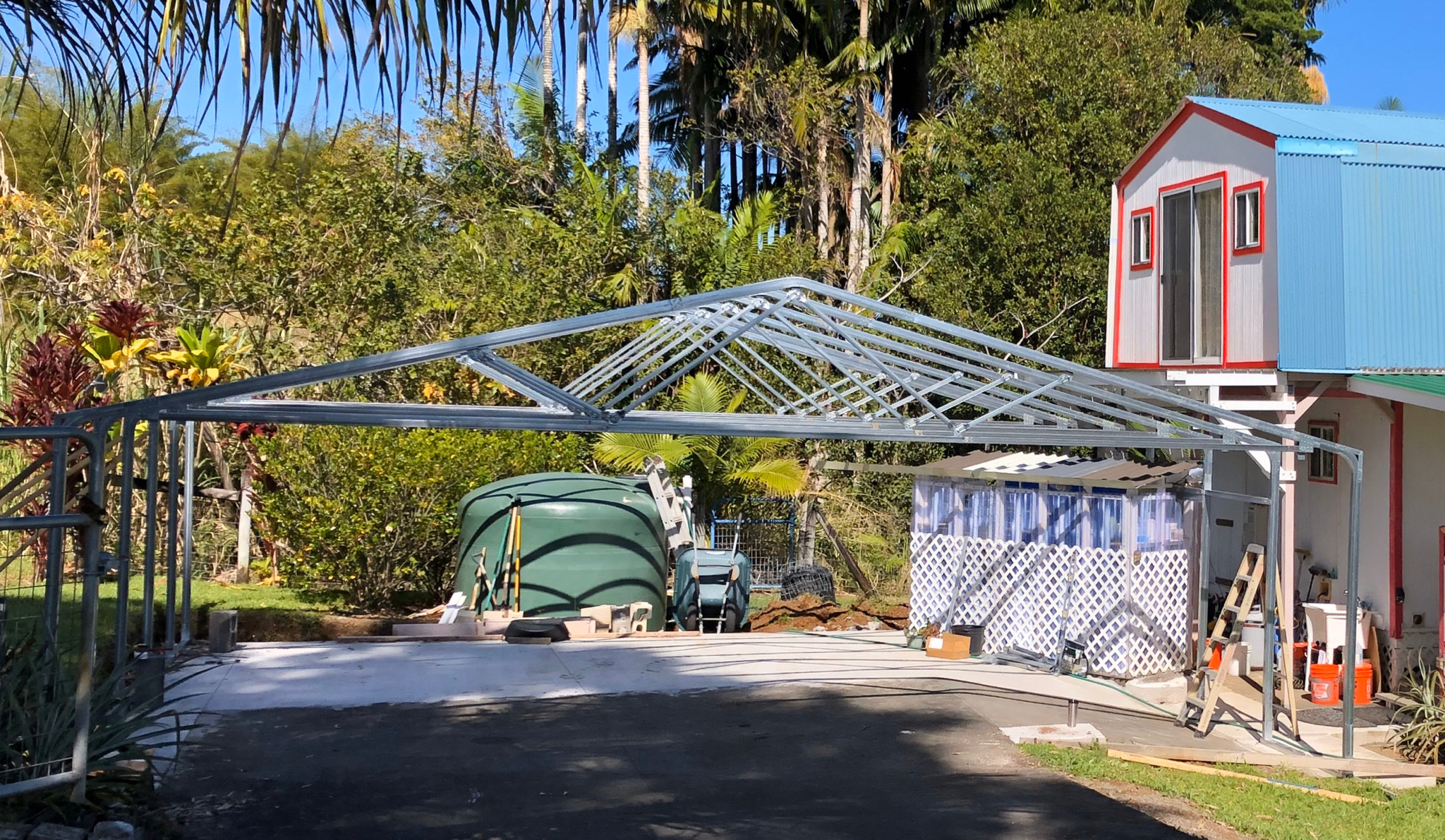

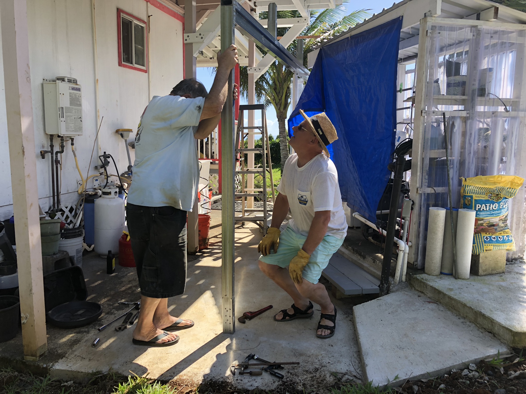

The erection has started
First, getting the wall piece up to Cottage
Fit into place to determine mods for laundry structure
Put base in place
Move a truss to cottage
Maneuver into place
One up, ready for number 2
Two trusses set.
Tomorrow’s another day.

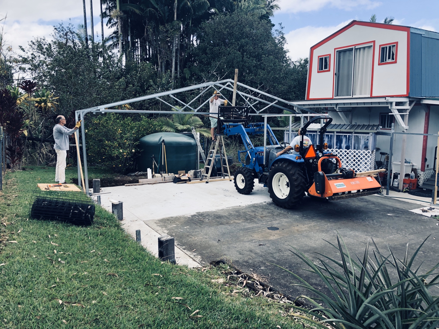

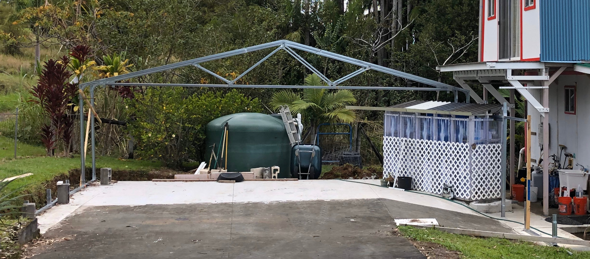

All trusses in place, taking a break. Just Canada Dave and I today. Only about 1 1/2 hours to place.
After break will work on truing and stabilizing.
/ Cottage Carport
#99
Three rows of purlins and 1 row rat track installed significantly stabilizing structure. The bracing back to cottage will hold it true and then we can finish the purlins, rat track, and corner bracing then hundreds more screws in the slip joints.
No new pics, just nothing that notable.
As for the roof metal, that is coming from guy I bought my house material from. 12 ft lengths and some custom cuts. I could have ordered from local building supply that makes own roofing but at 2x the cost.
