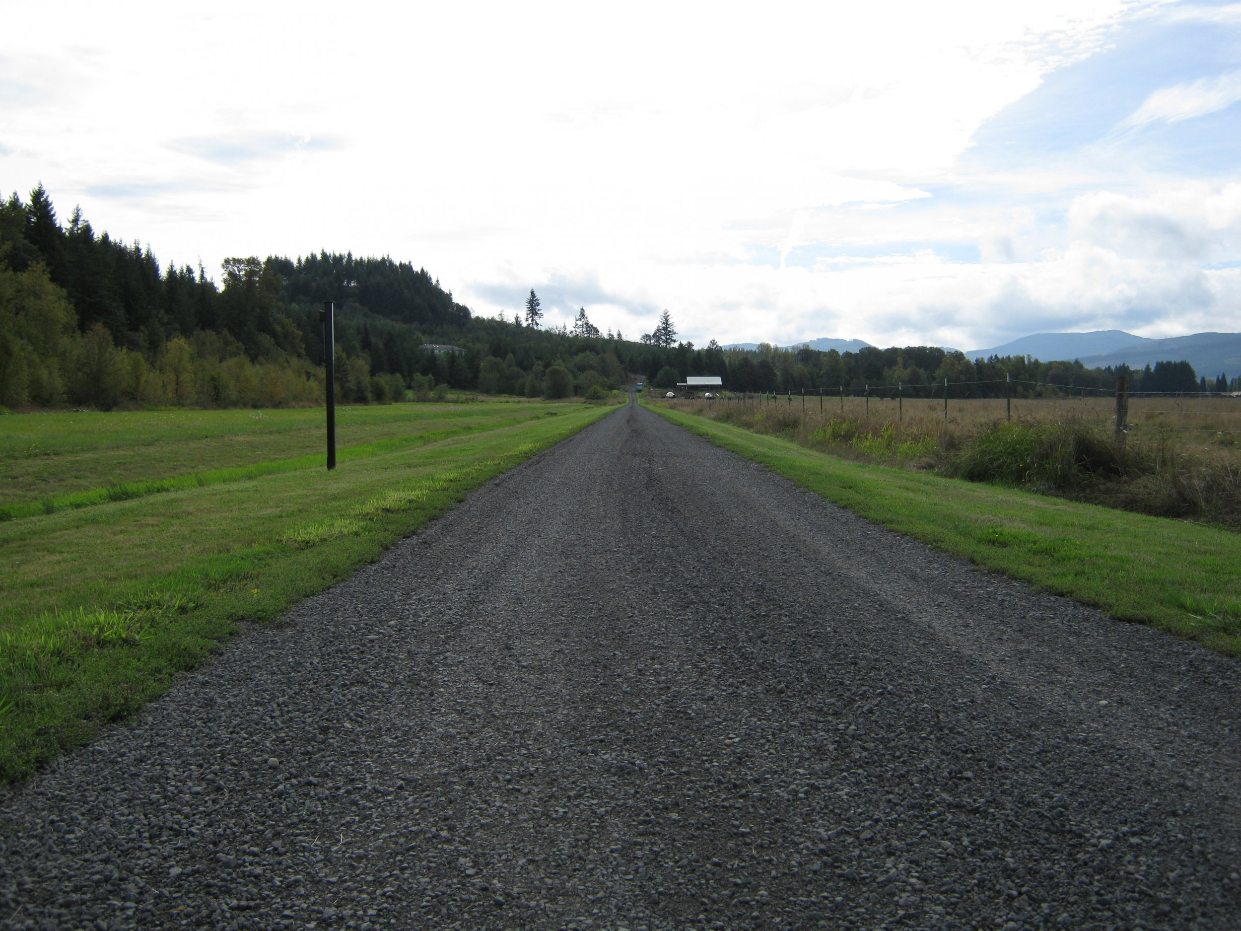

My suggestion...fix any/all places where storm water runs down the drive and not across the drive...then get it topped with something like "crusher run" that has fines that will pack down hard...loose gravel will only get worse over time...
Working a gravel drive when it's been dry is not recommended...it tends to separate the fines and leaves nothing but more lose gravel...regardless of the implement used...
Fines are the key to maintaining a gravel lane that is like concrete...

Don’t think the surface material shown will pack or hold its shape. You require a crushed well graded gravel.
A rear blade with gauge wheels would work best for bringing in the sides and shaping the road. Scarifying well first would really help. The gauge wheels will really help with a back blade.
The stages:
scarify
pull up the edges and define ditches
roll a windrow of material back and forth to fill in hollows and get
nice smooth grade. This is very important. One pass just doesn’t
do it. Rolling a windrow will also help mix the aggregate on the road. The vertical angle of the back blade is important to do this
correctly.
You may end up up with a few larger rocks on top. Blade these into the ditch.
Then a vibratory drum compactor.
Now you would be ready for additional crushed gravel. ( 3/4 in. And less )
The tilt of the blade and the angle can be varied so certain tasks can be carried out. Again one setting just don’t do it.
Thank you Egon. I put your information together with others and I think we've got a plan now.
Buy a box blade or land plane w/scarifiers. Is 700lbs sufficient?
Hubby nixed the back blade, but he's open to getting a landscape rake depending on it's price.
Scarify.
Spread out the loose gravel.
If we get a landscape rake, get at least an 7' rake and use it to pull gravel back into main driveway.
Make a crown and smooth the drive.
Expand the ditch on the right side of the drive.
Compact it with the tractor.
Lengthen the ditch on the right side of the drive.
Check on what the driveway looks like and decide if we should get crusher run or something in between.
Compact it again and wait for a rain.
Finish off with crusher run.
Compact again.
Don't let UPS or Fed Ex or Amazon drive on it until after the crusher run is spread, it is rained on and has been well compacted.
Maintain after that.

1) Fix the drainage problem. The road needs to be above the water and shed rainfall to the side(s).
2) Use a well graded, crushed gravel. From the pic it appears the material used is not crushed and therefore has no sharp edges to help it bind and there are no finer gravels to fill the voids. It's like driving over marbles, they will just roll out of the way, since there is nothing binding the materials together.
3) Once the driveway has proper drainage, a crown and proper gravel, compact the surface. The compaction serves 2 purposes, 1) to seal the surface and help it shed rainwater and 2) to bind the materials and make the mixture as dense as possible.
This, in my opinion, is the best advice here, but it still doesn’t help with your question. Use this advise on the new driveway.
In the meantime, both land planes and boxes have their place. In your case, without adding additional material, as most are suggesting, I would go with the land plane. It’s got far less of a learning curve and will give you immediate gratification.
A box blade can be tricky to fiddle with to get the angle just right for a decent crown. It’s not impossible, but it’s a steeper learning curve and can be frustrating at first.
Everything is a trade off though... think about how you could use either implement in a year, 5 years, 10 years. Both of these are implements that only get used occasionally throughout their lifetime and need to be stored for long periods of time. Factor that in as well.
Best of luck! Either one will work for you and toys is toys!
