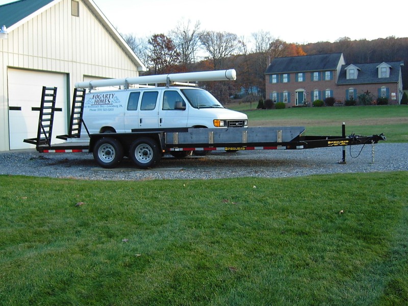

Mike,
I see your point, but I really never had that problem. Perhaps it's the trailer that I have. There's alot of tongue weight on the 3-point.

   / draw bar #23
PineRidge said:
Bill I really like the looks of a 3 point hitch rig like yours. The only problem that I see is that we move a lot of materials from point A to point B on the property using the trailer. When you step on the backside of the trailer the 3 point allows the front to raise and the back of the trailer to hit the ground. God help you is someones foot is under the back of the trailer when that happens, I found that out the hard way. :eek:
A receiver mounted on the draw-bar prevents the pain.
An adjustable stay rod on the 3pt drawbar would also prevent this.

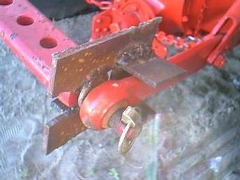

   / draw bar #28
Here are a couple shots of drawbar locks I've buzzed together over the years.
Soundguy

   / draw bar #29

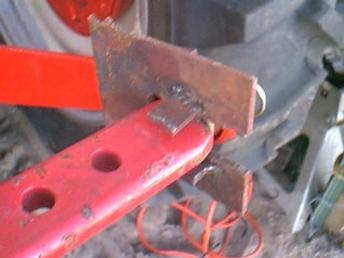

Newbie question - What is causing the draw bar to rotate in the first place?
I am picturing attaching a drag implement using a drop pin that goes through the the implement's tongue and draw bar together.... this should not allow the draw bar to turn - right? Perhaps when using a ball type hitch the ball may turn in the trailer's socket???
   / draw bar #30
Here's a pic of what I did to my draw bar, just a few scraps of metal and done. I dont pull much trailer wise, but really use it to secure my sprayer, that's what the 2 square pieces of metal are for on each ends.
