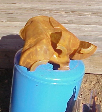

After replacing a bladder tank I decided to see just what replacing a bladder would involve. To get the old one out it had to be cut in sections with tin snips through the hole. I've read to install a new bladder it must be twisted real tight and remain twisted some way to insert it.
As mentioned several times above, purchase a new tank and choose another time to be frugal.

   / Household Well Water Pump Troubles #16
Easy to tell if your bladder is bad.
Shut off pump.
Drain water from tank. Note if any air escapes after water drains.
Check pressure in bladder. If pressurized - bladder is good. If not, bladder is bad.
Bad bladder - replace tank. Well X Trol is what I also recommend.
Good bladder - set bladder pressure to 2 psi lower than pump kick-on pressure.
If you still have problems, look elsewhere. Pressure switch, pump, foot valve, etc.
Hope this helps.
   / Household Well Water Pump Troubles #17
I would think even with the water off. When the pump reached pressure and cut off, it would drop and make the pump kick back on.
It would as long as he was using water and it was less than could keep the pump running.
   / Household Well Water Pump Troubles #18
This can happen if the tank is totally void of air. Since you can't compress water, there is nothing to store pressure and the switch can hammer on and off. It happens very fast and is very hard on a motor.
