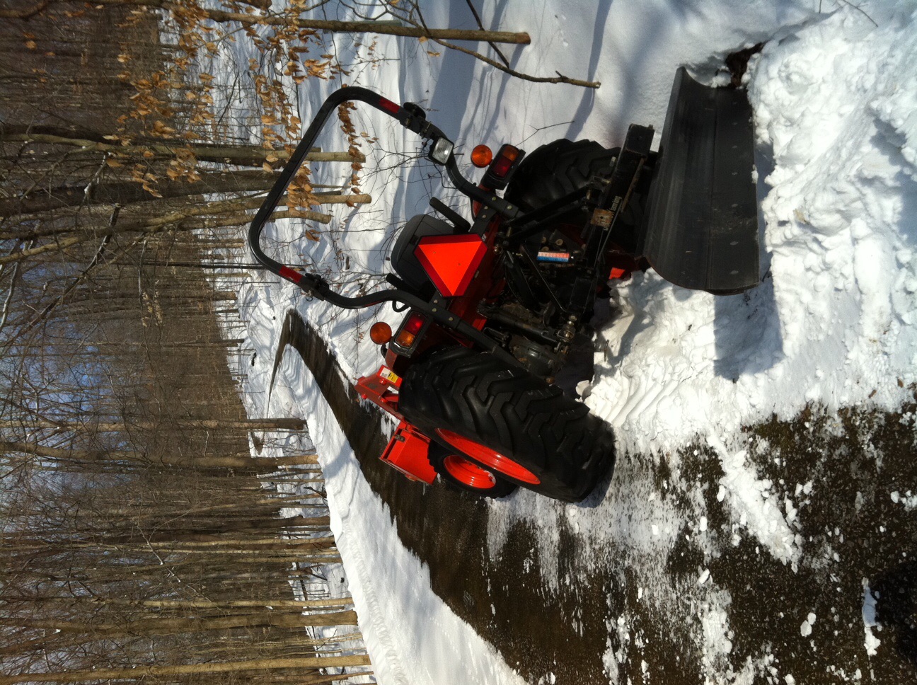

Here's part of my 3000 foot drive. I could write a book about it!
I see it was such a nice day that you decided to take the time to clean out the ditches, too......... [[[ :) ]]]
