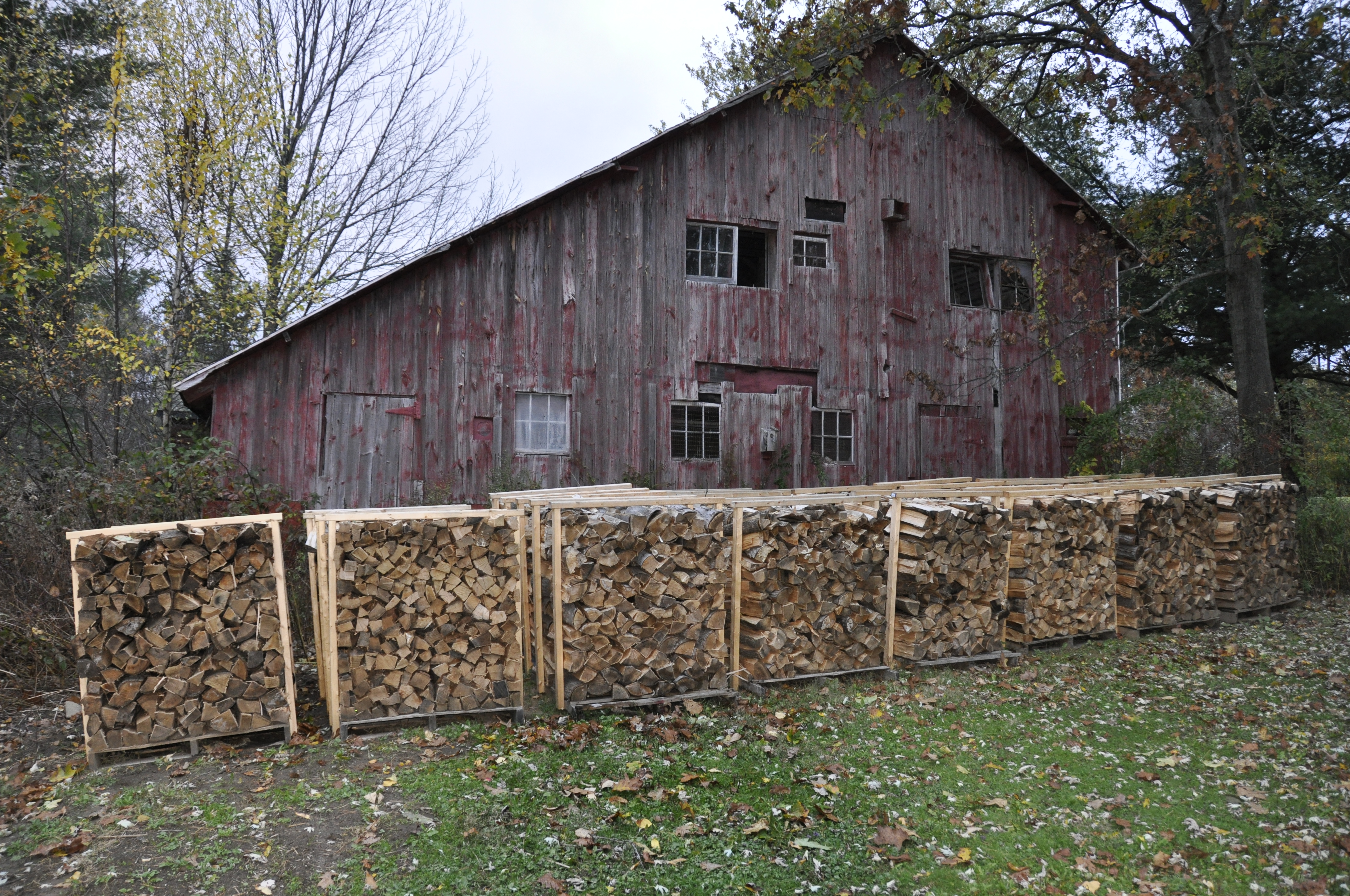

Do you have a helper feed wood to the splitter? If not, how do you keep up with loading the splitter and stacking the splits plus running the splitter?
I usually hire one of the teens from church to be my helper. Saves my back and earns him $12 an hour. Win win for both of us. But even without the helper, having no retract stroke allows you to grab the split wood off the side trays and keep splitting. I load my split wood into IBC cages and then use the tractor to move the cages to a sunny spot on the south side of my barn for seasoning. At the end of the fall I move them again into the barn.
I also bought a 4 way head (also bi-directional) to make it more efficient. Bought it from this guy who lives near me.
Powerhorse log splitter with custom made dual 4-way wedge - YouTube
This was the first job it tackled. I used wood racks that first year, and switched to metal IBC cages the next year.
