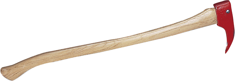

It's amazing what a Fiskars splitting axe will do with so little weight. It's a whole lot less work swinging a Fiskers as opposed to a sledge or a maul but I leave most of it up to my splitter. Cutting and splitting wood still adds up to work no matter what you have. Even using a chainsaw and splitter requires some work on your part.
One cheapie tool that took some of the backbreaking bending and stooping out of it for me was a simple pickaroon (hookaroon) so don't forget that some hand tools can still make a big difference, even with a splitter. 1482_75000_p1.jpg

Amen to to the hookeroon. I resisted buying one for years thinking $60 was too much for a simple "nail on a stick". I finally succumbed and my rear is still sore from kicking it because I waited so long. Anyone working around firewood and doesn't have one is handicapping themselves.
I went one better and built an 8' one out of a closet pole, a plumbing compression fitting and a piece of !/2" all thread. Haven't climbed into the bed of the pu since to unload.
