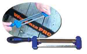

I've found good deals at this place, also look for the part called the scrench holder, it's a rubber piece that slips on the wrap around handle that holds the wrench/screwdriver for your saw, neat little apparatus. They have pro chain at a really good price also, cuts good, we'll see how it lasts, I'm really pleased so far. Attached is a file holder that is to file both the teeth and the drags at the same time.

If you purchase a depth gauge to fit your specific chain like our picture you will know when you need to file the raker's and by how much. I picked one up for my Stihl saw and it was only a couple of bucks.
We use a Oregon electric sharpener and it makes easy work out of sharpening chains.
