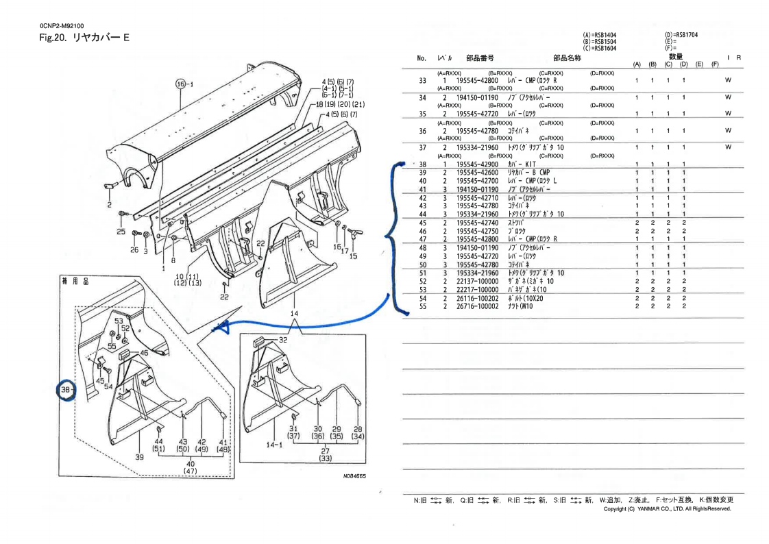

Tom,
Found a CLUE to the RSB1504 parts manual ... 0CNP2-M92100 Did a search and it turned up nothing.
This came off of a single page PDF document I had found.

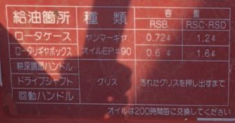

Found a RSB1504 unit on a Japan site. The stickers ...
+Left side+
Gear Oil to use EP-90
Change after every 200 hours of use.
Push the grease out the west side (west could be left side)
Amount values as shown on the sticker.

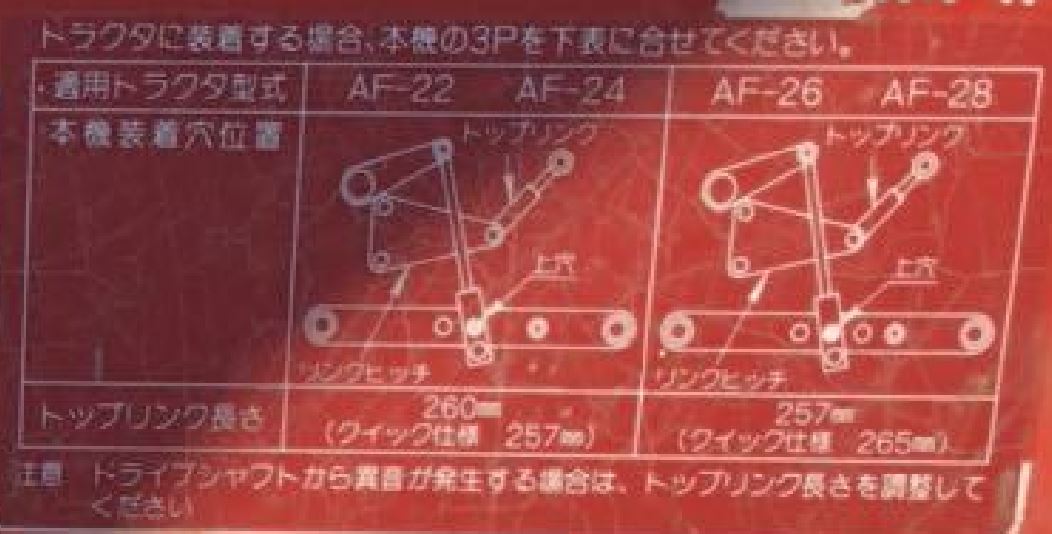

+Right side+
Match the 3PT link arms to the tractor model as shown.
(distance measurements did not translate)
If noise or vibration is being generated, adjust the top link.

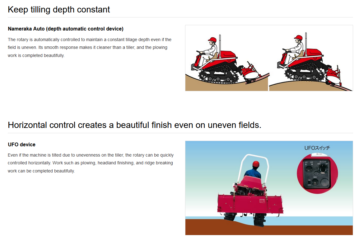

A few more clues on Yanmars and UFOs.
This is a sloppy google translation of a current Yanmar.com.jp web page.
The Yanmar UFO has electrical sensors, electrical piston motors, a control cable and an electrical control to do this work.
Prior to the UFO device, Yanmar and Deere machines had it all mechanically done with a term called, Draft Control.
The UFO gives so much more precision and 3-way axis draft control over the prior mechanical version of only 1-way axis control.
2 years ago, I thought I had saved a page from the Japan site with so much more in details, yet it got lost when the computer croaked.
