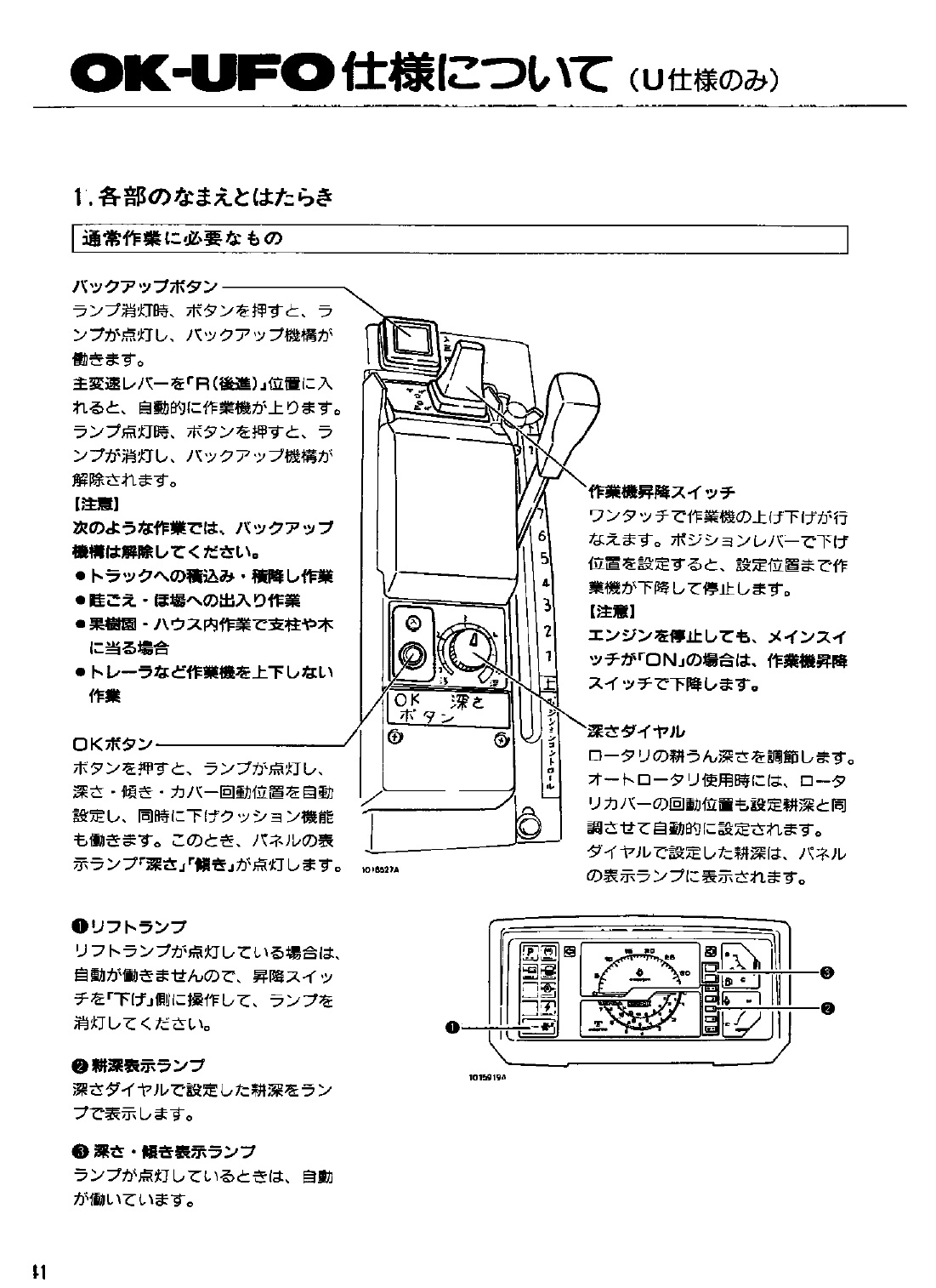

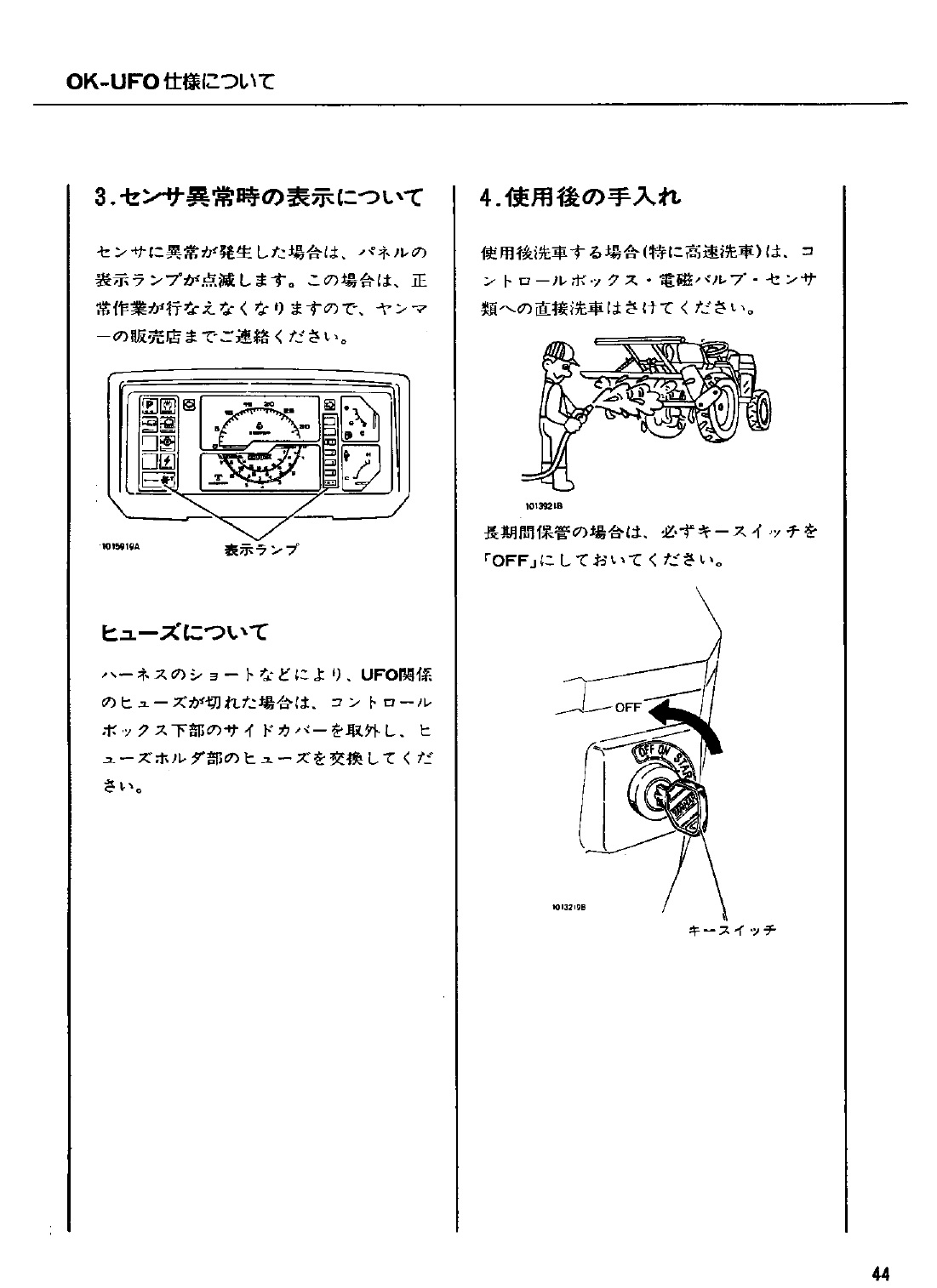

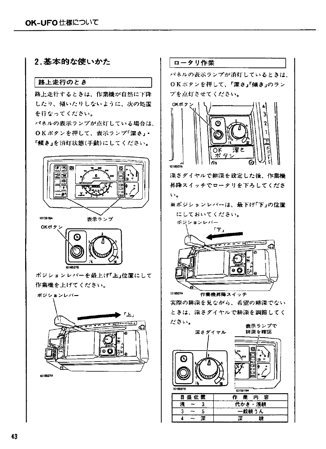

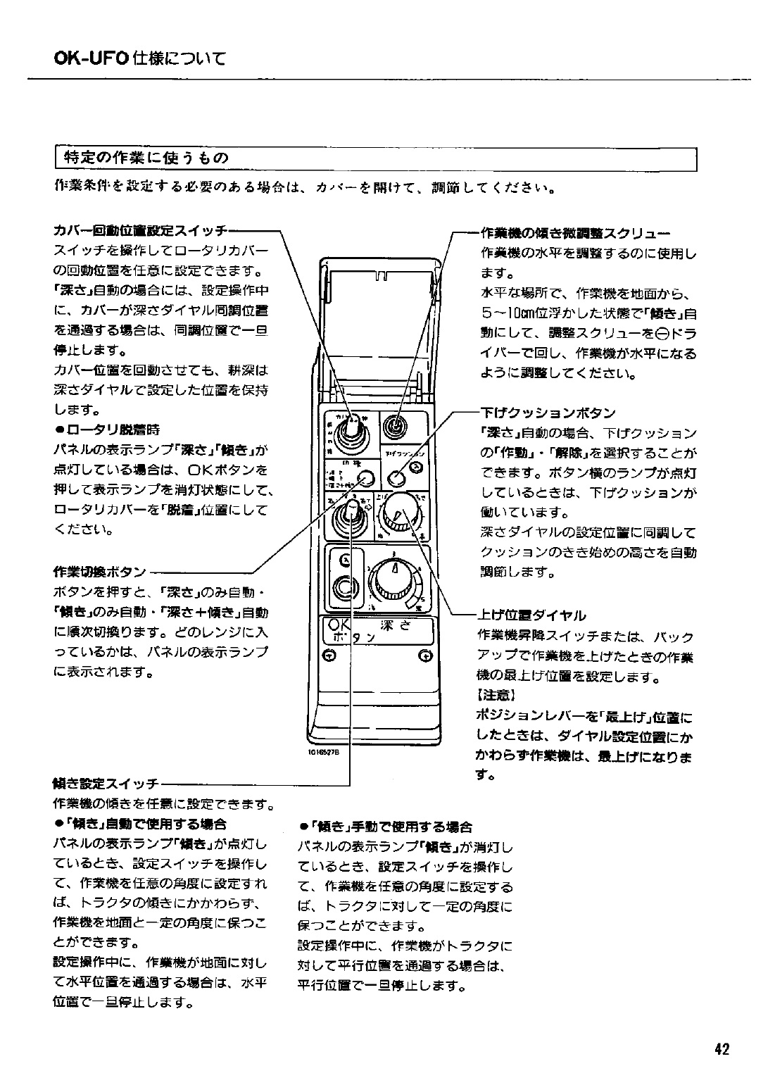

Hi,
Reading this tread really hopefully :). I have a FX235 and RSB1504 tiller. I'm so confused with the UFO. Please, can somebody expkain in english what all the buttons and knobs are. Also the 4 screws under a cover. The problem with the tiller is, that somebody has cutted the wires to those sensors located on the tiller, now trying to figure what wire goes to which pin on the tractor connector.

   / looking for Yanmar FX265 manuals / part list / exploded view / UFO manual #28
Hi,
Reading this tread really hopefully :). I have a FX235 and RSB1504 tiller. I'm so confused with the UFO. Please, can somebody explain in English what all the buttons and knobs are. Also the 4 screws under a cover. The problem with the tiller is, that somebody has cut the wires to those sensors located on the tiller, now trying to figure what wire goes to which pin on the tractor connector.
I've been holding off issuing the tiller manuals as the tractors are more important for people at the moment. What I'm attaching is the official Operations Manual for your tiller along with it's siblings. If you have questions, Nobody has yet reviewed this manual.

   / looking for Yanmar FX265 manuals / part list / exploded view / UFO manual #30
Hi,
Take these pages and upload to:
Translate an image
(Bing is best)
and then to
Translate text from photos from English and other languages – Yandex.Translate
Between those two sites, you should have a better understanding how the UFO works.
Sorry, I do not have any schematics for the tractor nor the tiller in question.
