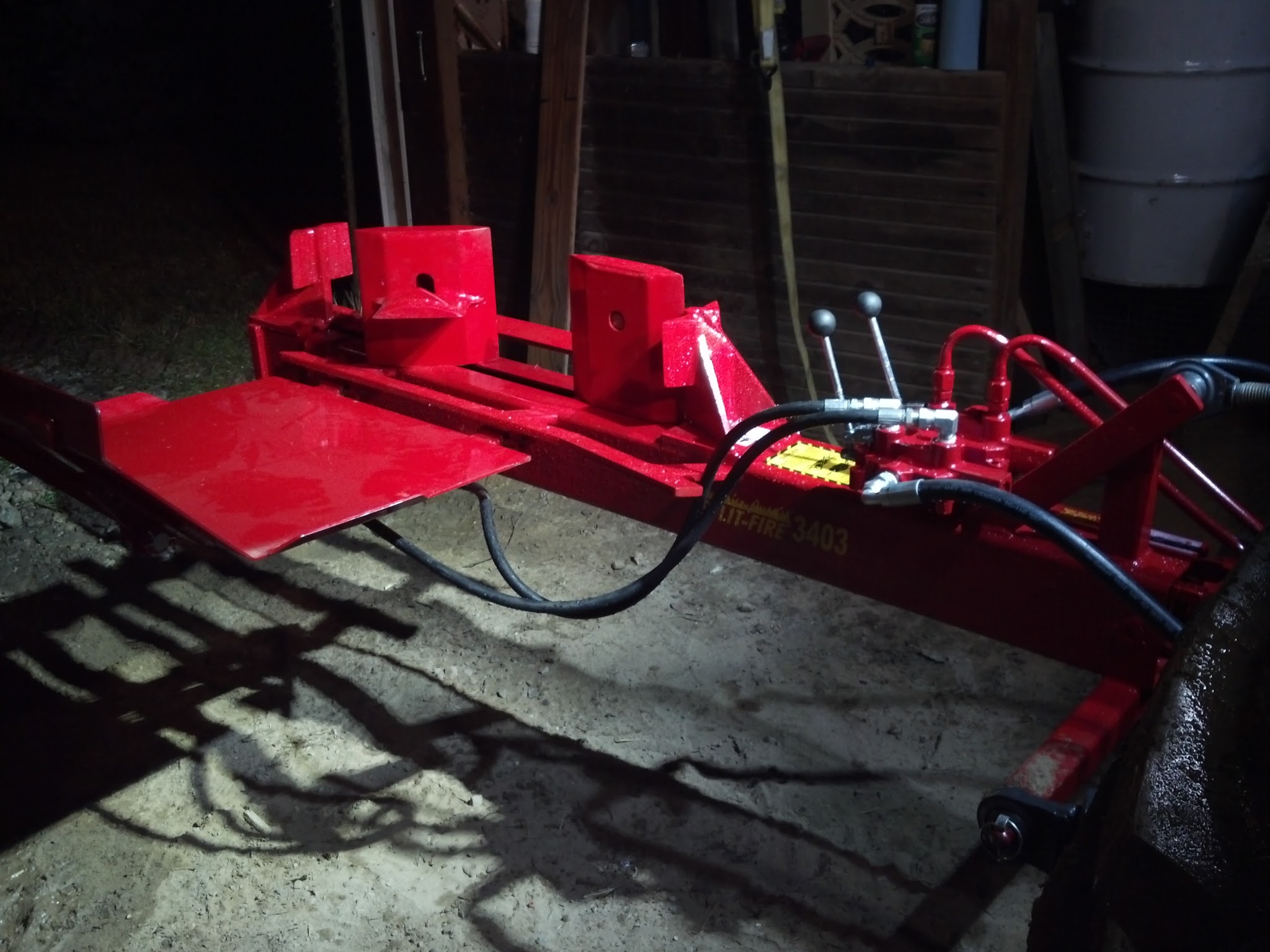

I was delighted to get the phone call today from my dealer telling me my custom Splitter had arrived. High flow hydraulics and log lift.

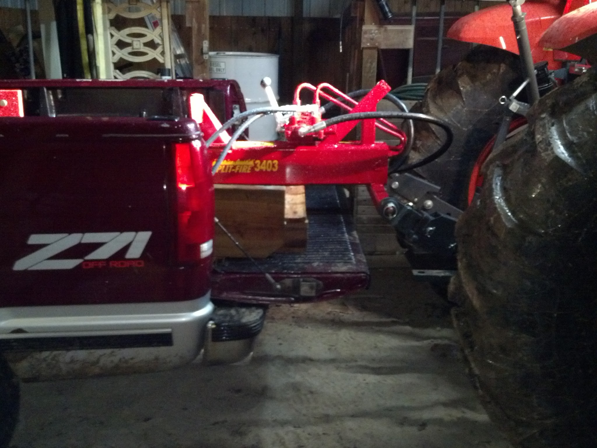

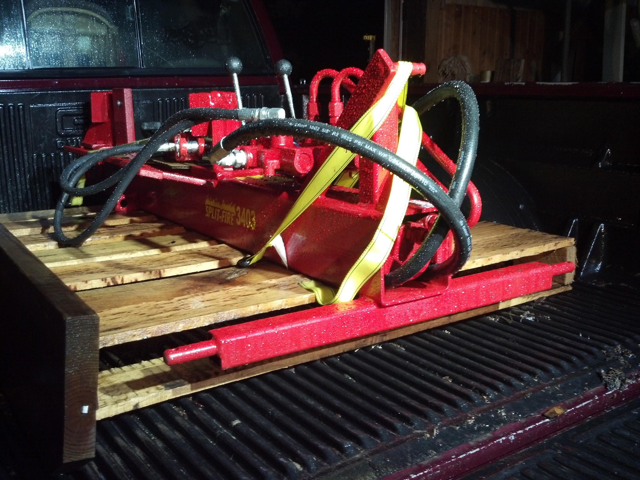

First task was to get it unloaded i was just about to swap my bucket out for my pallet forks, when i thought i wonder if my 3pt will go that high. Yep no problem getting it out of my Z71 :)
2012-12-20_17-22-29_545.jpg 2012-12-20_17-29-16_624.jpg 2012-12-20_17-35-43_704.jpg
Got the fittings, log lift attached, and lines bled. At 2100 Rpm it cycles in about 4 seconds. Log lift is kind of scary as it raises in about a second even throttling the valve. Hopefully its not like a catapult when loaded. The thing i really liked about this design is that it splits on every stroke.
I can't wait to try it out Tomorrow if the rain stops. I'll post a video of it in action later.
Note: Between about 1900 -2100 rpm the engine is most efficient according to the engine brake specific fuel consumption charts kubota supplies meaning the engine uses less fuel per the required HP than it would at say 1500 rpm.

This thing is awesome I took it over to my buddies today and we split about 1.5 face cords in just over 30 minutes. most of it was 8-12" Piston your right the 4 way splits easy 2-3 times the speed of either his old homemade 3 pt or the speed pro kinetic splitter i took back too TSC. Some say that they don't like that this style because it doesn't push the wood off but this has never bothered me since i don't have a conveyor to take away the wood and just letting it pile up at the end of the splitter only works for a short period of time so we have always thrown it into a pile near where it will get stacked. The other thing that makes this nice is since it doesn't push it off if you need to re split it you don't have to play go fetch. you just scoot it over to the other side and recommence splitting. Most of the wood we have been splitting for the last 3 years is 16"-25" dead Ash trees that are 60 plus feet tall
If i could do one thing different I would have ordered the 30" Stroke model that way i could always have enough room to roll another log into the splitter on the back stroke. we cut everything to 16" and if one is just a little long on the 24" model you have to clear the wood from the other end before splitting the next piece. Not a big deal if its just one person but if you have someone else helping this waste some time.
The log lift might not be totally necessary but it is awesome and in my opinion totally worth it for the following reasons.
1. Because I have Category 2 only which has different toplink spacing than normal compacts I can only lower this thing to about a foot and half off the ground without removing the PTO shaft guard which i'm not going to do. The Top Link crashes into it if i use the middle or upper toplink holes on the tractor the splitter points to the ground even worse than it does when i use the lowest position. I could never roll logs onto the splitter.
2. I have lifted 30" Maple rounds and it doesn't even flinch. "even if i could lift these my back thanks me"
3. When splitting smaller rounds up to 12" or so you can put several pieces of wood on the lift if you leave it extend and makes a great production table. Great if working alone or with help.

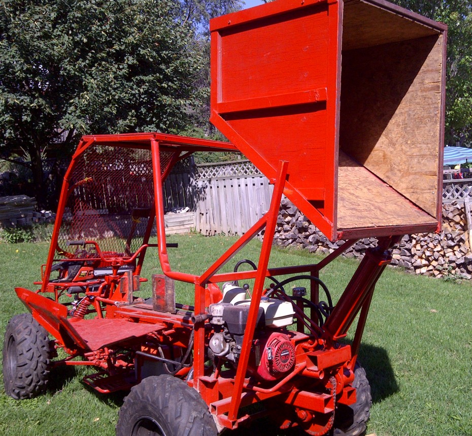

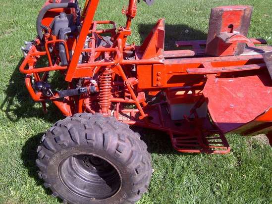

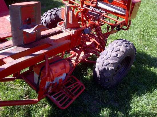

It IS very interesting indeed. Just for the record, it is not mine. A guy in Canada was selling it on another forum and posted many pics of it. I think he wanted 5k for it, which really wasn't all that bad. It was the high end model self contained split fire, which is close to 5k itself. The splitter "drove" on it's own using a hydraulic motor for the wheels. It was a pretty neat idea, but in practice I could see it being a hassle.
